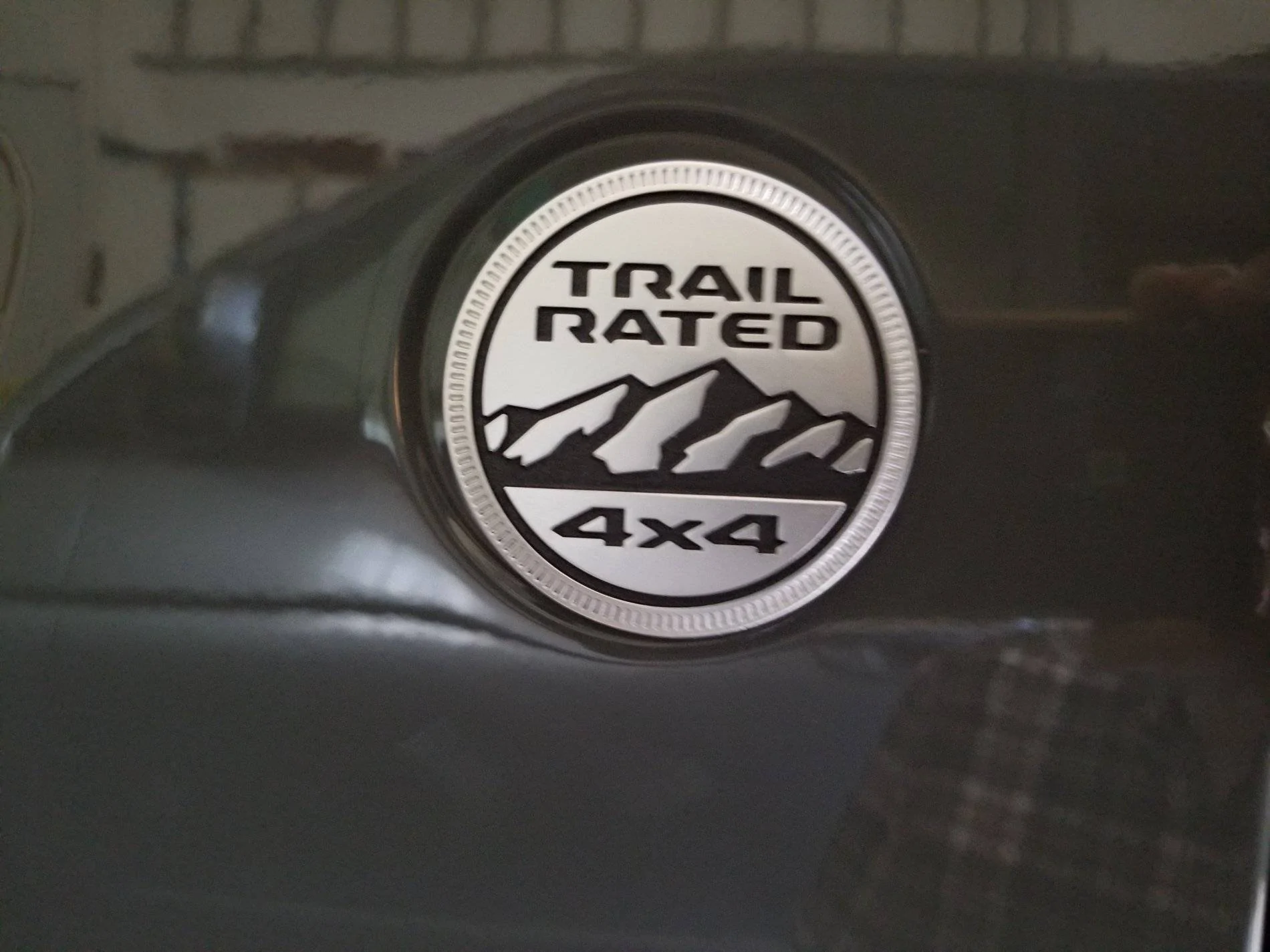

My Trail Rated badge is crooked and my OCD is in overdrive. Do you think I can heat it with a hairdryer and "shift" it back into place? Any other suggestion? Thanks!
Your best bet is to heat it and use fishing line to remove it. Remove all residue and then use new 3m automotive double sided tape to adhere it properly

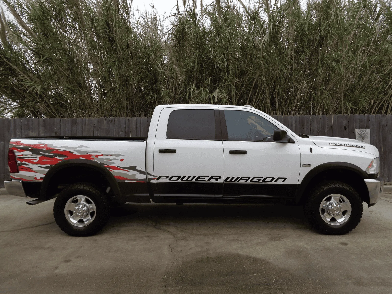

That's the key, doing it early when you get the vehicle. De-badging my truck was a nightmare. You can order the powerwagon w/o decals but not the deal I got on it.

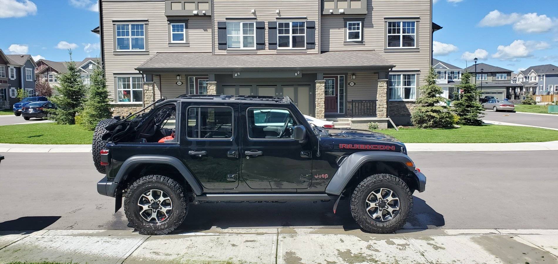

I had the body shop pull my rubicon hood stickers when it was in for something unrelated to the front end. Love the cleaner line without the decals and I never liked the look of
Jeep Wrangler JL Debadging Problem 31A59E9D-4E65-4FE6-AA14-5ACE2E22621B
red on Snazberry. Tow hooks are getting painted black next and I have the dark saddle interior, slowly eradicating the rubicon red.

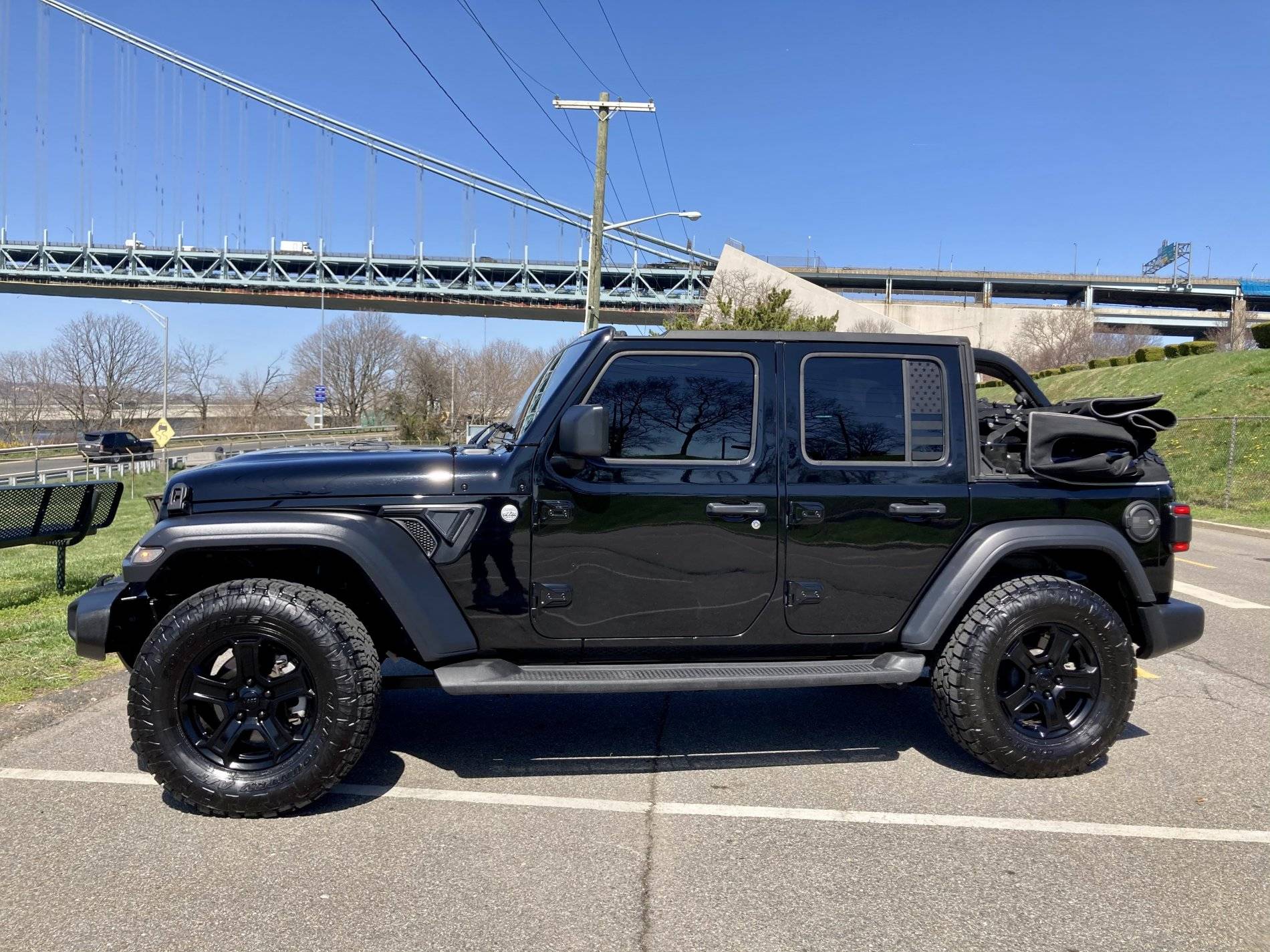

One of the first things I did was remove the “wrangler unlimited” stickers. The rest look fine IMO.
