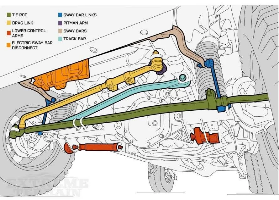

Im still a Jeep newbie so please forgive if this is a stupid question. Last weekend, I almost got rear-ended by RV because my Jeep did the "death wobble" on the Highway. I took it to a local mechanic who said it needed:
  • Tie Rod
  • Drag Link Inner
  • Steering Drag Link
  • Square Neck
  • CLAMP
  • TIe Rod Adjusting Sleeve
Total cost including labor was $1859
I guess my question is, does this seem like a decent price? i saw a YouTube video on the replacement, and it said it was about a 2-3 hour job. Meanwhile, i have a mechanic friend who said if I bought the parts, he would install them for a case of beer. So my second question is if i buy the parts, does anyone have suggestions for what mfg to get? OEM?
Rant: every one i spoke to said its very common on wrangler to do death wobble, if its so common why isnt it considered a design flaw and Jeep come up with a fix for it?
Edit: I need to mention i dont offroad with it, so i dont need some rugged stuff.
Thanks for any assistance

Here is a video on what could cause a death wobble and how too assess what needs tightened or replaced.
Also would be a good idea to find where these parts hes talking about are located and watch some videos to learn how to assess if you do infact need replacement.
What’s interesting is that toe-out seems to be a common solution, but lifted jeeps become more sensitive to toe, likely because they need more caster. My low-mileage jl immediately got DW with the mopar lift. I found it was toe’d in more than spec, even with the longer mopar lower arm. The camber correction brackets are another silver bullet to “lift-induced” DW issue, solving it through more caster.
