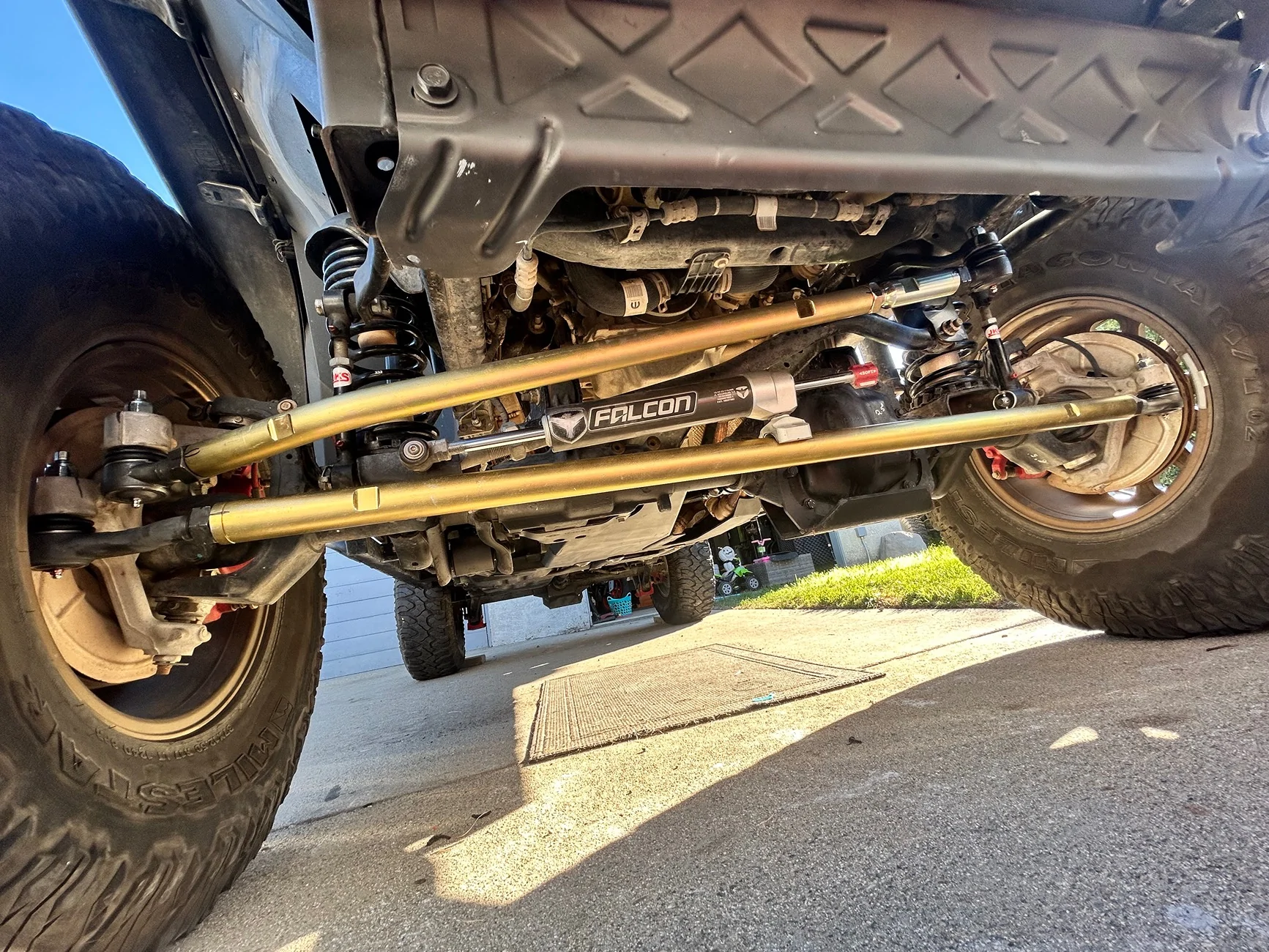

lets start with how many miles on your jeep. D W can be caused by a lot of different things. anything from tierod and rag link joints failing to bad alignment to bad caster angle. I just put on both tierod and draglink 1 ton setup from metal cloak for 750-800 bucks for parts and shipping. hardest part was getting the stock Pitman arm ball joint to break loose. took about 2 hours in total. Thus the stuck ball joint is was took most of the time. ( yes i know the stabilizer isn't bolted in place. as i took it to have it rebuilt and the bracket changed to the bigger sized tie-rod

If you arent planning on off roading and got 6 years out of what you have now just get factory style replacement parts and add ball joints. No reason to spend a bunch of money on performance parts when stock style replacement ones will get you another 6 years likely.
good theory but the cost of the stock parts vs a 1 ton aftermarket setup is pennys on the dollar for longer longevity
