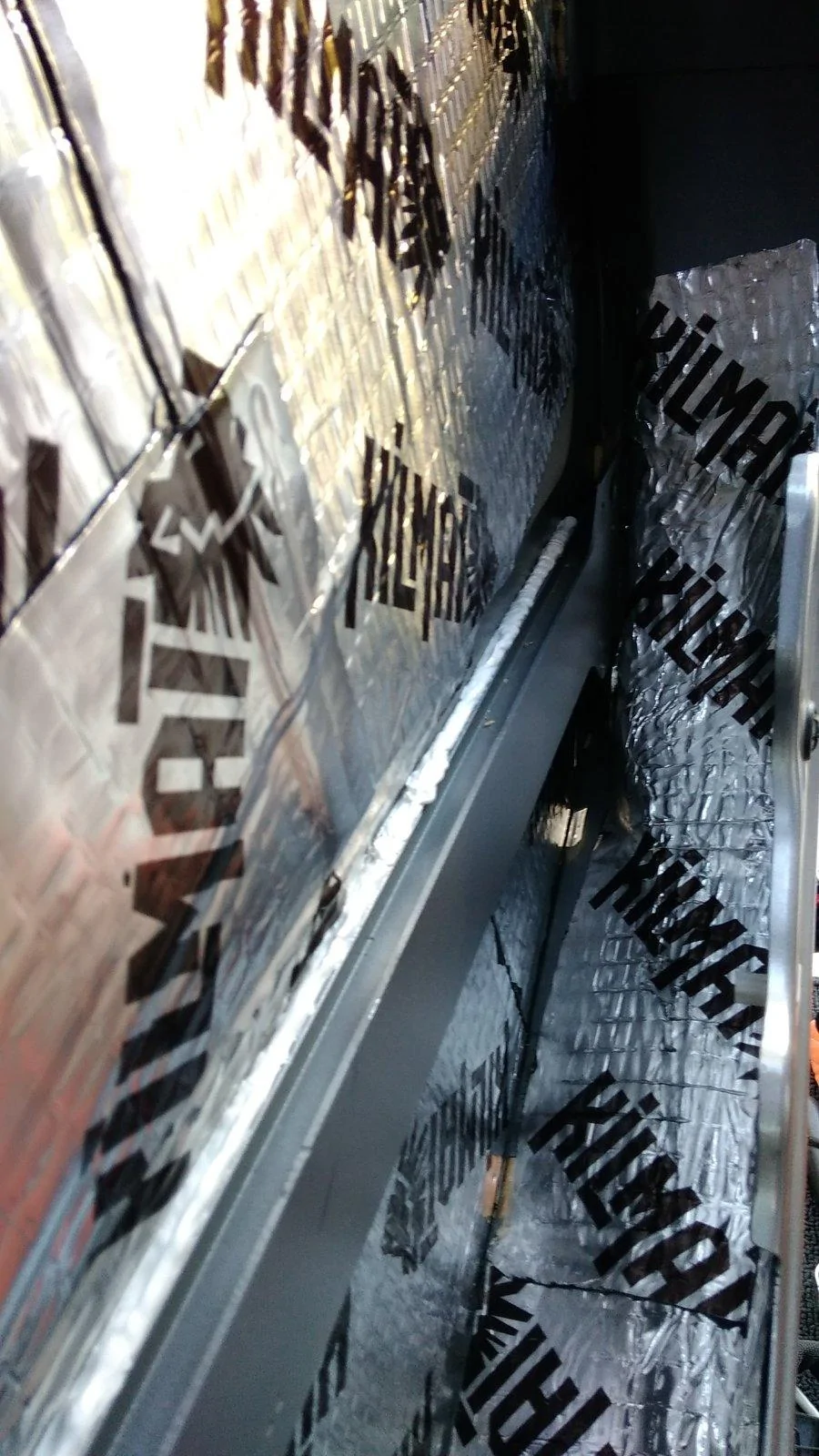

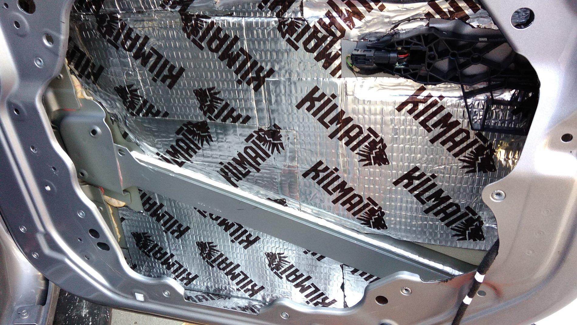

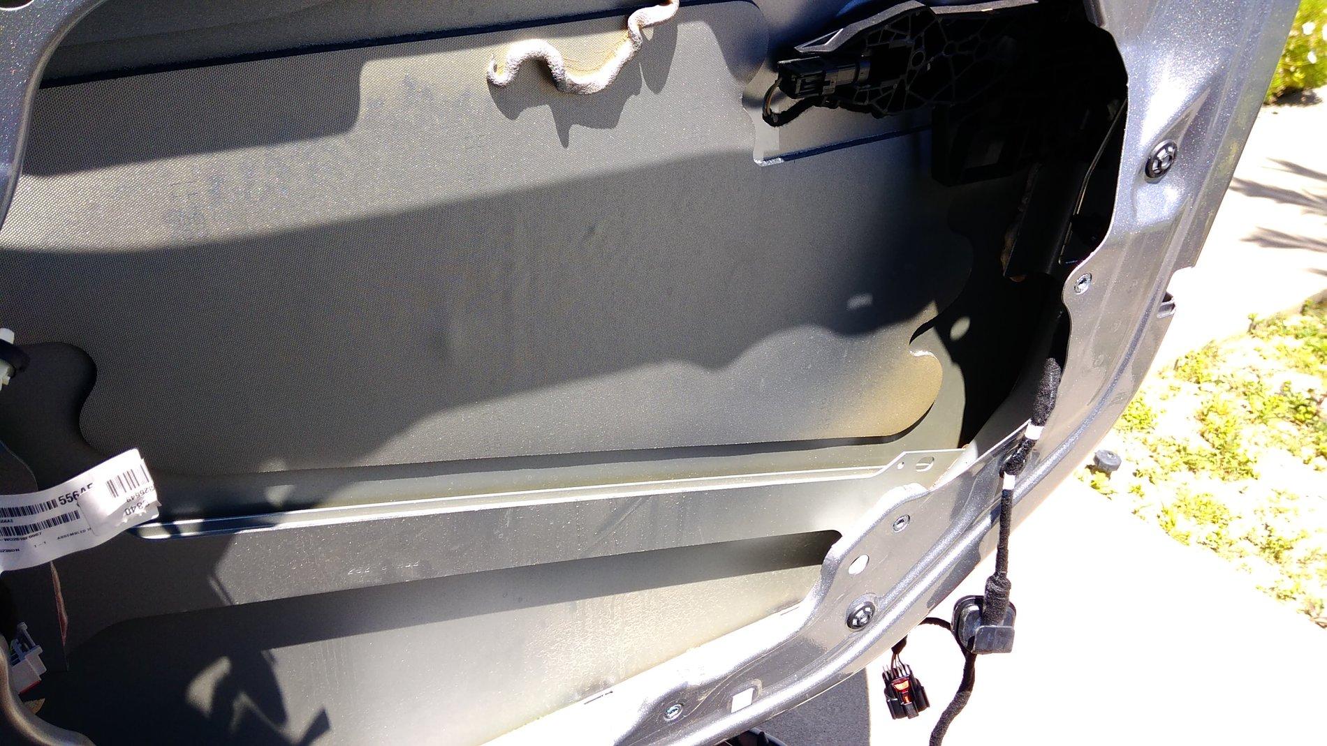

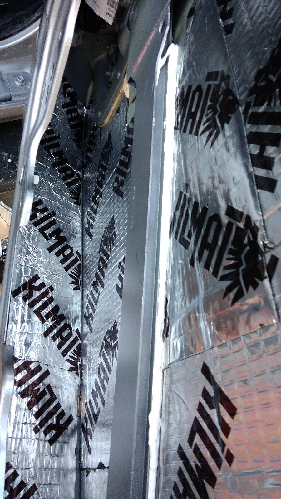

Today, I started installing my sound proofing. I started with the passenger front door. I removed the decorative interior panel. Then there's a plastic panel that holds the window motor and regulator and door latch/lock system. I removed the window completely and stripped the door down to access the interior of the door freely. Lots of parts, but nothing too serious. There's a sequence to removing the window that you have to do, but it's all very straight forward.
I put Kilmat 80 on the door skin and used Kilmat 50 on the metal that is on the interior side of the vehicle, placing the sound proofing on the interior of the door. I got the door reassembled, except for the interior trim panel, which I left off so I can add a sound absorbing foam to its enclosed side. While I was in there, I ran a bead of silicone between the door beam and the skin. I used a silicone that specifically allows a lot of movement.

Today, I started installing my sound proofing. I started with the passenger front door. I removed the decorative interior panel. Then there's a plastic panel that holds the window motor and regulator and door latch/lock system. I removed the window completely and stripped the door down to access the interior of the door freely. Lots of parts, but nothing too serious. There's a sequece to removing the window that you have to do, but it's all very straight forward.
Just closing the door or tapping the exterior skin has a much more solid sound. Once I get the driver door completed I'll make another meter test to compare to baseline. My intent is to do all the doors this way, then the tub and something for the roof.
Did you notice the sound deadening pad glued to the inside of the door skin? Any pictures of that by any chance?
Look at the very first picture. The area above the door beam is covered in a hard pad about 3/16" thick. It covers most of the area above the beam. I was actually surprised it was so large. It's one reason why our JLs are so much quieter than the JK. At first, I wasn't sure I was going to cover it with additional material. So, I started covering the area below the beam. The more I thought about it, I just went ahead and covered over it. Glad I did. That material is hard and it now has a definite change in the frequency when you tap the center of this area compared to the door not yet covered.
I was not sure what I was looking at in the first pic initially. Is that pad glued directly to the inside of the door skin? It's a lot larger then what I was expecting. I wonder if there s another pad behind the one that shows in your first pic? I was told the pad was about 14" x 10". The insulating pad is supposedly the reason for the door waves or warps. It shrinks or expands/contracts differently then the aluminum skin when they bake the paint. That's what I was told by someone.
