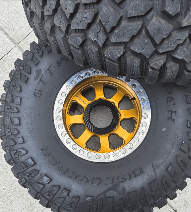

For all of you guys running a 37"+ tire on a D30, this will give you some perspective on the borrowed time you currently possess. Lol.
If the ring is smaller than the bolt pattern, one must resist going above a 37". (This really should be 33".)
For reference, Yukon doesn't recommend anything larger than a 37" for D60's.
Pic below are Pain Train’s 40's showing the D30 ring out of a Sahara I regeared last weekend.

So…38’s on a 44 is borrowed time? ?
Yeah.
I'm not sure where everyone gets their axle size and tire size idealogy from. Lol.
A 38" tire is huge and too large for the D44 pinion cross section, let alone the amount of flex the housing goes through.
Basically, anything about above a 35" on a D44 is pushing it. The MFG knows this, of course, which is why a lot of warranty claims are turned down for drivetrain stress.

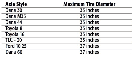

That's a conservative recommendation. Lockers can potentially double the strain on the R&P. It's generally recognized the rear axle needs to be stronger than the front because when climbing, there's more weight and strain on the rear. I think the Dynatrac XD60/XD80 goes a bit too far. A 60/70 or better yet a Jana 76/80 would be more balanced.
I think those numbers are why Jeep doesn't sell anything with 37's, they don't want to step up to bigger axles. The Bronco Raptor has 37's with a D50 in the rear, but not in the front.
Experience has shown if you avoid shock loads, a D44 with lockers can crawl with 37's. There are many D60's on 40's that do more than crawl successfully.
I've got the Dynatrac XD60/XD80 on my Juggy and I bounce it pretty hard on sticky 43's. So far I've only busted the front hubs, which I replaced with Yukon drive flanges.
I crawl pretty aggressively in my JLR on 38's and I don't consider my time limited, as long as I don't bounce it. I'm far more concerned about long recoveries on 4+ trails of dead rigs than crawling.

If you dont jump and be very conservative on throttle control and turning your front.. you can wheel a Front M186 on 35s with a stout locker (like ARB) for a long time.. yep there is a chance it will eventually give up but thats the same case with 37s and M210s

I watched my buddy in his JLS on 35's with the front wheel turned and a slight hop break the front axle u-joint, the same u-joints my JLR uses. I went home and ordered RCV's.
That's key, crawling, no bumping or bouncing.
