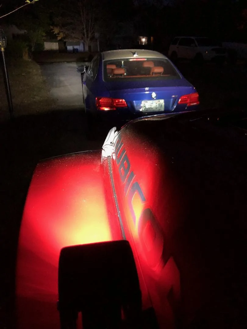

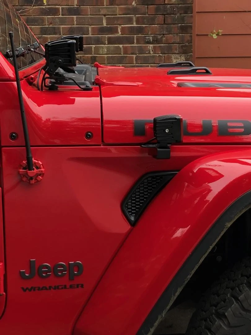

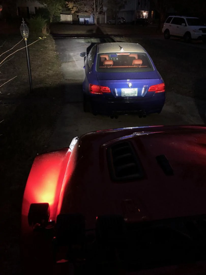

I'm running an Inspired Engineering 6-Cube Red Series (spot)... here's what it looks like in the cold, dark night. The cube is mounted as far left as it can go. My M3's a bit dusty... don't judge me. ;)

Looks like the Ace mount places the cube the lowest of all the over the hood mounts. The Rough Country mount only raises it an 1/8" of so more, but moves it off to the side. The KC mount kicks the light up an inch or so and moves it off to the side like the Rough Country mount ... it's also a very sturdy mount which should not have vibration problems. The GoRhino single mount looks like it might kick it up a inch and a half or so ... but, again moves it off to the side. Very sturdy looking mount. Light on the hood from the GoRhino mount isn't that bad ... still, more than the Rough Country mount, which doesn't make sense unless you've got your lights aimed downward more.

Your pics show the top of the fender and the side of the hood lit up quite a bit from the side mounted light. Was that your impression in person? Those brackets look like they would be great with the cube (fog pattern) aimed outward at a 45 angle to increase side and cornering visibility.

I may have the lights angled slightly downward...I've been adjusting to find the right angle so I don't blind oncoming drivers before I can hit the switch off. The fender mount is lighting up the side of the hood...It's a spot and I plan to adjust the angle a bit, but I'm not sure it's the right pattern. don't need them facing forward since I have the Rigids up top. If it weren't raining down here that would've been my project for today.

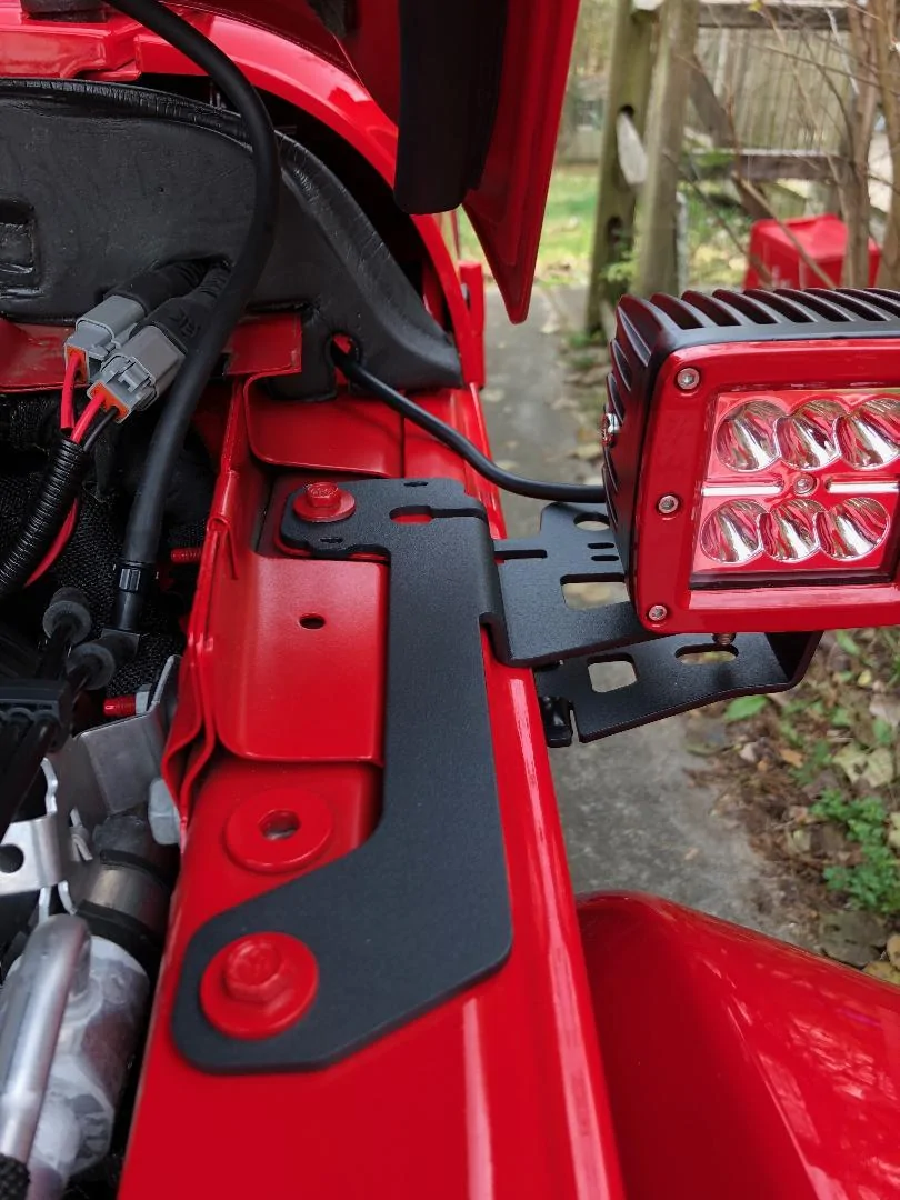

Here's a cleaner install of the @Maximus-3 mounting bracket, with the wire tucked away. Looks much better with much less exposed wire.
