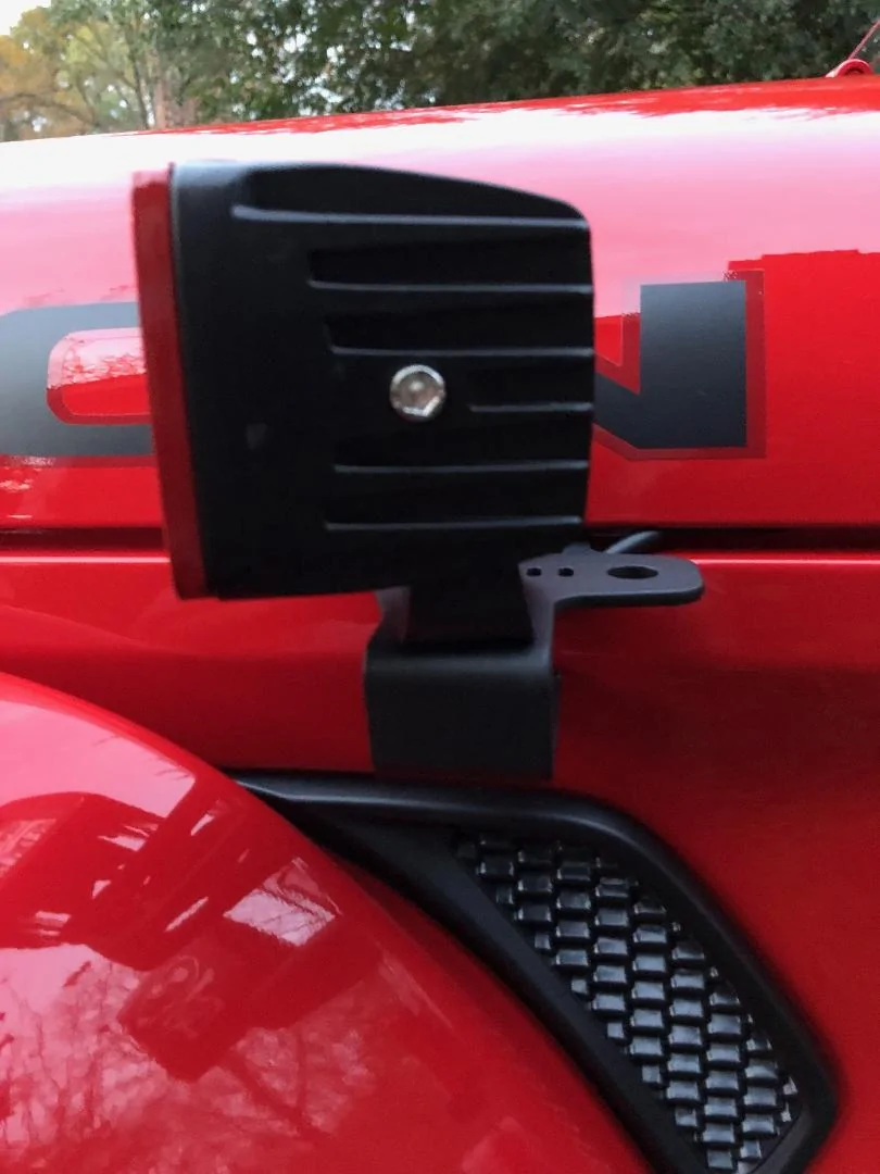

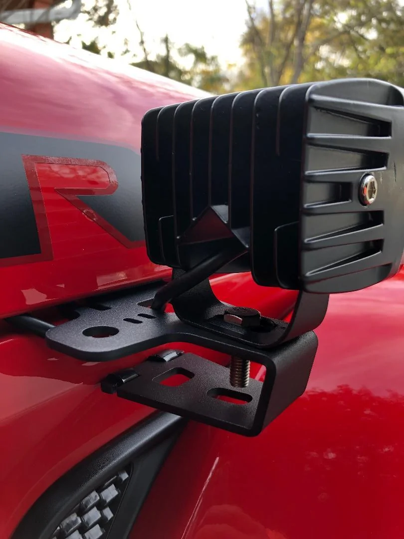

Here's a cleaner install of the @Maximus-3 mounting bracket, with the wire tucked away. Looks much better with much less exposed wire.
These are great.

thank you...I like where they sit. I'm gonna have a difficult decision to make if/when Rigid puts out a newer model of their dual A-pillar mount. First-world problems, huh...

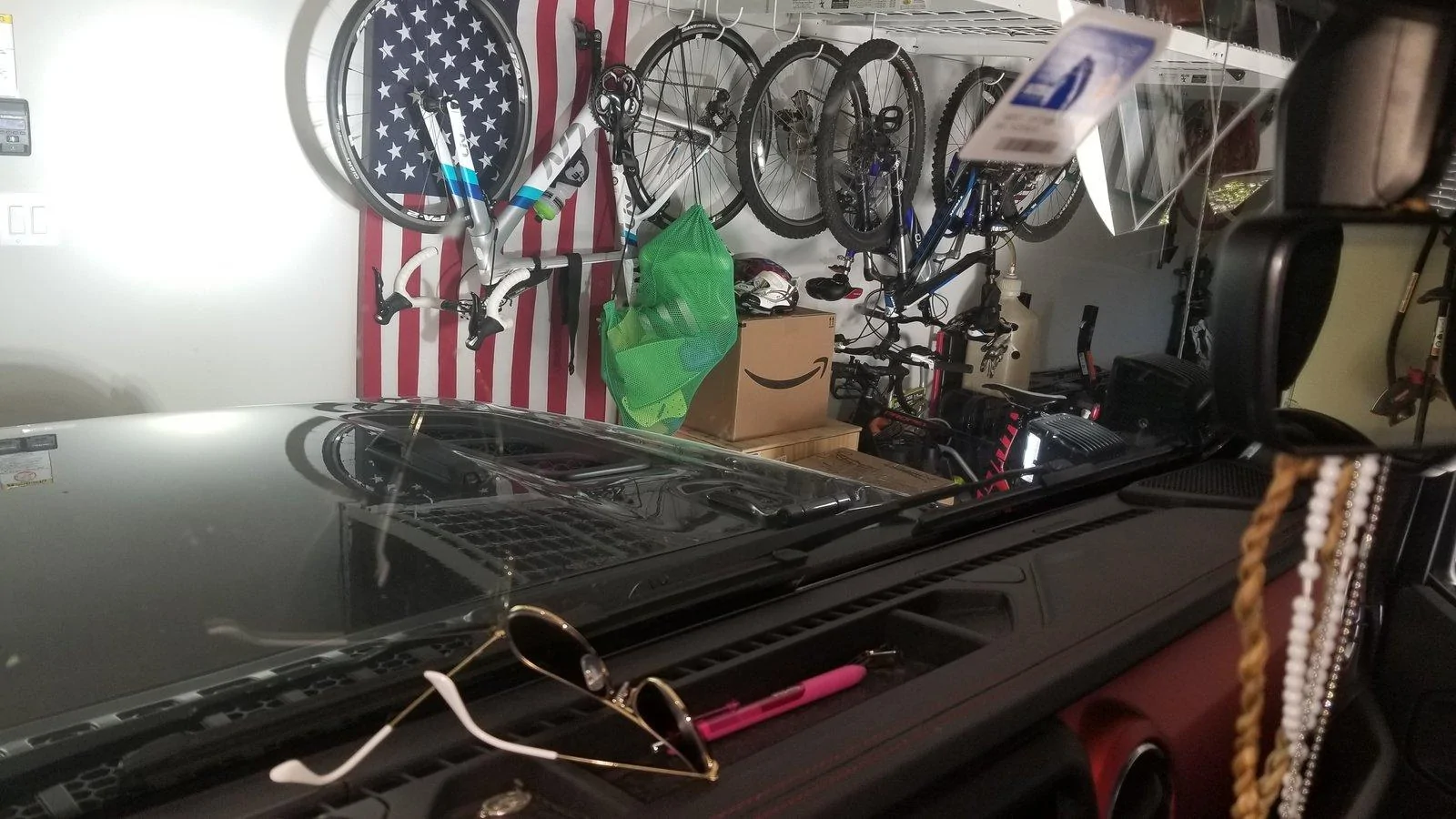

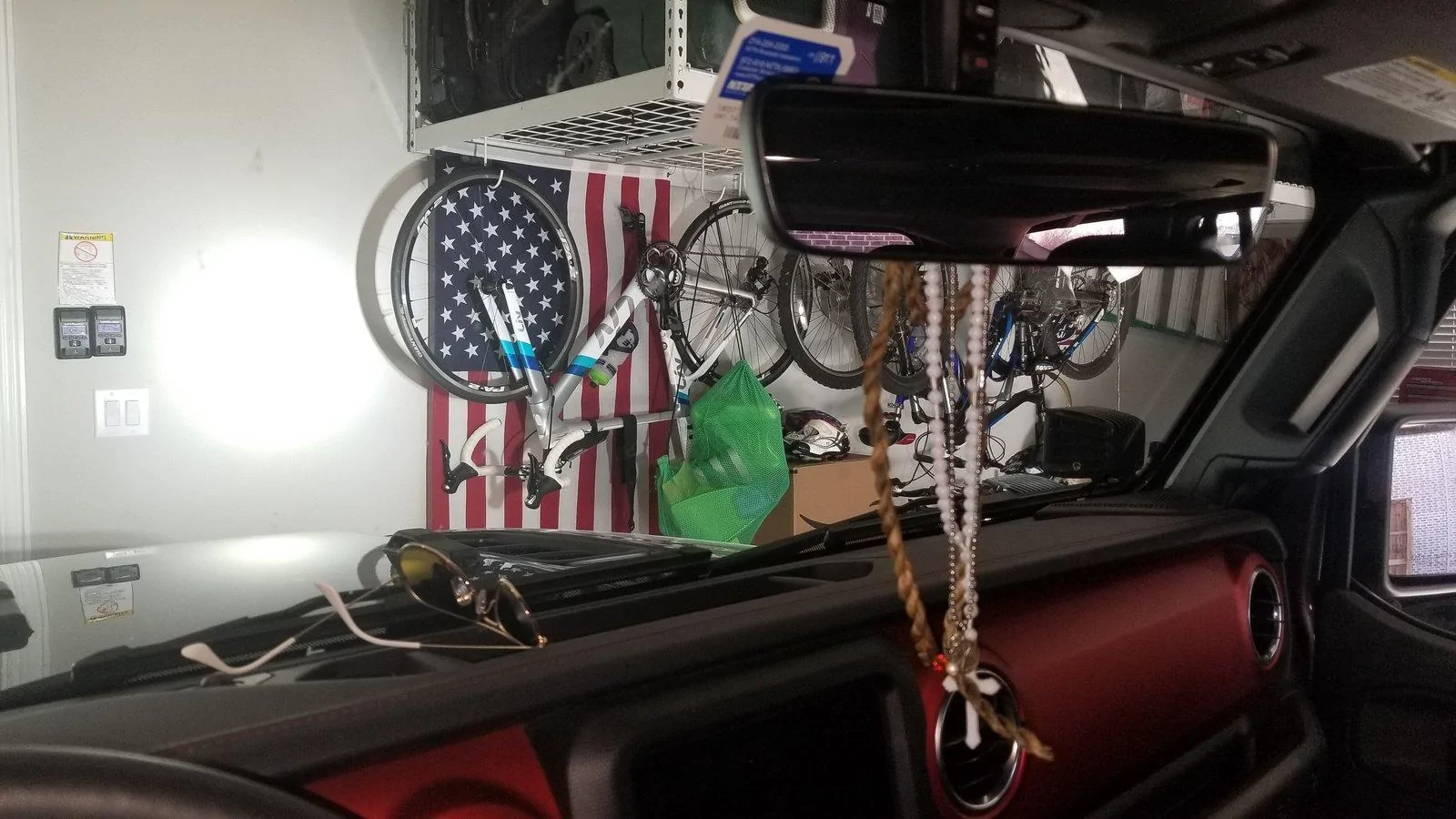

Sorry the pics are not at night but you get the point. There really is no light bleed from the lower lights with the Artec Mount and Rigid side shooter flood lights. The top lights are Rigid spots and have no bleed.
The top pic is at eye level the bottom pic is holding my phone up by the visor pointing down toward the light. I am sure if the side shooters were on the top block I MIGHT have some bleed over but it looks minimal.
Thank you for the feedback. Your lights are working just like mine ... some of the main light is reflect back down the inner side and leaks out. With the side shooter cubes in the bottom position, it doesn't look like it would bother you. I used the KC Hilites pillar bracket and, unfortunately, the cube sits high enough that it's distracting to me. @AFfiredawg is using the same bracket as you are, but I suspect, based on his picture, that he has the side shooters mounted in the top position. You've given him a fix if the spillover bothers him ... just reverse the position of the cubes on his bracket.
Visited the Rigid factory yesterday and talked with one of their reps. He determined that there was nothing wrong with the lights, nor with their mounting. He had a set of D-SS fogs installed on his company Tacoma that also had some spillover visible from the driver's seat. Said they never bothered him ... until I pointed it out ... now it probably will. Rigid introduced the side shooter lights about three years ago and there hasn't been any/many complaints. But, they did up the lumens not too long ago and that might change the equation.
I like the side shooter cubes. They are fantastic on a twisting trail. I don't want to give them up.
