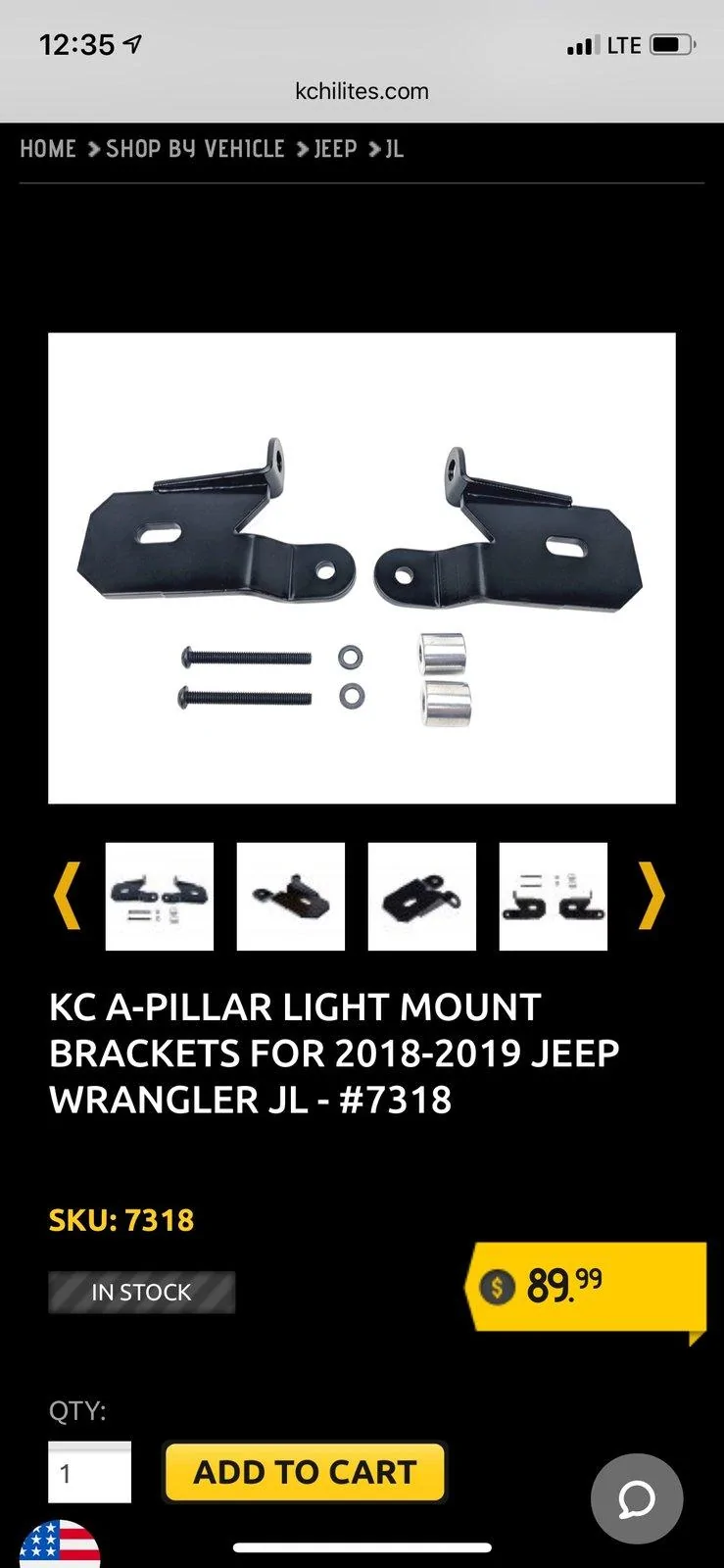

This is going to be my setup...so these mounts work fine with the rigid d-ss pro cubes...I bought the rigid's but the mount doesn't work, as you know..and I found out!!
I have the Rigid dualie fogs and they work great on this mount.This is going to be my setup...so these mounts work fine with the rigid d-ss pro cubes...I bought the rigid's but the mount doesn't work, as you know..and I found out!!![]()
