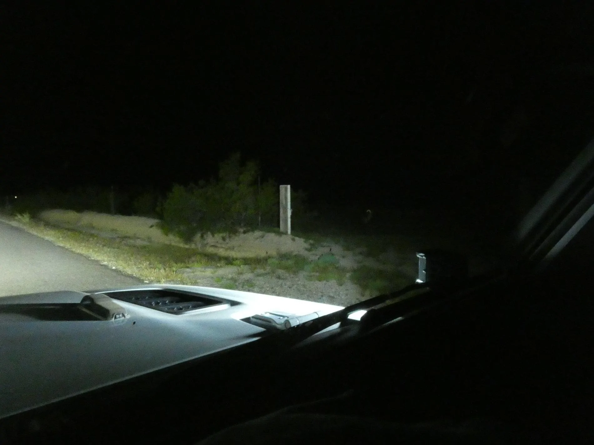

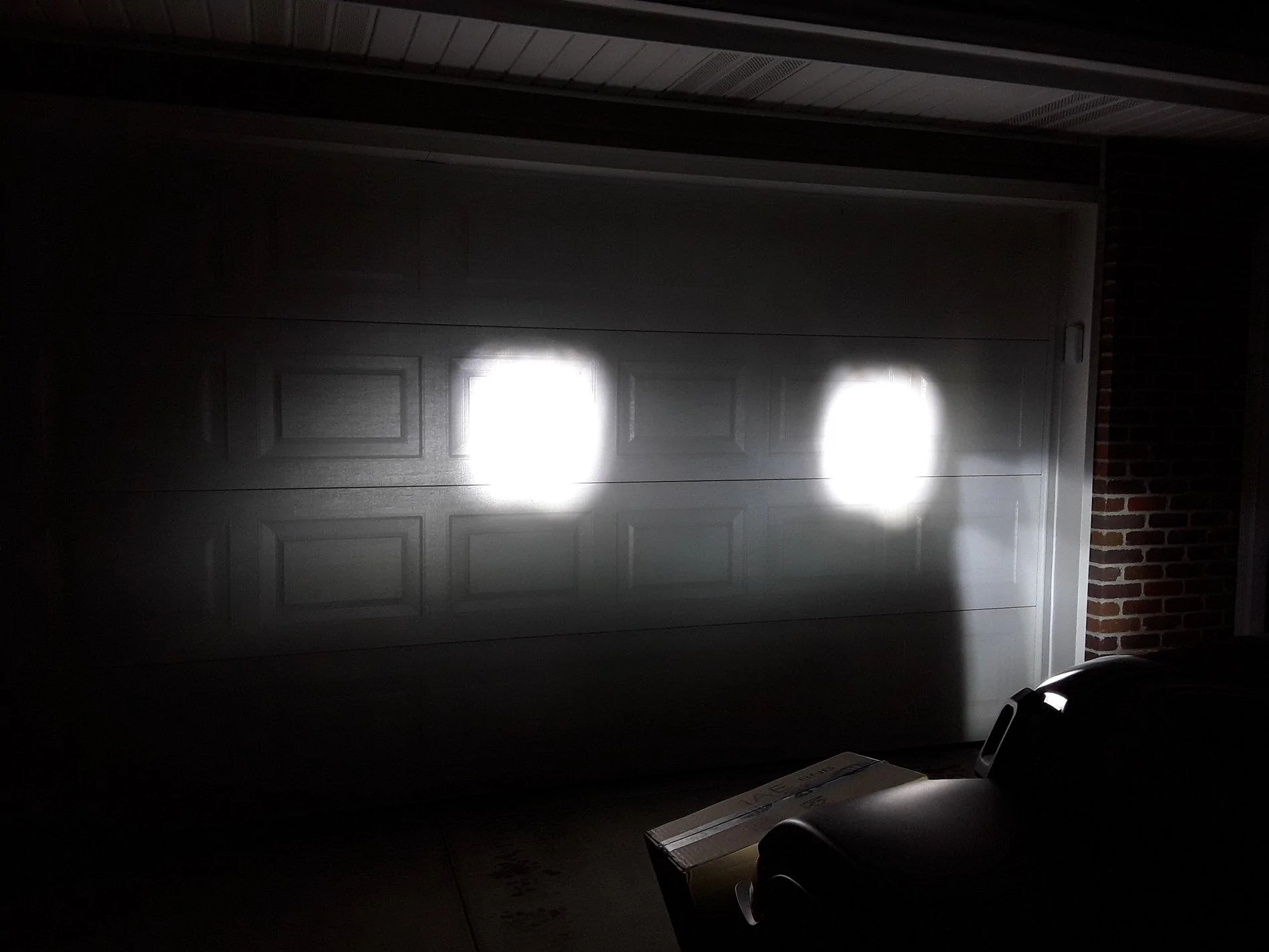

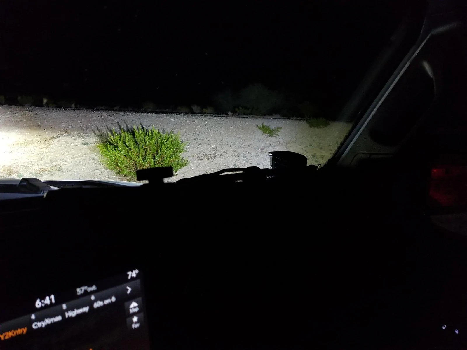

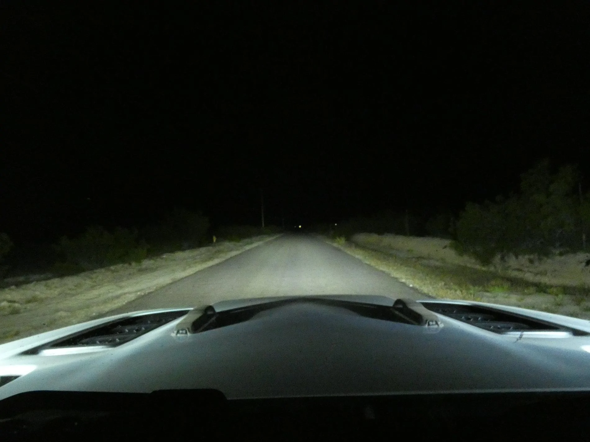

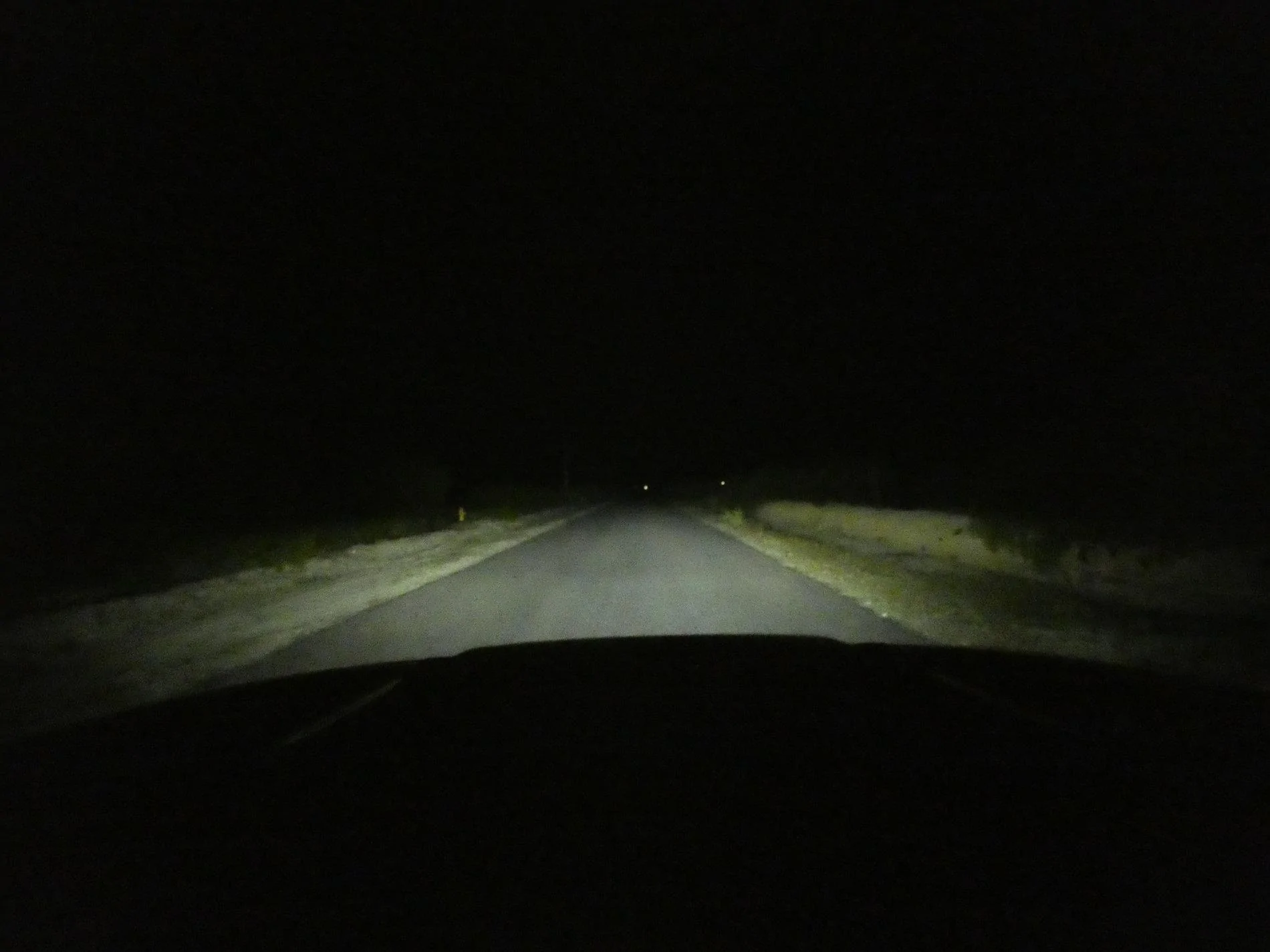

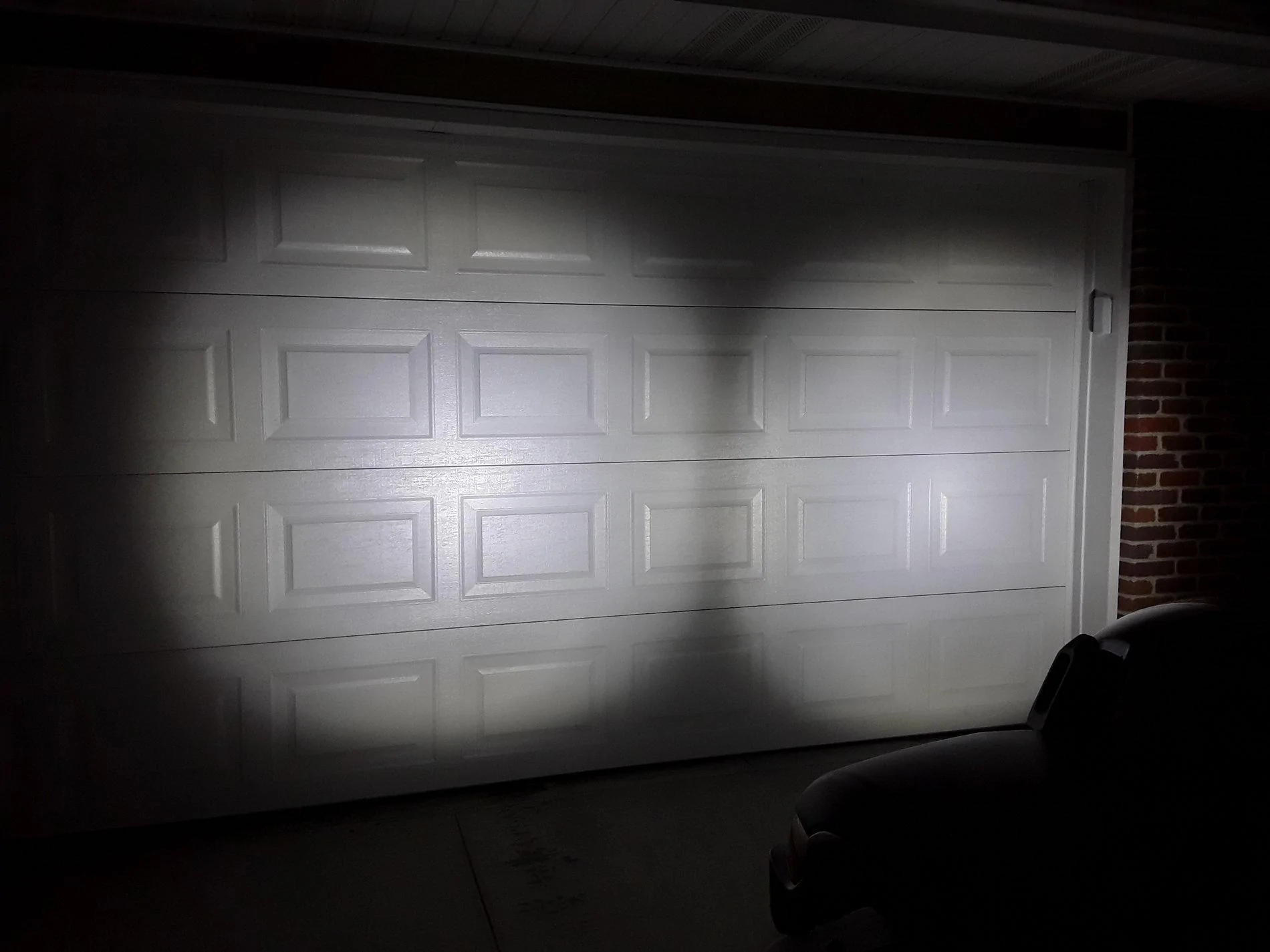

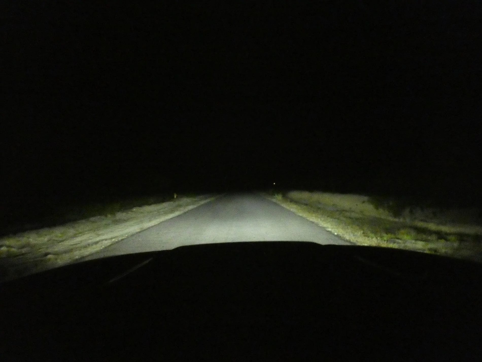

Rigid D-SS on the A pillars. I have mine aimed parallel to the path of the Jeep laterally, and have the base of the beam sit on the top of the low beam pattern. I run them with the low beams and fogs on, as they scatter light in the immediate area in front of the Jeep, where the rigids wind up where the factory high beams are aimed, but far more intense and taller.
