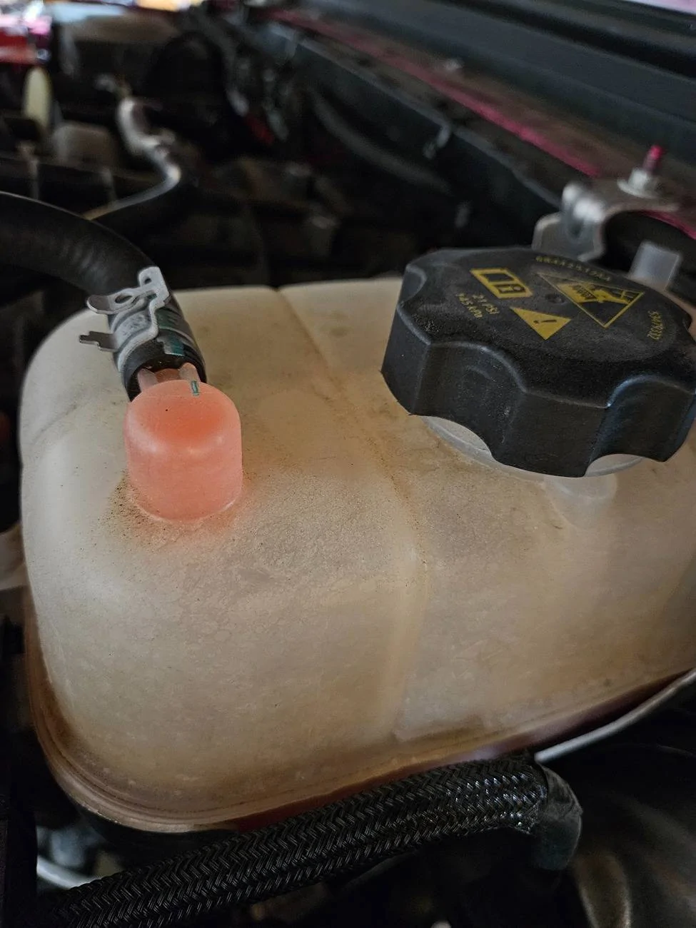

Well I called the dealer the purple blue colored is HOAT for battery pack cooling and the engine is OAT is the yellow orange colored. This is on a 2022 with the 3.6 e torque.

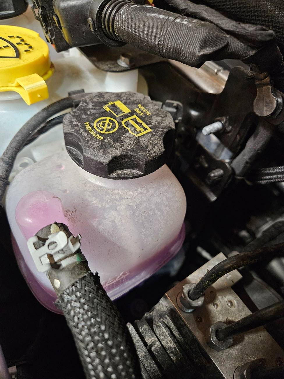

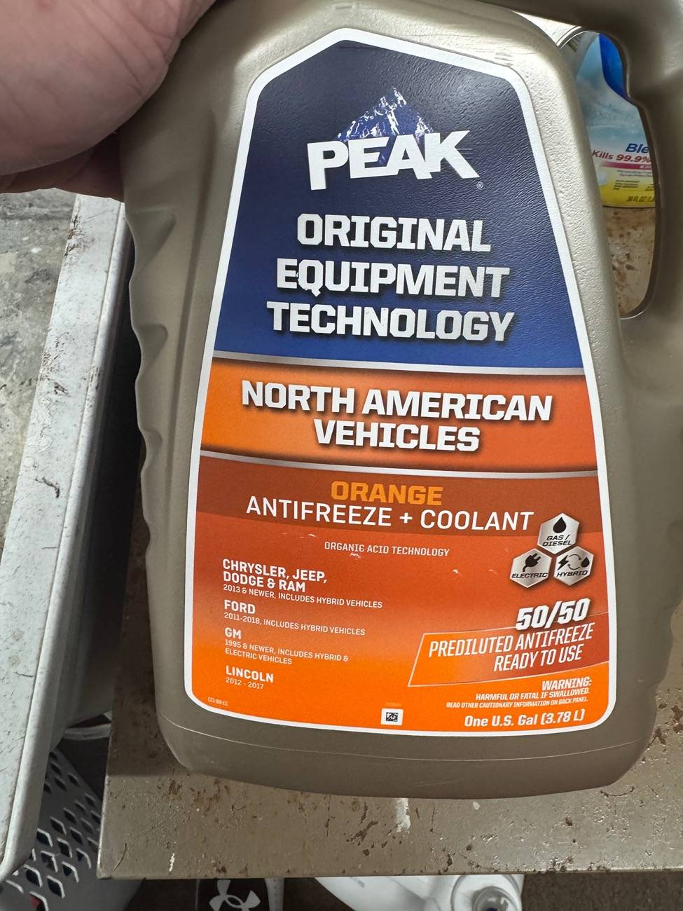

Went to AutoZone. The laminated card from Peak said to use orange for 2013+ Chrysler, this thread page two says purple, the coolant in the reservoir looks pink (the one by the BMS). I bought the orange Peak but second guessing. It's not that low just need to top off, should I take back the orange for something else?
Stuckinthesand
CJ
Apr 6, 2020
1,112
1,288
NJ
2019 Wrangler Sport S
I’ve been using the peak for a couple years now with no issues. It’s OAT which is what you need.
