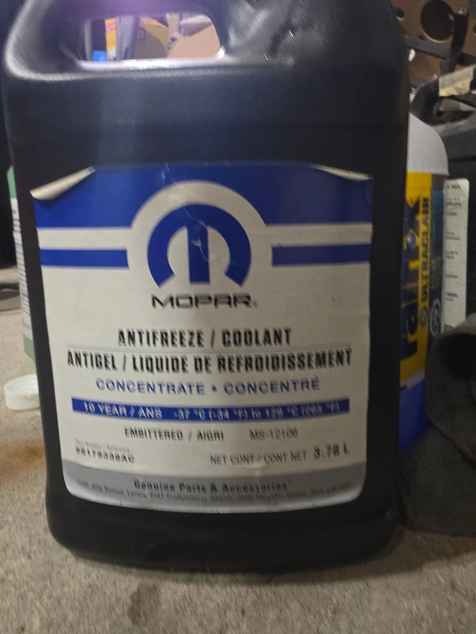

Went to AutoZone. The laminated card from Peak said to use orange for 2013+ Chrysler, this thread page two says purple, the coolant in the reservoir looks pink (the one by the BMS). I bought the orange Peak but second guessing. It's not that low just need to top off, should I take back the orange for something else?
orange is wrong.

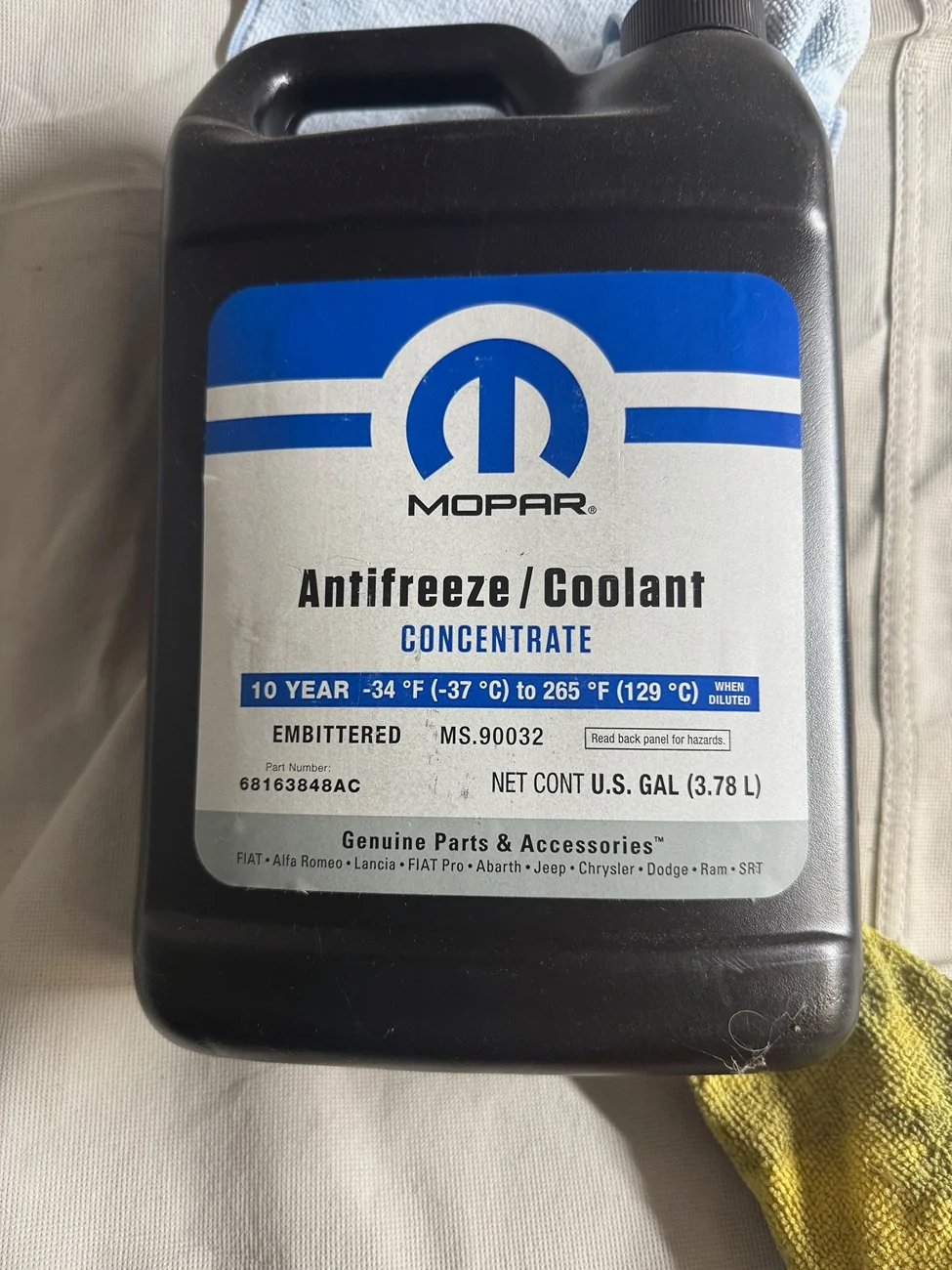

The color of the anitfreezw in my MGU and battery reservoirs is pink and the radiator looks pinkish as well . I believe I have the right antifreeze Mopar 68163848AC which should be diluted with distilled water to 50/50.
According to information on Mopar:
Mopar 68163848AC is a genuine 1-gallon bottle of red/pink Organic Acid Technology (OAT) coolant concentrate, designed for 2012–2024 Chrysler, Dodge, Jeep, Ram, and Fiat vehicles. This MS-9769 standard antifreeze provides 10-year/150,000-mile protection, typically requiring a 50/50 mix with distilled water. It replaces older part numbers 68163848AA, 68163848AB, and 68104496AA.

Looks like they are interchangable OAT varieties.
Takeaways for MS-12106 vs. MS-90032:
  • Compatibility: Both are Violet/Purple OAT coolant meeting 10-year/150,000-mile requirements.
  • Interchangeable: Dealers and documentation confirm that MS-12106 replaced or is used interchangeably with MS-90032.
  • Color Note:
    They are designed to mix, despite any slight color variations (some may appear more pinkish-orange in the engine, but are actually purple OAT).
    • Application: Used in 2013+ RAM, Jeep, and other FCA vehicles.
    • Do Not Mix With: Older HOAT (Hybrid Organic Acid Technology) coolants (e.g., pre-2013 coolant), as this can cause gelling.

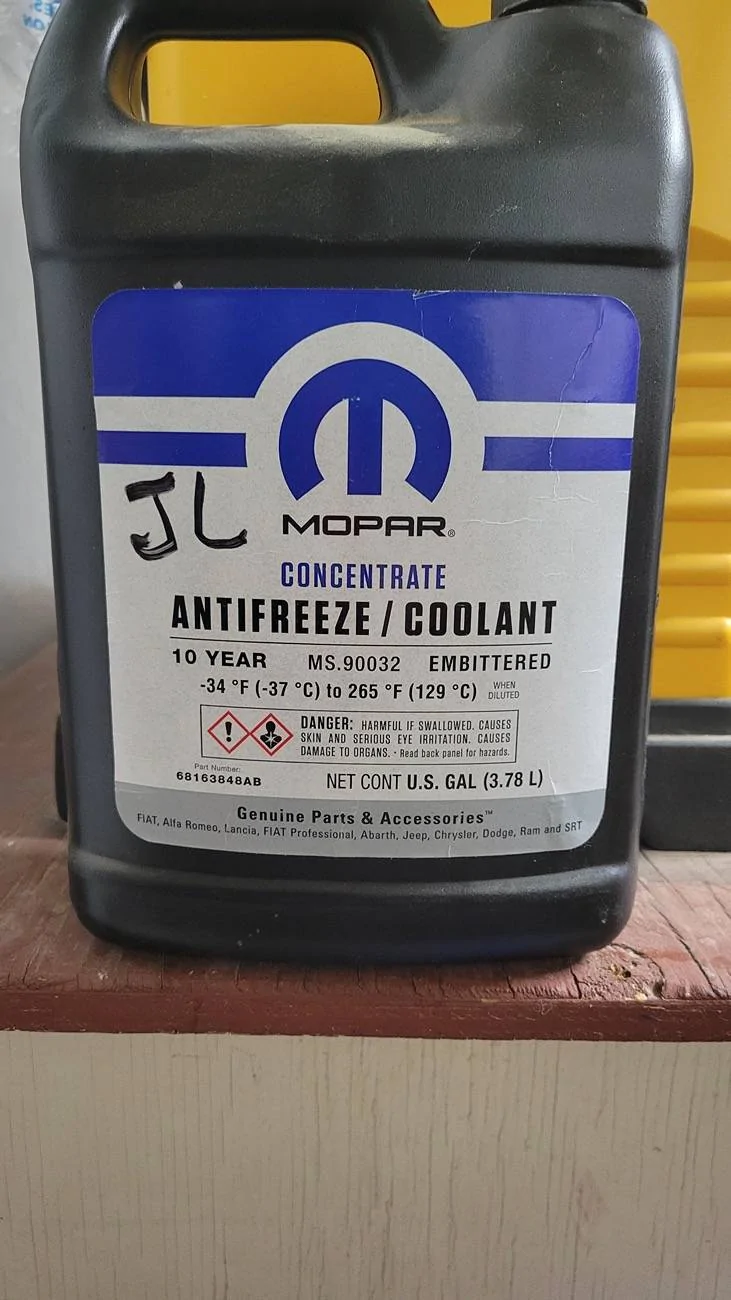

I think we're safe using these ones....

I agree but don't forget there is OAT coolants out there that don't meet the specks
