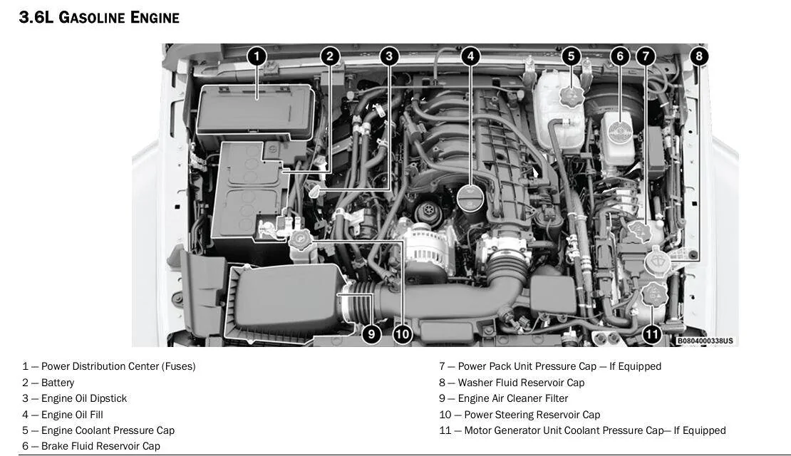

I own a 2023 Jeep Wrangler Willys Sport 2D with the 3.6 liter engine. I always like to keep extra fluids on hand so I can top off fluids as needed. (Yes - I am OCD and like my fluids at the max/full mark when at operating temperature). Is the coolant used for the Power Pack Unit and Motor Generator Unit the same as the coolant used for the engine? I don't mean to ask a dumb question, but I also do not want to add the incorrect fluid either.
I am referring to Item #7 and #11 from the engine diagram below. I am assuming Mopar MS 90032 50/50 Prediluted Atifreeze/Coolant.
Thank You in advance for any advice/help.

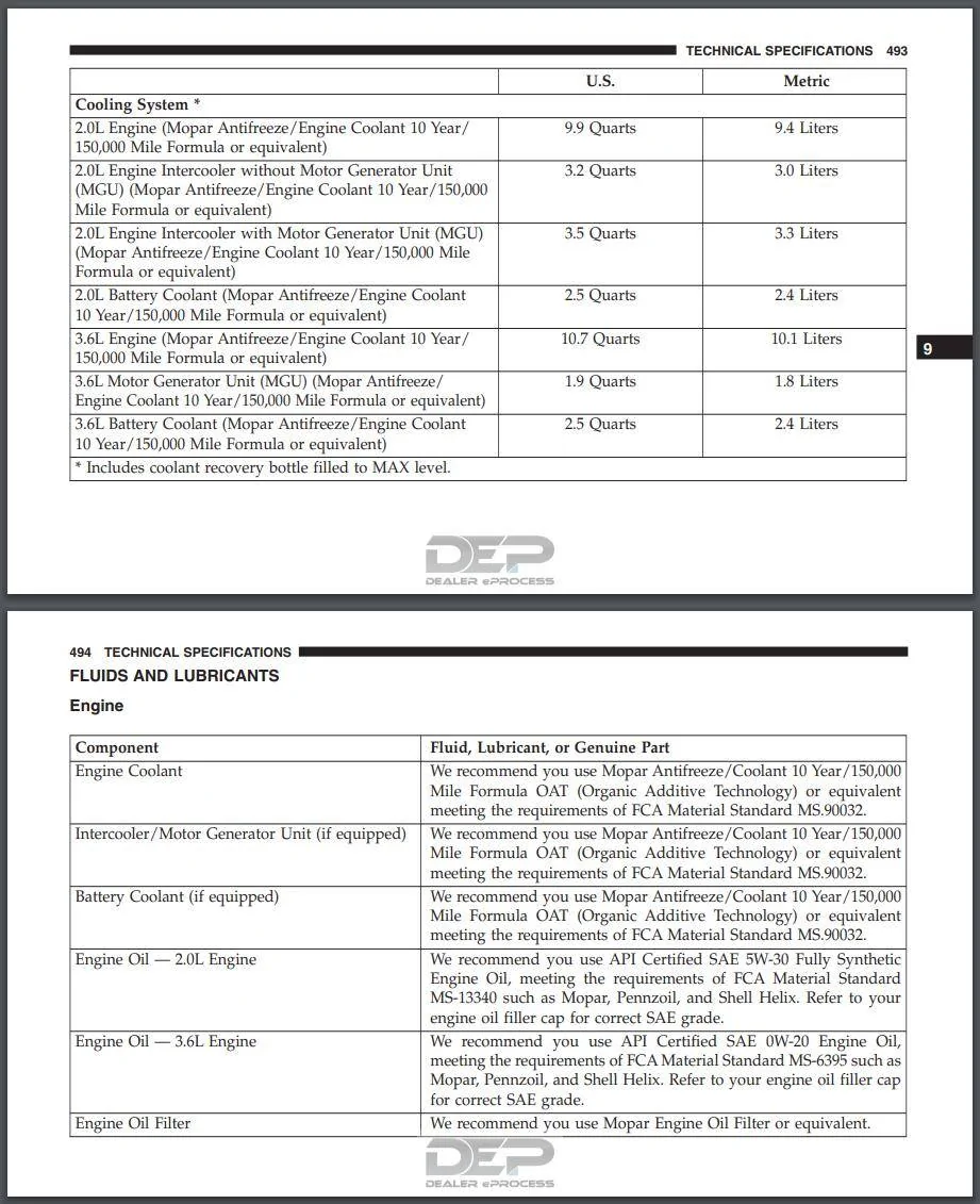

Interesting question. I have been adding the 50/50 coolant solution to the power pack and MGU reservoirs since purchasing my JL in 2021, but referred back to the owner's manual to see where this is specified and found nothing.
Weird that this isn't addressed anywhere, but I suspect it's because Stellantis wants us to pay big bucks for the dealership to refill the reservoirs...or it's just another careless omission in a poorly written, poorly organized manual. I'll bet on the latter.
The 2018 manual mentions the MGU and "battery coolant", though my '23 manual only specifies MS.90032 for the MGU and the power pack unit (PPU) only shows capacity.
Definitely vague af for certain years.
Yep. The same section in the manual for my '21 Sport only lists engine coolant. No mention of battery or MGU at all. Thank goodness for common sense and this forum to help make up for a rather shoddy operator's manual.
