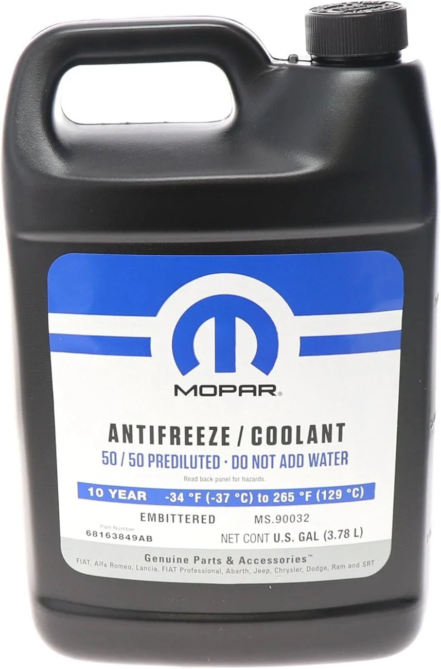

Wow, my coolant (overthrow) tank is clear, not black. WTH?? Do this: buy a gallon of (ONLY) this coolant, picture. Comes in pre-mix ready to use, or concentrate, mix with 50% distilled water. The premix is great to easily top off your coolant level, "occasionally". If you have to add coolant frequently, like every month or so, you have a leak...

Use only OAT coolant; the Mopar product is best.
