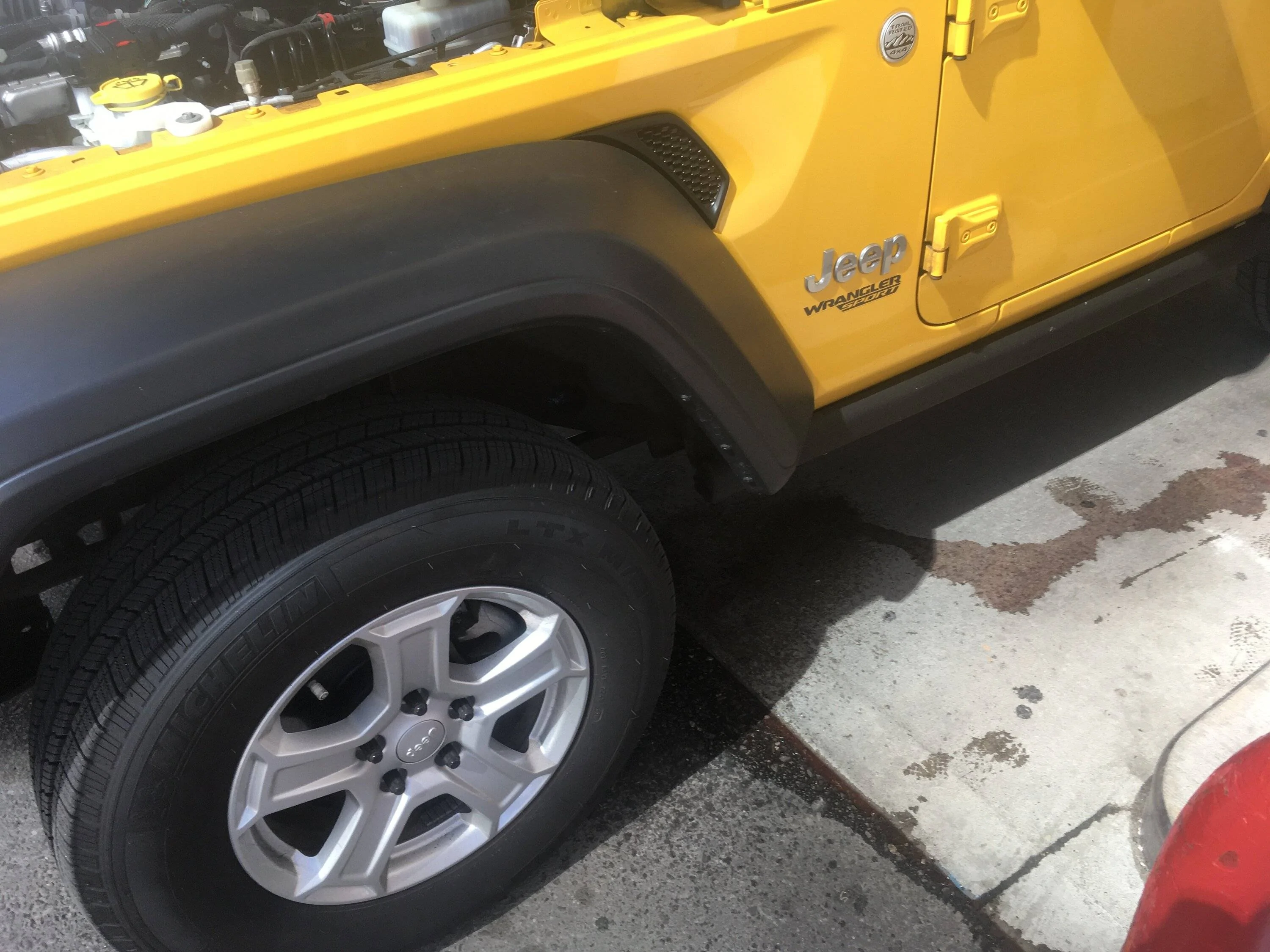

My new(ish) to me 2019 JL Sport, has me somewhat concerned. Was in traffic for close to an hour, bumper to bumper crawl, hot & sunny in the city, pulled into gas station to fuel up, and my jeep marked the ground with about 8-10 oz of rad coolant. Opened hood and tried to find where it was leaking from and couldn't really locate source. Reservoir still showed half full, at bottom of safe level. No warnings on dash, no aggressive fan noise (tough to hear over loud music), just a quick sprinkle on the lot. Continued onto destination with one eye on temperature, while heat was on max.

“in traffic for close to an hour, bumper to bumper crawl, hot & sunny in the city”
You didn’t mention what your engine temp readings were, but from the statement above, you were most likely running with the A/C on. And since it hasn’t been asked yet, are you sure this isn’t just normal A/C condensation (water)? It’s hard to tell from the photo, and it’s too late to see if the spill is in fact colorless, but it appears so. It should be easy to reproduce the event if it is condensation. Take the vehicle out on another hot day and run it slowly around town (not on the highway) with the A/C on high for at least 30-40 minutes, stop the vehicle on a similar clean surface and shut the engine off. If another spill occurs, use a white paper towel to dab some of the liquid up and inspect it for color, smell, and viscosity. If it’s anything other than water, it should have a color, a possible smell and have some degree of slipperiness.
[/QUOTE]
yep, just a cursory glance and it looks like condensation...but I'm just spitballin'
