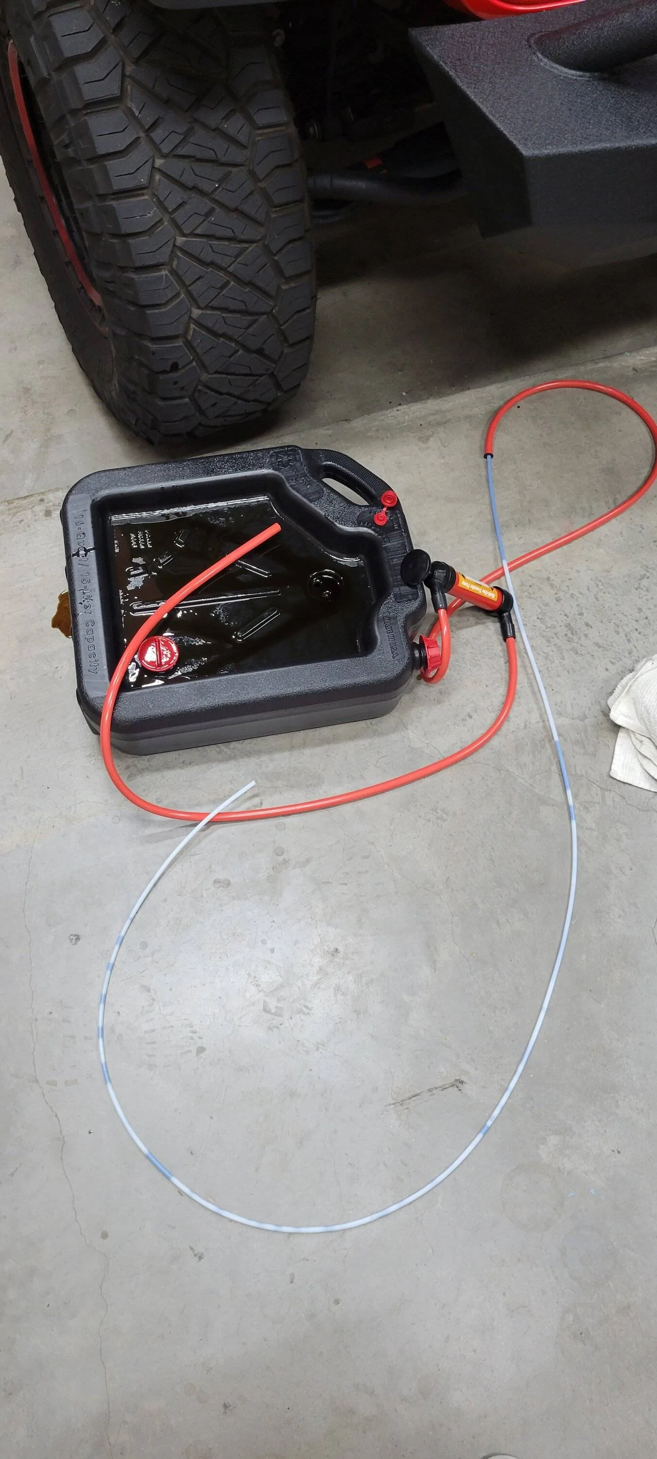

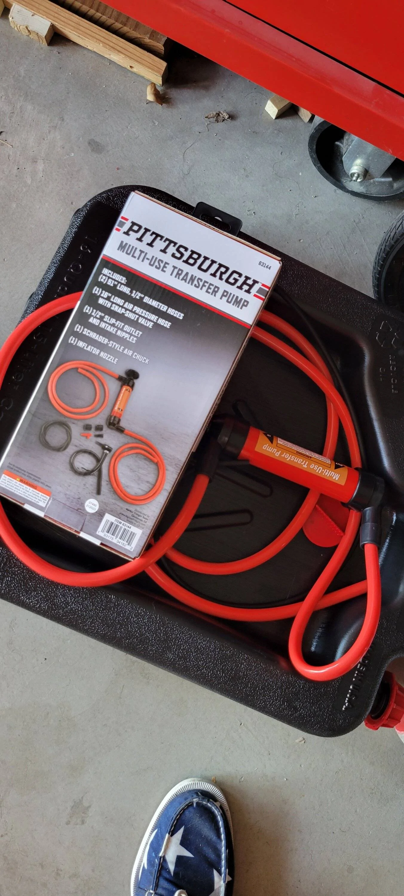

Anyone know how to use this to pull the overfilled oil out the dipstick hole like it says on box? I got it to work with water in a bucket but can't seem to get any oil from dipstick hole or the engine fill cap????!
You never will, the dipstick tube doesn’t extend down into the oil sump. You’re just sucking air.

I'm surprised to hear that if the dipstick gets quite a bit oil on it and this kit specifically says it can pump oil out of a dipstick hole with the provided skinny black line but maybe this is the case for other vehicles and not this Jeep?

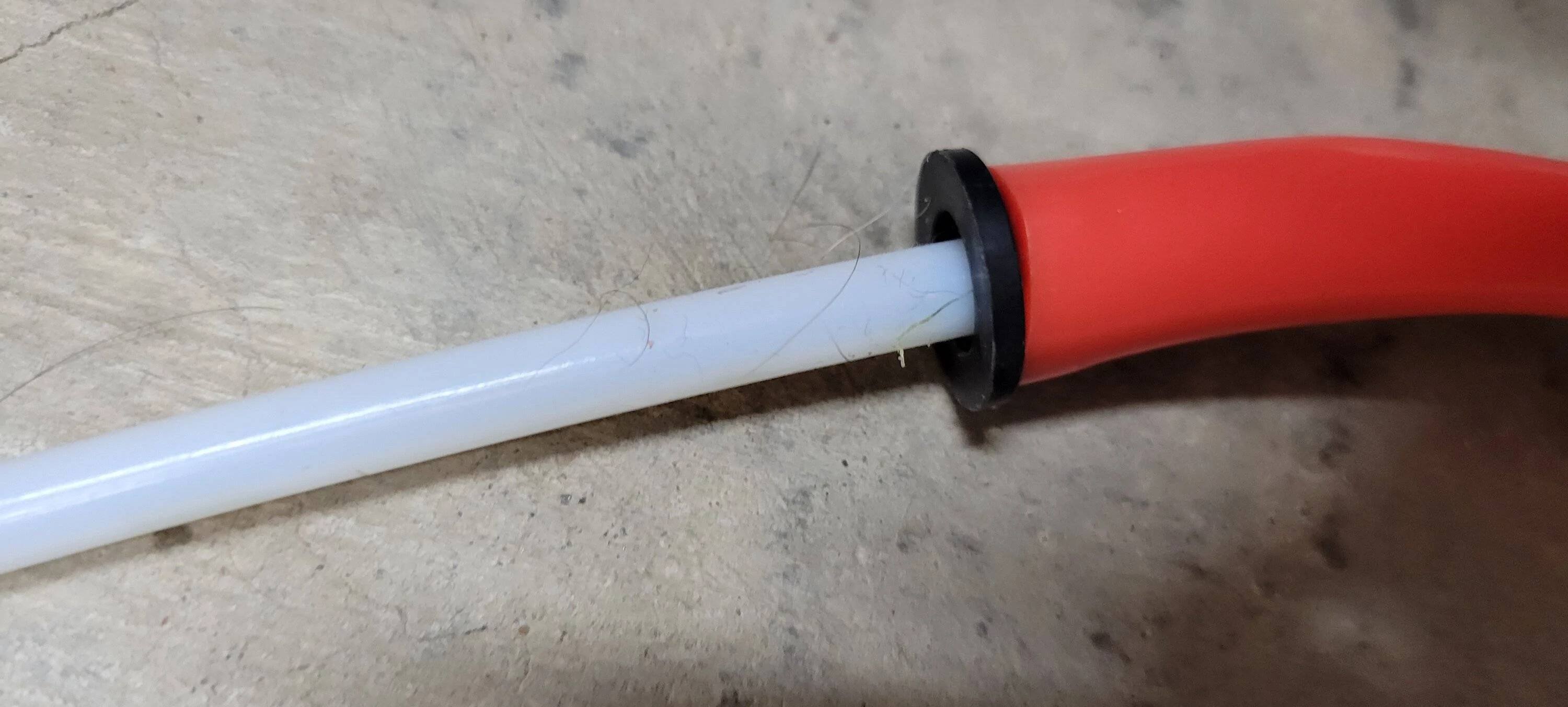

You would need to feed the line down inside the dipstick tube and into the bottom of the oil pan. If that’s what you’re doing, you aren’t going far enough, or you’re going too far and it’s curling back up. Either way, bad product.

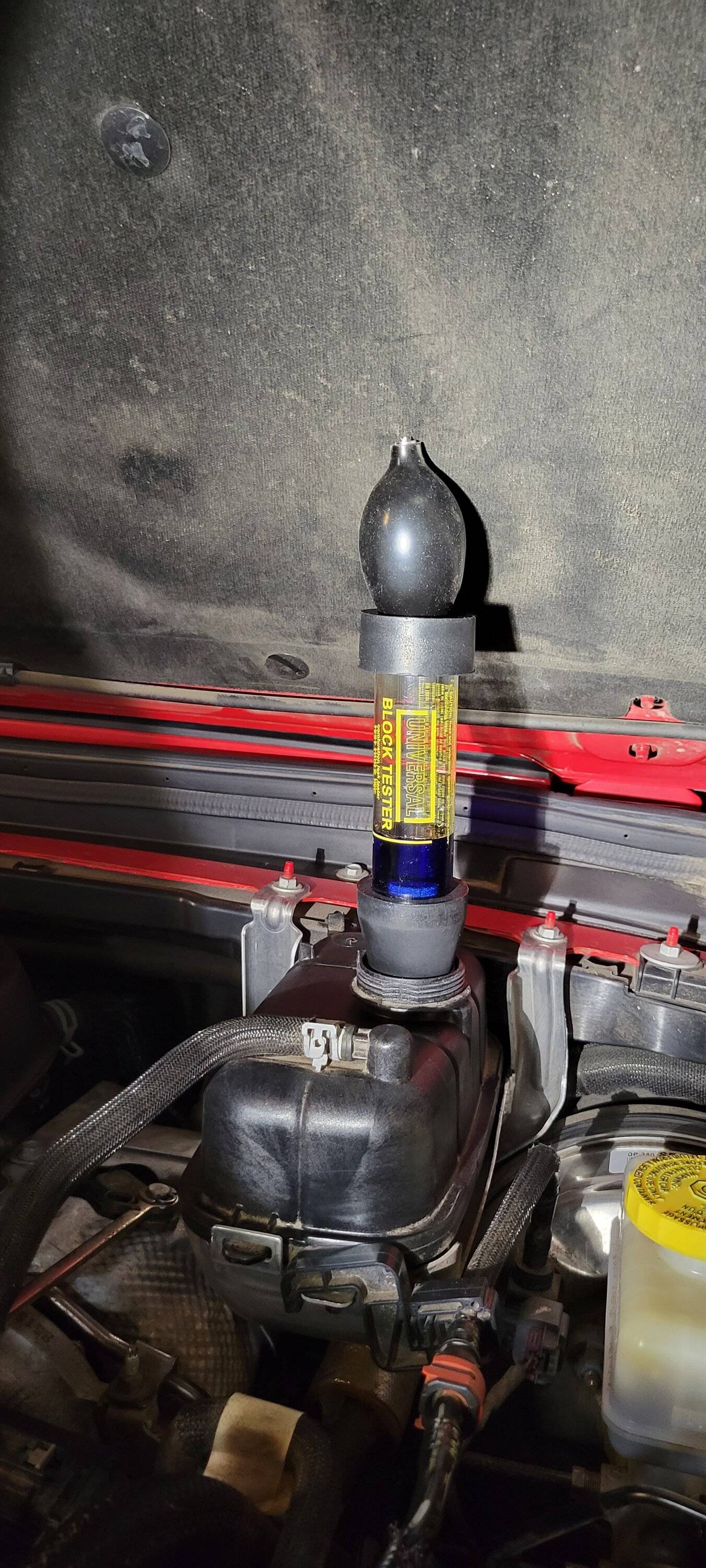

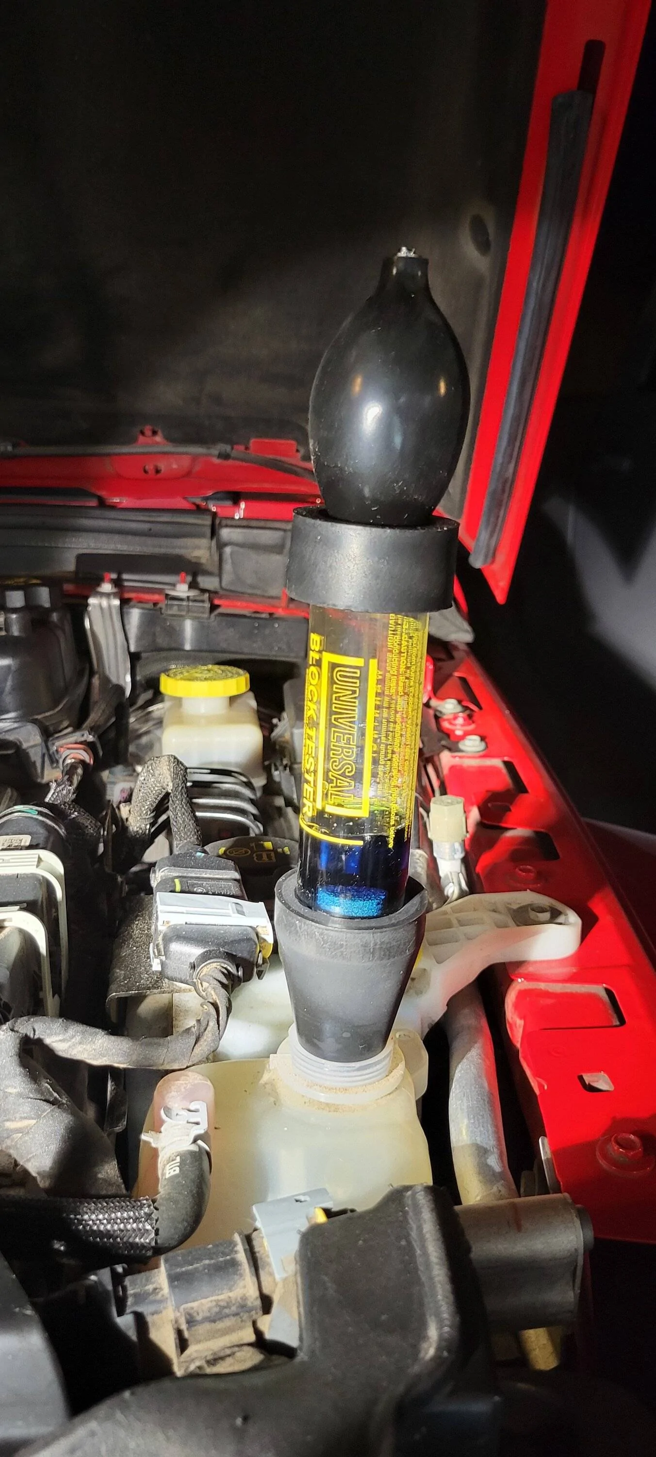

Bad product is right. I got some 1/4inch poly thick walled tubing and tried again. Definitely got deeper and the tubing didn't collapse on (only the red tube did a little)me when pumping thick oil. It worked, now I'm going to see if coolant is leaking into the oil or vice versa and do this "Block Tester" kit tomorrow on the overflow tank.

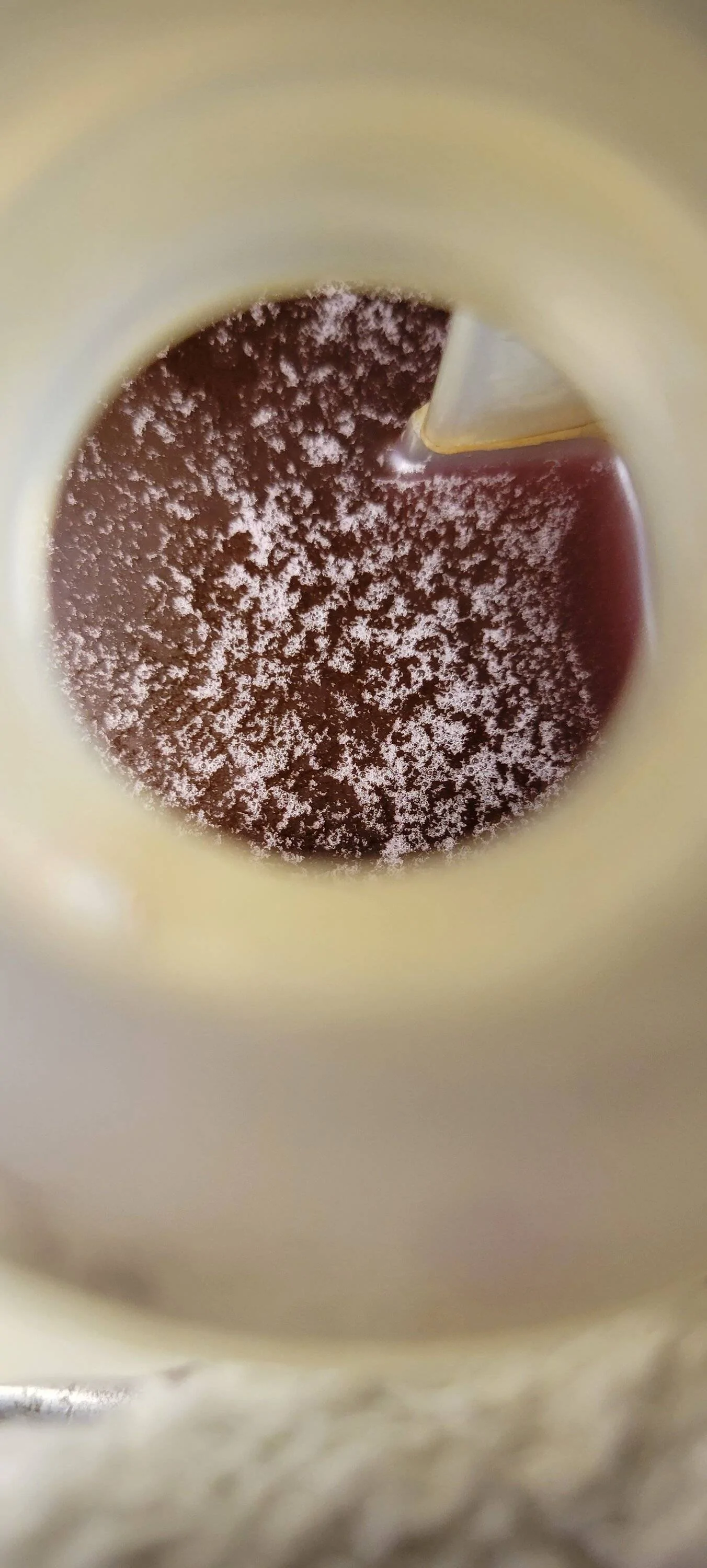

I went ahead and did this after doing the "block tester" test and it was all good. I did notice turbo one seemed darker and maybe foamy than the 48v battery one but no idea how the engine one looks due to its black tank. Any concern here?
