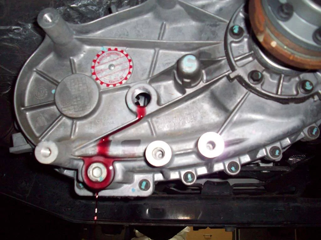

Just for clarity;
The 'red' fluid is coming from a drain plug? That is not your transmission. It's the transfer case - it is what switches gear ratio for 2wd/4wd high/low.
The Transfer case fluid is standard ATF+4 and is red.
The ZF8 and Mopar 8&9 is green and for the transmission only, and is a much more complicated procedure to change.

Just for reference, this is where the drain and fill plugs are on the Transfer Case
Jeep Wrangler JL 2.0 JLR Automatic Transmission Oil 100_2116
There is no drain plug on the actual transmission. You have to drop the pan to change the fluid.
Honestly, you would know if your ZF8 had regular ATF in it instead of the required ZF fluid. At best it wouldn't shift well -if at all - at worst it would eventually destroy the transmission.

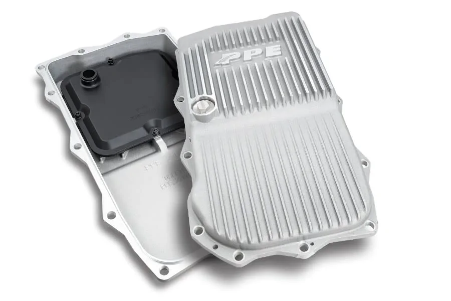

I've been toying with replacing the pan with this one,
Jeep Wrangler JL 2.0 JLR Automatic Transmission Oil w86vm8tq8be5aaawb5mj
Not so much for the drain plug, but for the extra heat dissipation. More and more 100+ days here in the Vegas summers have me considering giving it a bit of extra help.
I do a ton of slow stop and go driving as well as 50ish miles a day on the highway.
Temps always look good, so I might be looking at something I really don't need.
With regular driving, seems it couldn’t hurt at least. And if you have an engine skid, even better.
