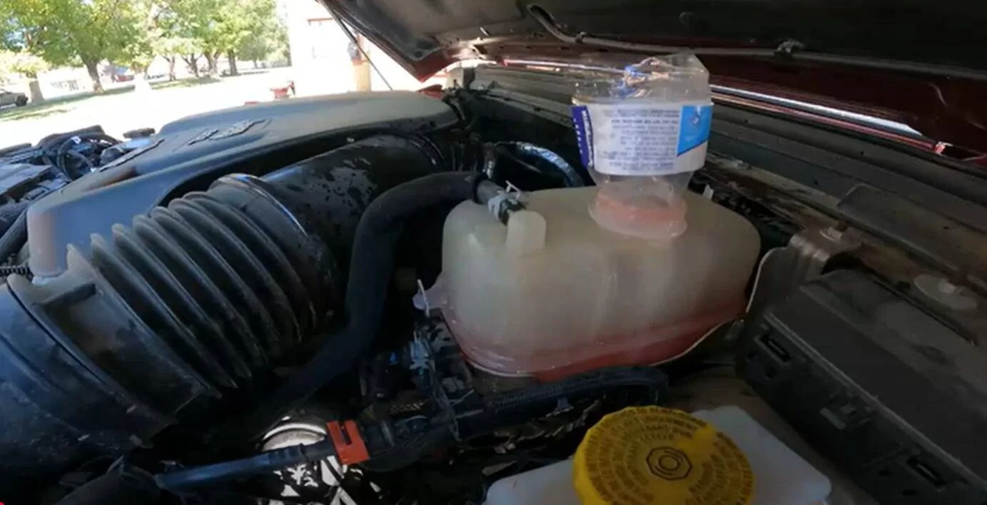

My trouble-free days with my '21 JLU have ended. Today I smelled coolant at the drive through but didn't think much of it. I'd topped off the reserve tank the day before and spilled a drop down into the bowels of the engine. It's burning off, I thought.
Fast forward today while getting gas and I look down under the Jeep and a waterfall of coolant is now on the ground. I open the hood and the reserve tank is full, bubbling, gurgling, overflowing. Coolant temps and oil temps, as well as temp. gauge all show normal.
I turned on the AC to get the fan going, and nothing... normally I can hear that fan a mile away.
I'm thinking my fan, or a fan controller has gone out? I just replaced my main battery - that's the only other change that has been made.
Any thoughts? Calling the dealer today but would love to go in prepared with knowledge.
TIA, JBC

Something similar happened to me (JLURD) on our 1st trip out to Moab. I started smelling and seeing "smoke/steam". Bubbling up like nobody's business. Weird thing was that the cap was open slightly. I didn't open or fill at any time B4 the trip and this was hundreds of miles along our journey.
After we were able to get her to cool off and we found more coolant, we filled her up. It took almost a full bottle. No more problems after that.

The Jeep’s coolant bottle will throw up any excess fluid you put in. All the Jeeps I know keep the coolant level right under the bottle’s middle seam. If you put more, out it will go when the Jeep reaches normal operating temperature.

Where was the coolant leaking from? If the temps showed normal I don't know if it would be the head gasket. When my head gasket went on another car that had a different engine, the temperature spiked and the coolant reservoir went to empty.
I wonder if maybe the cap wasn't on all the way and where it didn't pressurize and coolant came out of the cap? I also remember seeing that the reservoir can crack at the seam.
I'd just topped mine off to the Min/Max line the day before. When the engine was hot, the bottle ran full/overflowing/bubbling. There is no fan noise what so ever. The fan isn't coming on.
That's what I'm thinking too...
It was hard to tell where it was coming from on the plastic bottle. The coolant was boiling and gurgling in the bottle.
The cap was all the way on, snug. Or so I think... I remember turning it until it didn't turn any more with that in mind. But I don't remember feeling/hearing a 'click' as @Heimkehr pointed out (2.0 vs. 3.6?). It was definitely dripping onto the floor from above driver-side control arms.

Much will depend on how long the overheating was taking place. It takes a while for the higher temperatures to cause damage.
Was there coolant left in the radiator? If there was sufficient coolant left, this would help keep the engine cool.
When the engine gets hot during regular driving, the engine fan will come on to cool it down. if the fan is not working, the temperature will start going up.
Your temperature gauge did not reflect the increased engine heat. Hopefully, the overheating was not going on for long.
Keep us updated.
