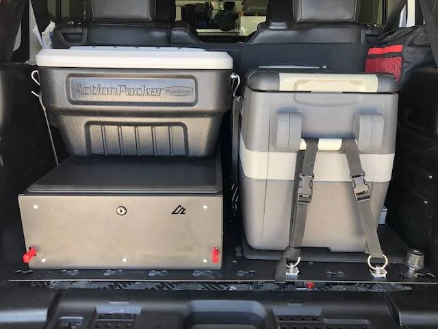

I second the Iceco. There are several good choices in 12v Fridges/Freezer. I have personal experience with Engel, Iceco, Dometic. I have found the Iceco has some of the lowest draws in amps when running. I am currently running the JP-50 and if fits great and has lots of room. Pic I posted is the JP-40. The JP-50 is about 3.5 inches taller and the exact footprint of the 40. I would highly suggest a portable battery pack or a 2nd battery ( LiFePO4) to run your refrigerator . Sure you can get by for a while with the stock battery but it is not designed for this purpose and will shorten the life of the battery (not that they are that good to begin with). Dometic and ARB are quality units but what Fatboy97 stated is true. I currently have 3 Icecos and an Engel. No problems with any of them.
