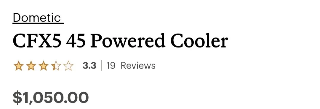

Oddly, when I Googled the fridge it gets 4.5 stars just about everywhere, but it's a lie. REI.com shows 4.5 stars until you go and look at the actual reviews... and then it gets 3.3 stars.
Your claim was unexpected, so I looked at REI and this is what's on the main page:
Jeep Wrangler JL Dometic CFX545 - BEWARE! 1000012575
3.3, not 4.5 stars.
