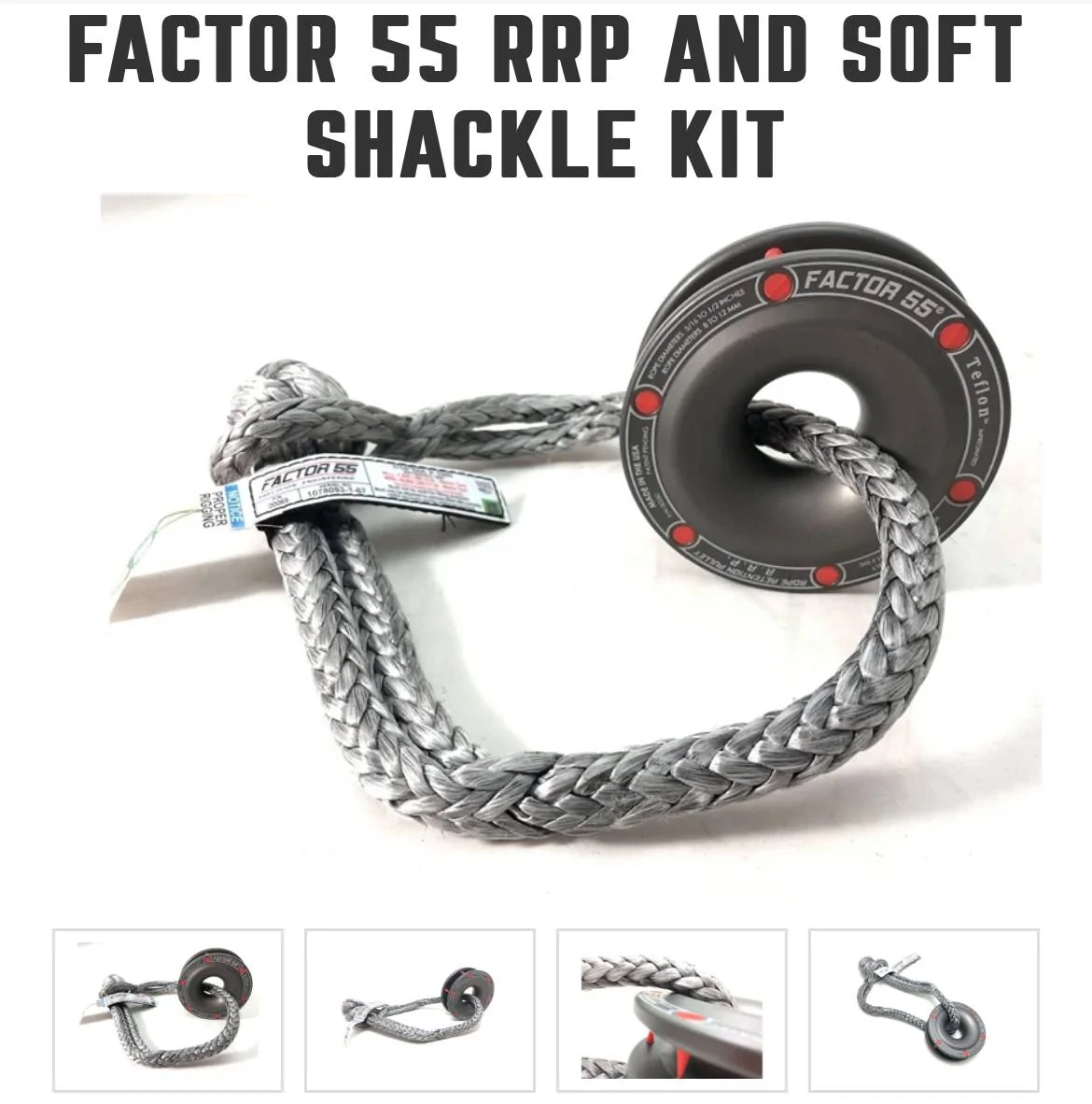

Bang for the buck that’s probably a winner. Those Smittybilt things were the first and last recovery items I skimped on.
I like the Factor 55 RRP though, the little rubber nubs really do help keep the rope in place while setting up. I already had 3 plus the two el cheapo’s. I tossed those and ordered another RRP yesterday. I if I can’t get out with 4 pulleys I might need help.

This is why for my money I'd go with the non-edible donut for a recovery kit, no moving parts to break.

Yep that's the ticket! As for some who prefer donut type. Yes there is no moving parts... but the roller on the snatch block lessens the stress by evenly distrubing load along the bend of the rope. Donuts can make more stress at the bend by frictional forces applied by weight of the pull. Having a roller eliminates frictional forces. Also donut design requires a soft shackle. Over time depending on use in recovery jobs, soft shackles don't last as long and are expensive.
The big drawback with cheap plate design is size and weight. The pully is heavier than all the rest of the components. There are smaller designs but they are a bit weighty over donut type.

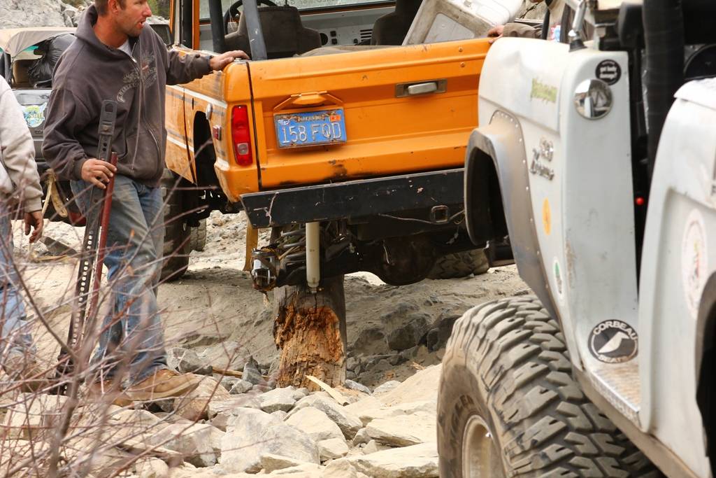

I do question using "ratcheting tie downs" in a recovery. To me, the only use they have is securing cargo and could pose a safety risk that, to me, would not be worth the risk. Now I can say I've never seen ice road truckers, so I have nothing to base it on.

An example of the use of a "ratcheting tie down"

Ah as an emergency repair on the trail I completely agree!! But as a recovery I feel not a safe option. I say this as I witnessed a full size truck towing a 4 runner with a 1” ratchet strap just this last week not a good option or a safe one

I agree that towing with a racket strap is never a good idea.
The orange vehicle in the picture was being towed by the vehicle in the front. The strap was holding a log to keep the driver's rear off the ground. They had just came out of the Fordyce Trail and was trying to get it to a trailer which was further on the Fordyce Trail Road. Fun times...
