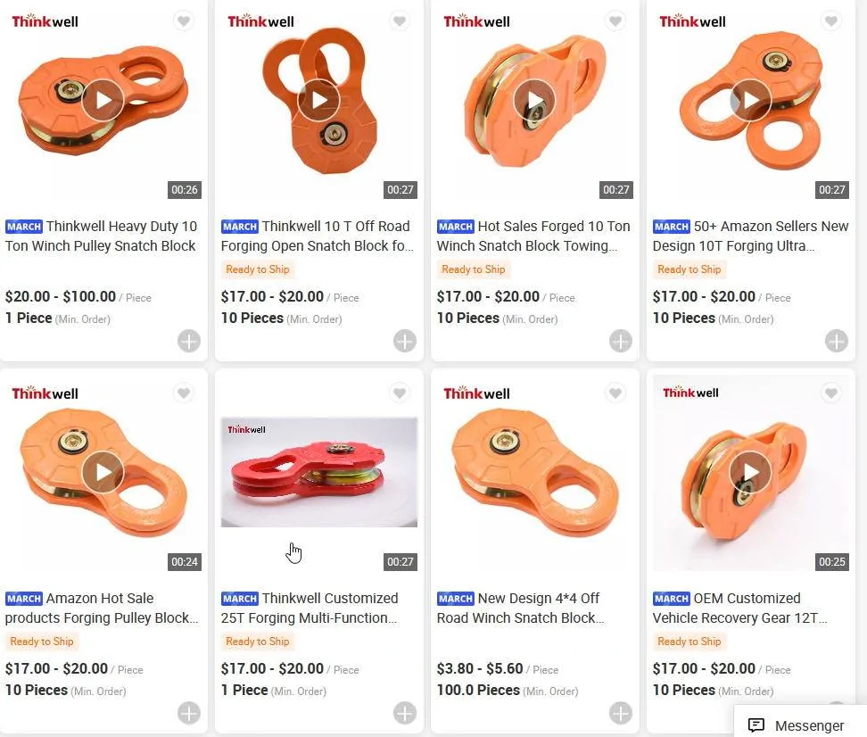

beefy is probably because it is a low grade metal. They have to use a lot more meat to make it stand up to the force. Gear America is based in FL and the guy does it out of his garage. It is just rebranded equipment from a Chinese company Thinkwell. People probably rave about them because they are cheap. I'm sure they work just fine, but I would put them below Harbor Freight.
Labor is cheap in china and you can get metals cheaper there, but certified materials are about the same price for raw stock. The hard part with China is knowing what you're getting, there are some excellent quality products produced there and at my company I've seen some amazing machine work that a lot of US machine shops cannot do (top shops can do even better, but cost a lot more). If a company is getting parts from China and doesn't have tight control on material and post processing callouts they will have varying results with their products. In products like recovery gear, those material properties are put to the test and if a product was built with a weaker grade of say 6061 aluminum then they may be producing something inferior to what they initially tested.
In the recovery world its ropes and metal parts. Its not like any of this stuff is made of magic materials. How they make it, design aspects like radius of an edge the rope will push against, and their finishing are all important factors which lead to the prices products are. I know machining, molding and sheet metal quite well. I'm very limited in my knowledge in the rope world. If you buy good recovery gear, it will last you a life time if you care for it. Things like ropes won't, but hardgoods will.
