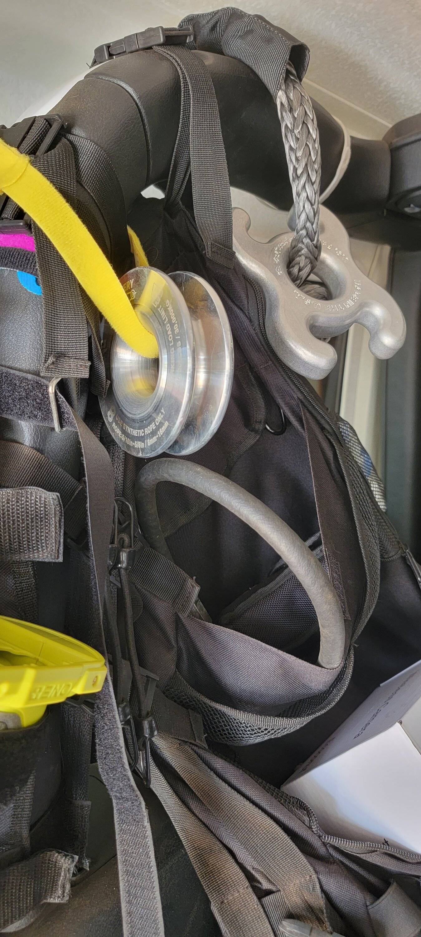

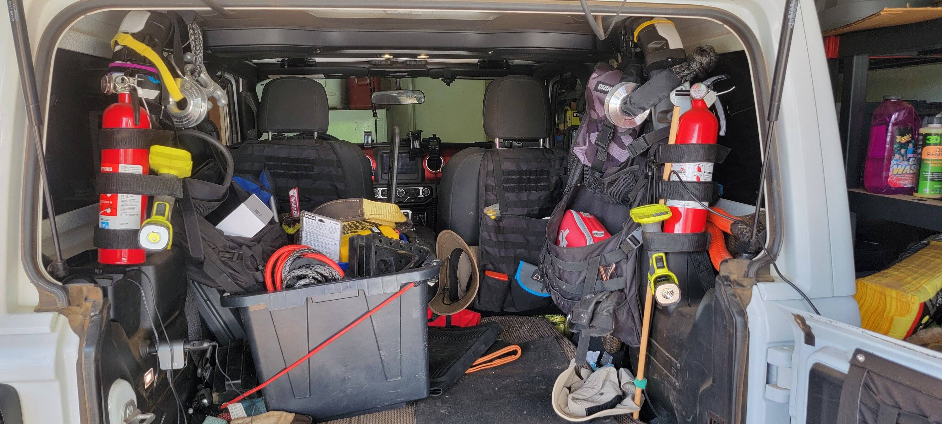

I've done at least 20 recovers with this 66,000 snatch ring. I've got two in each of my Rubicons. I've got a heavy snatch block under the seat. Snatch blocks are heavy missiles in the back of your Jeep.
With 2 snatch rings you can easily get 3:1 or 4:1 using a Spanish Burton rigging. SB rigging requires an extra winch rope.
