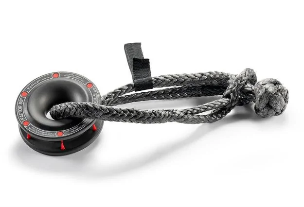

I’ve only used the ring paired with soft shackle with my synthetic line. For me it’s all about weight and reducing potential harm from anything becoming a projectile. I also have no intention of getting stuck in mud. On a mud truck I’d go steel cable and the opposite of my setup.

I used this not frequently but several times. It is designed specifically for synthetic line and soft shackles which is perfect for me because that is the only line I use. It is lightweight (about 2 pounds), seemingly durable, and easier to use than a ring.

Factor 55 is incredibly proud of that. At $160, that is as much as a full-fledged snatch block that is designed specifically for a synthetic rope.
