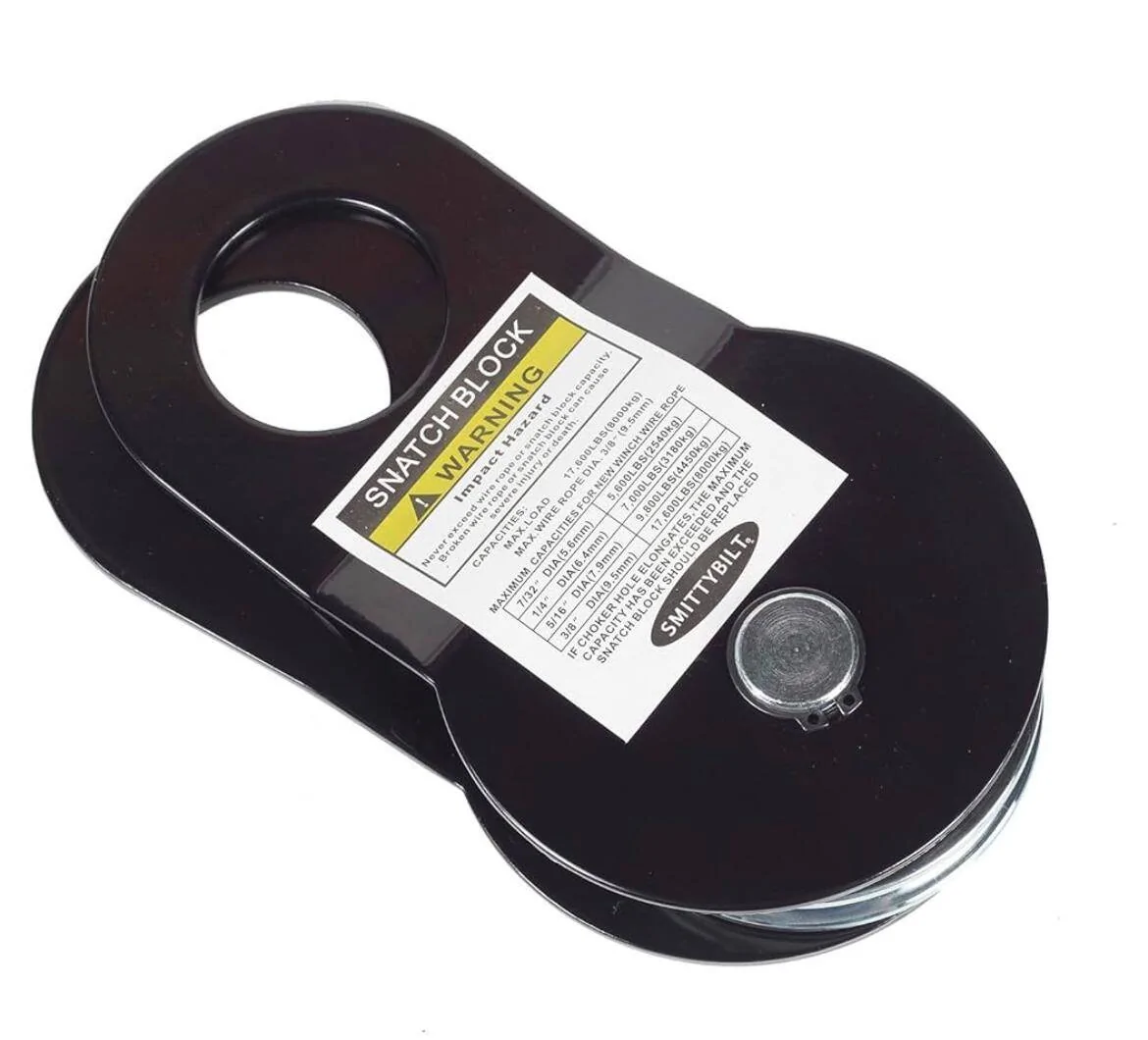

I have, correction “had” a couple of Smittybilt snatch blocks I bought 5 years ago. I figured they were inexpensive and if I needed one, they’d be better than nothing.
Jeep Wrangler JL BEWARE: cheap snatch blocks 1739117352916-la
Yesterday my friend @Oh_Jeepers and I cleaned my winch lines, then proceeded to reload the winch under tension. We used a tree saver around a light pole with a 7/8” shackle connecting both ends to the snatch block. The Jeep was in neutral with the parking brake partially set to put some load on things.
When we got to the end and took tension off the snatch block, it fell apart. One of the shackle c-clips had come off and the center pin, without tension, came out on that side releasing the pulley. (sorry no pics of this)
The only other time I had used these was 4 years ago while helping install an emergency siren electronics box. If one of these snatch blocks had failed under load someone could easily have been hurt or killed. They now sit in the trash bin and will make a trip to the landfill tomorrow.

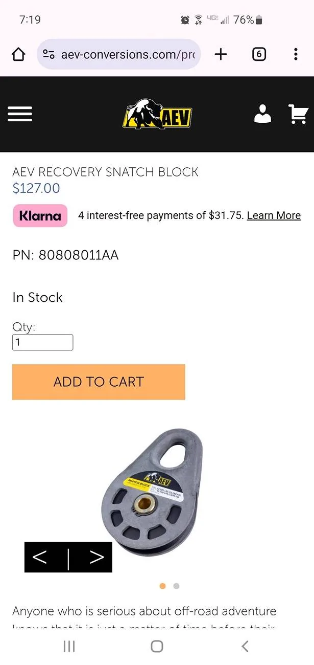

Pretty crazy how it fell apart. My recovery gear consists of Factor55 and AEV. Spent a pretty penny on both but with the piece of mind they are quality parts engineered for the recovery task at hand.
I have this snatch block and to date its been solid on the rare occasion I've used it

Bang for the buck that’s probably a winner. Those Smittybilt things were the first and last recovery items I skimped on.
I like the Factor 55 RRP though, the little rubber nubs really do help keep the rope in place while setting up. I already had 3 plus the two el cheapo’s. I tossed those and ordered another RRP yesterday. I if I can’t get out with 4 pulleys I might need help.

Hey all
I was with @BDinTX when he discovered that the pulley came apart and was shocked to see the snap ring off the pin and separated from pulley. When we connected everything worked as it should have with nothing indicating that snap ring was lose if I had to guess the load that we put in the block caused ether the pin to flex or snap ring to flex off.
Also down in TX not a lot hills around our neighborhoods without traffic to put a load on so the use of the concrete base of the light pole and with me in the jeep with the parking break almost fully applied it had a good load on the line.
The point of all of this is to pass along things we all find to look out for our fellows in the 4X4 community so no one gets hurt.
I'm going to do some looking at the AEV snatch block so thanks for the info.
