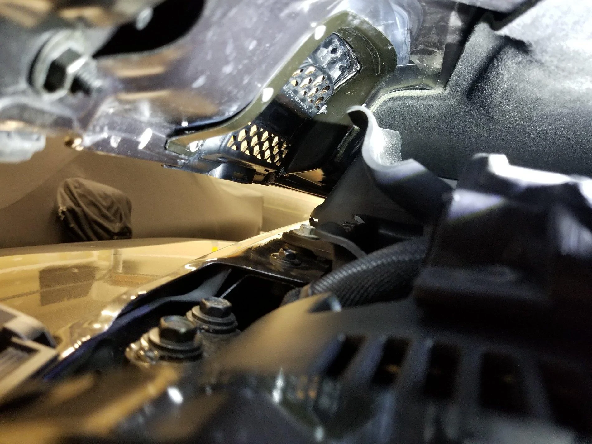

Looking at the picture, I'm confused as to how the outside air gets from the newly created vent into the air filter assembly. It looks like the assembly doesn't mate up the hood vent opening. Is there an unrestricted path that we can't see from that angle?
Here is a better picture of the two. With the hood completely closed you can see how the air is directed in.

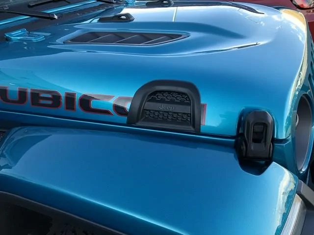

@BrntWS6 Wondering about adding this option to the build sheet and why you did the mod. Were you seeing air intake temps that were uncomfortable or just like to let a diesel breathe? It appears that it would interfere with the Rubicon side decal. Wondering what Jeep will do in that regard, slide the lettering over, reduce lettering, or eliminate the lettering.
I'm guessing it'll look iike this:
That's how they've been doing the snorkel, right over the top of the Rubi decal. I think it's the best route.
Yeah that doesn't look bad like I had imagined, thanks for posting the picture.
