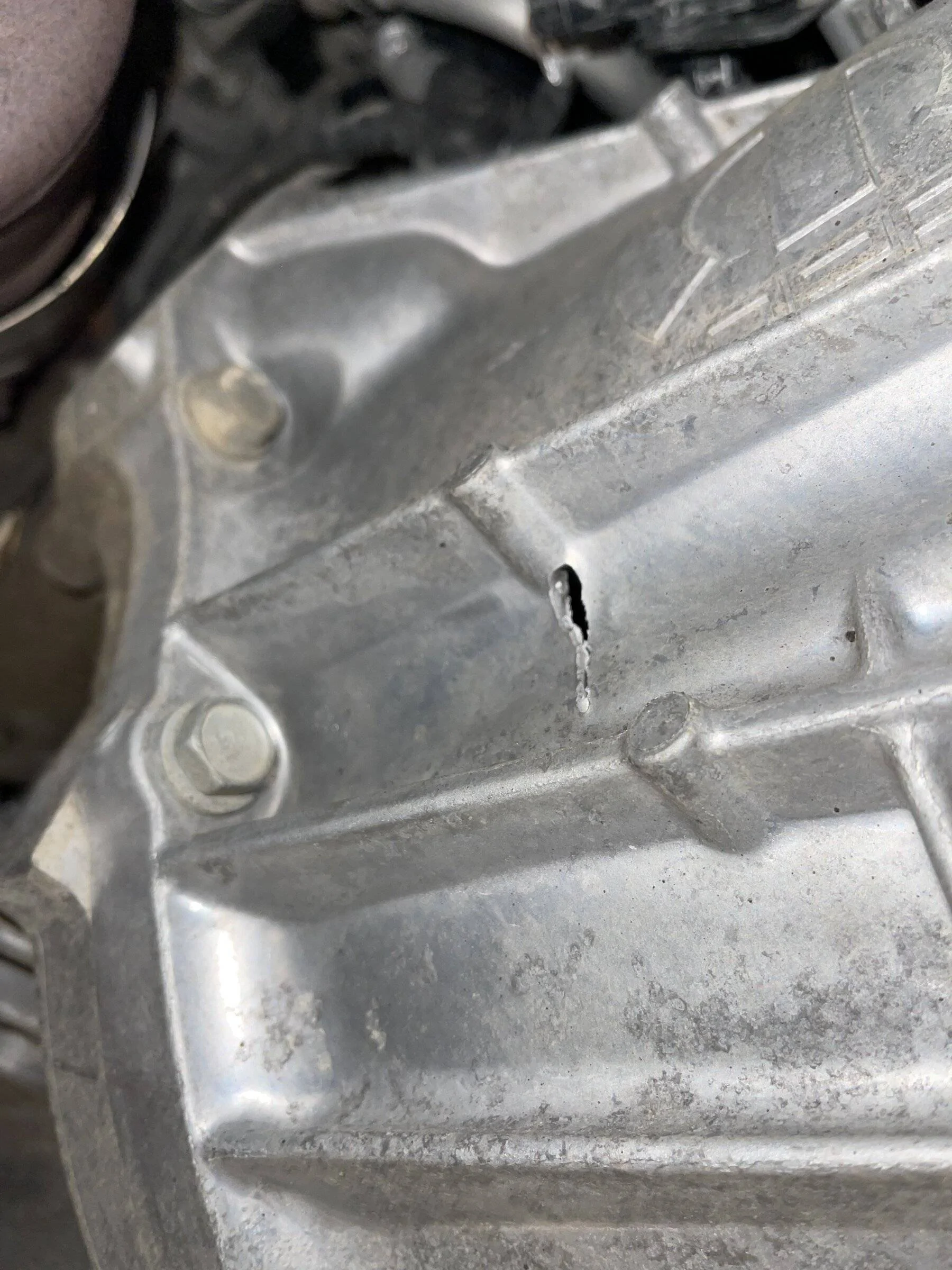

Get the recall done. I had the recall done and it does NOT detune the engine but does make the rev hang a lot less noticeable. I stated this in another thread that in my opinion when the rpm's rise when shifting (rev hang) I'm sure it overheats the clutch. My 2022 barely has any rev hang.
The Recall will ONLY Detune the engine when an Over Heat Condition occurs.
QwikKotaTx
Feb 8, 2022
515
584
Houston, TX
2015 Hemi Ram, 2002 Porsche 911 Turbo

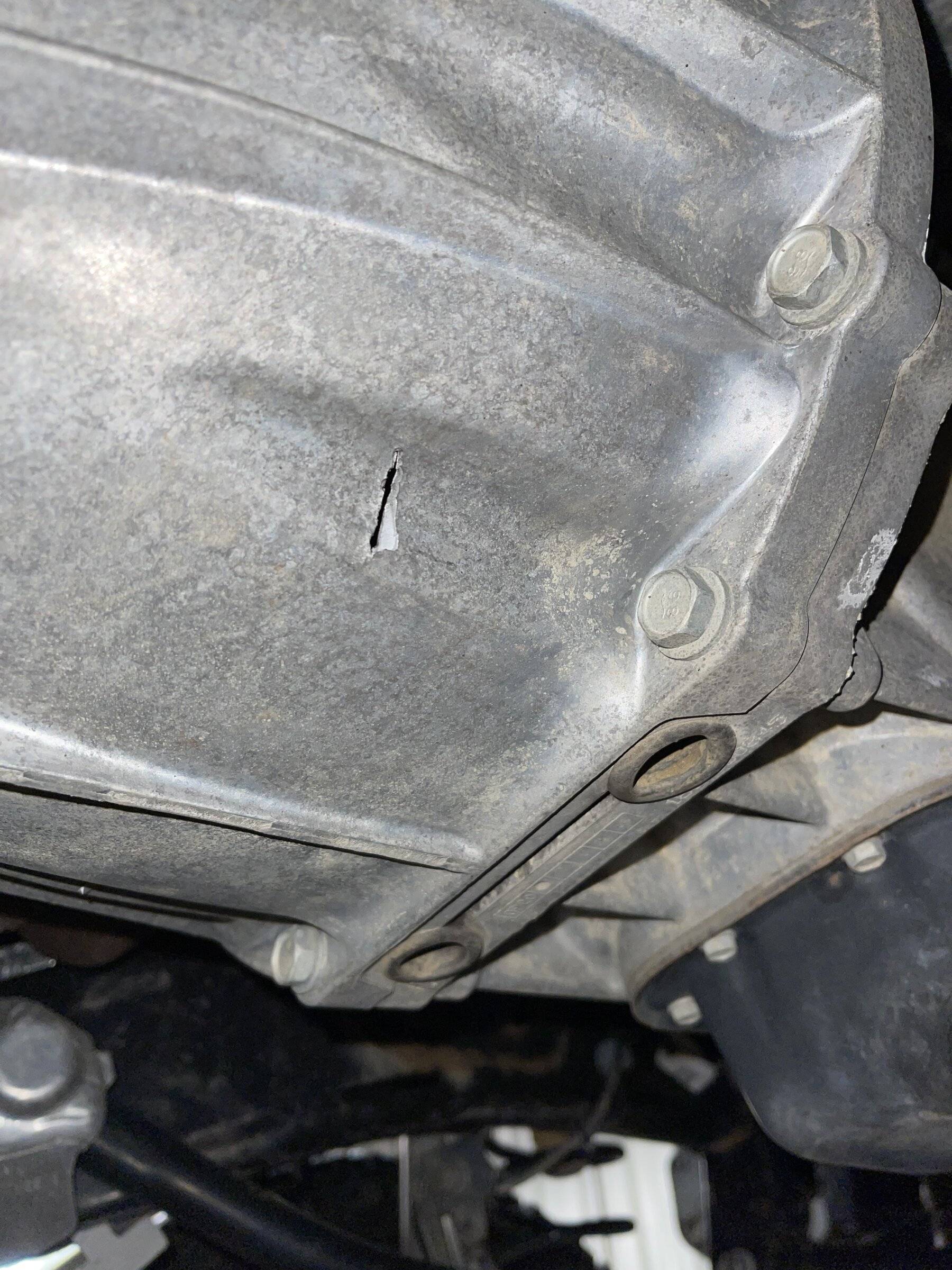

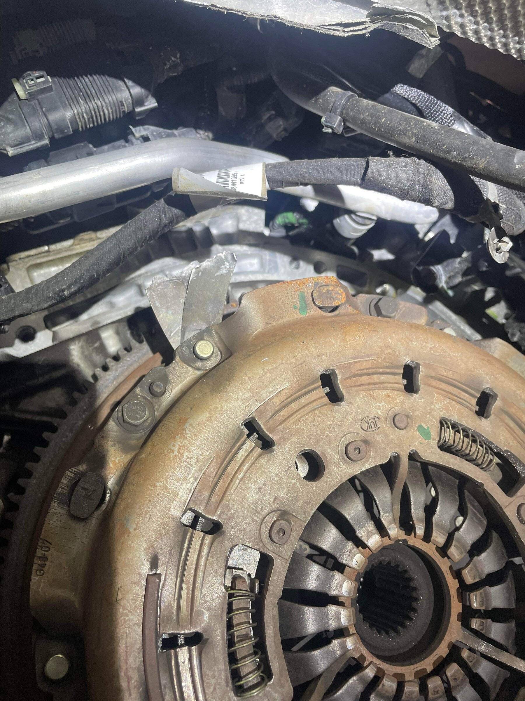

I think you'll be good.

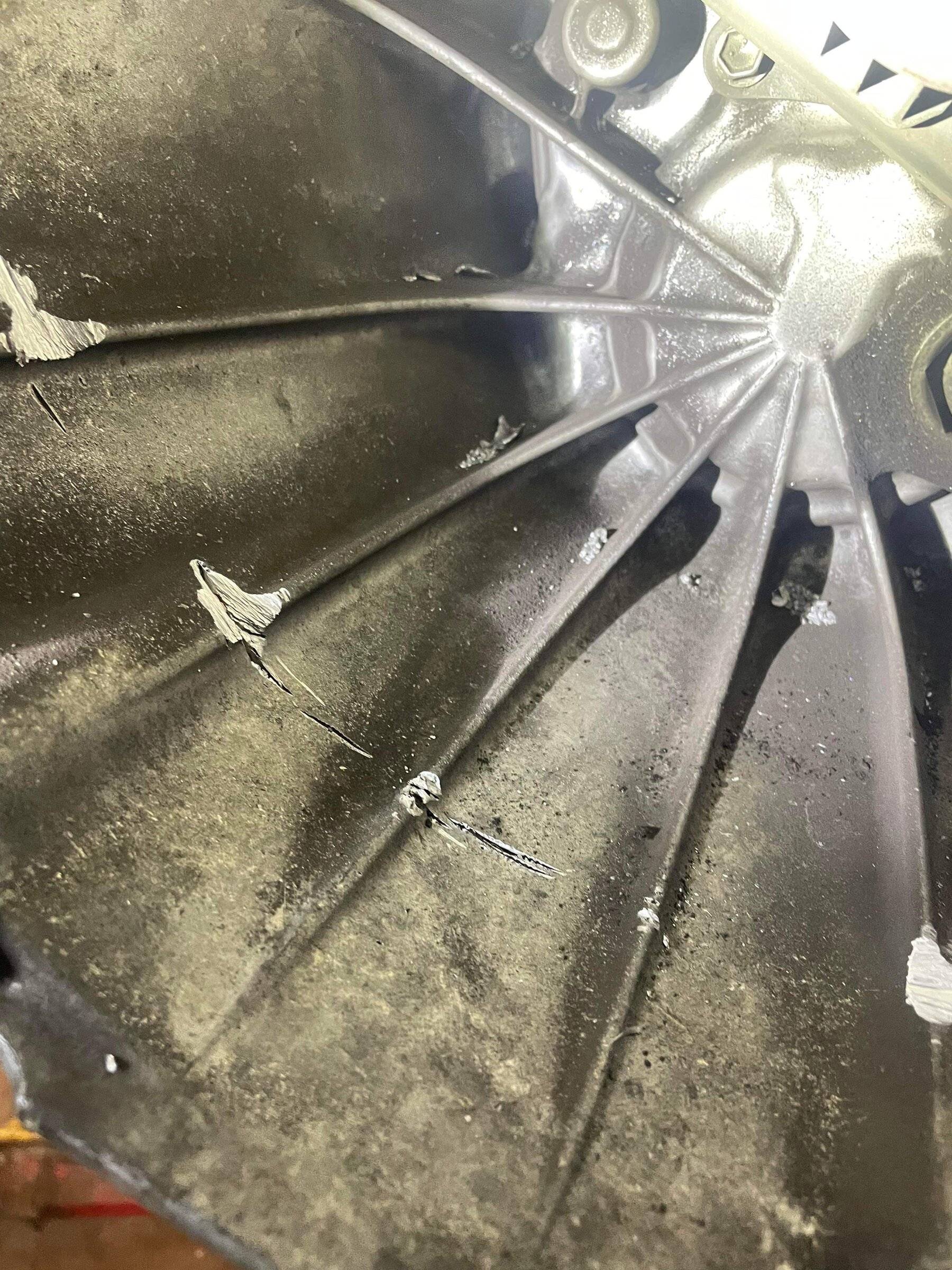

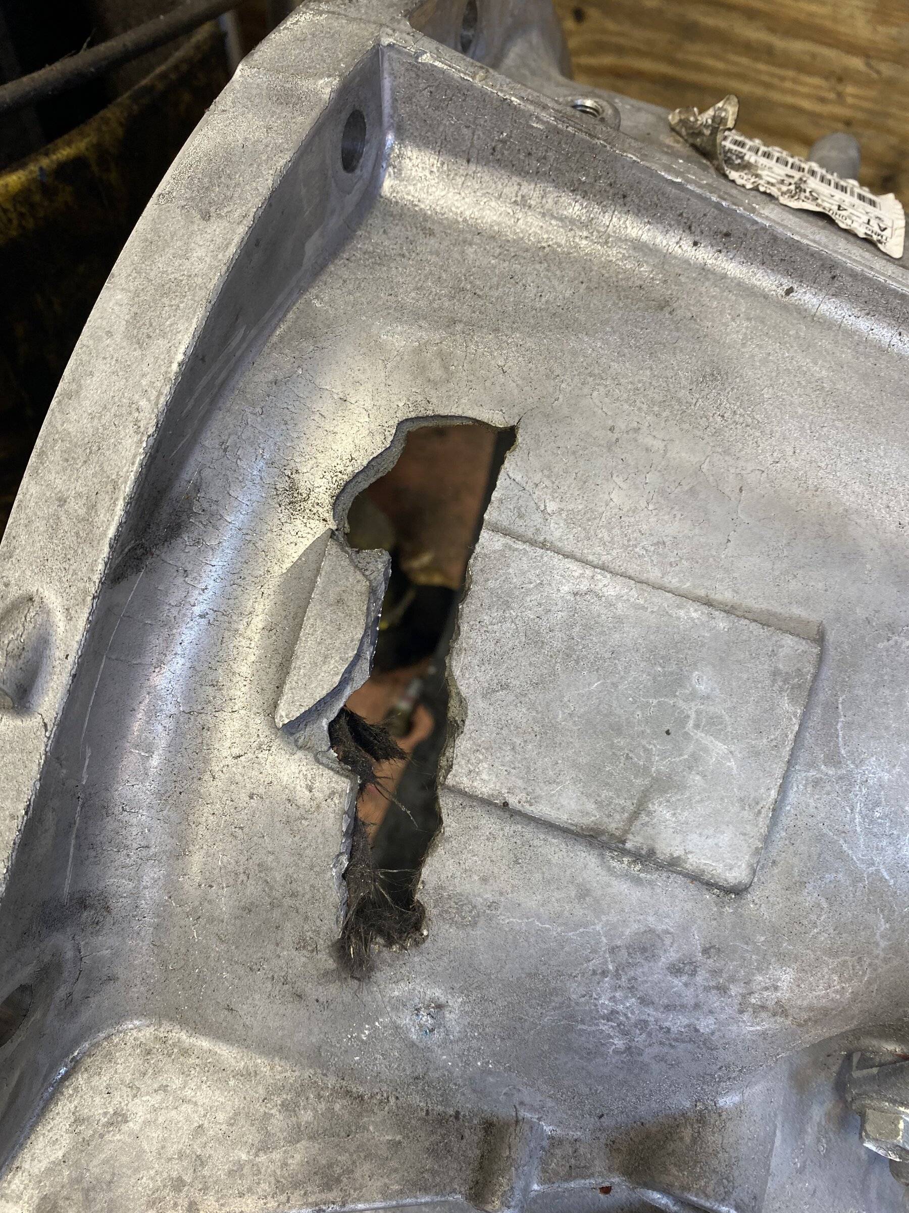

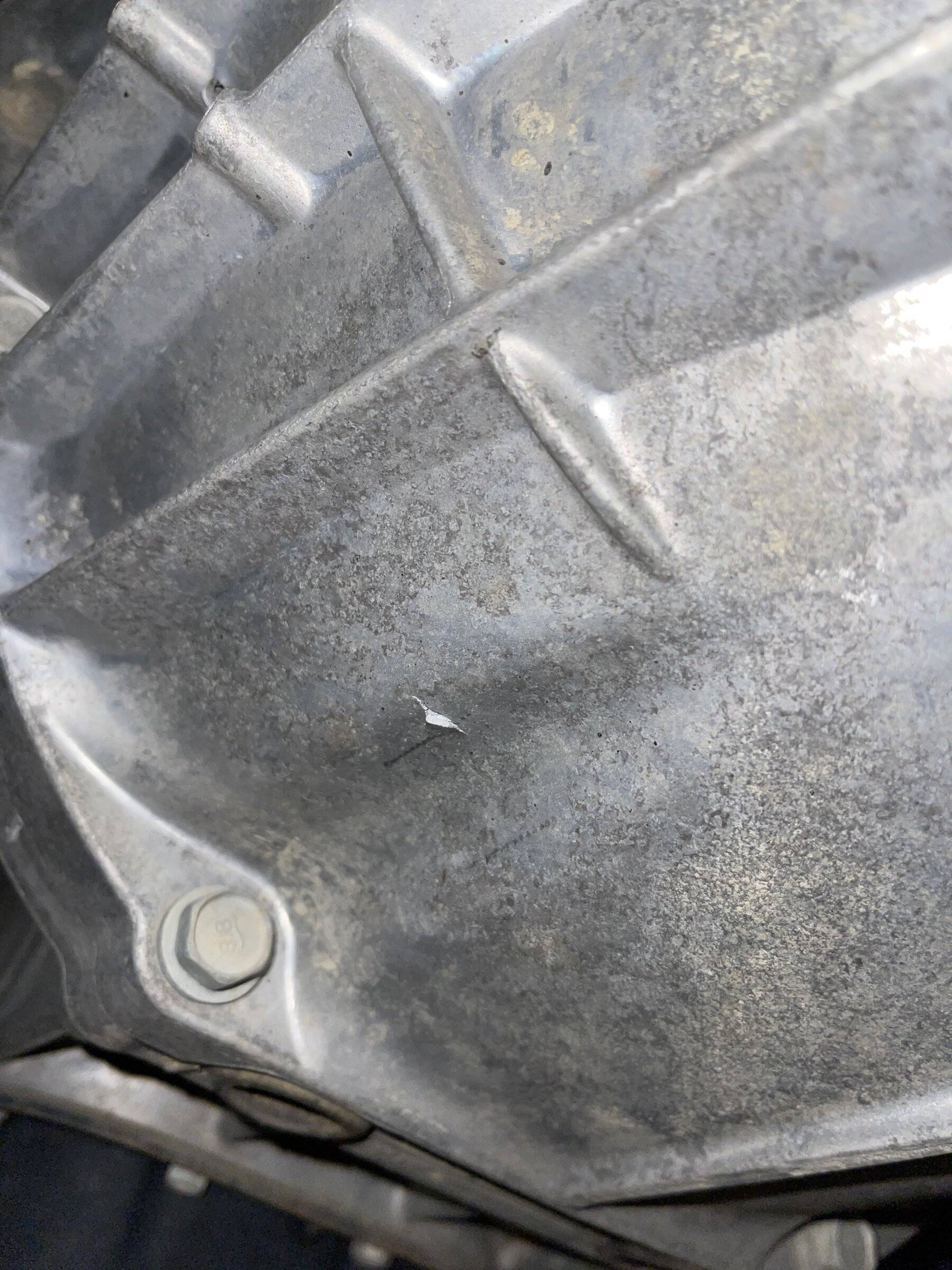

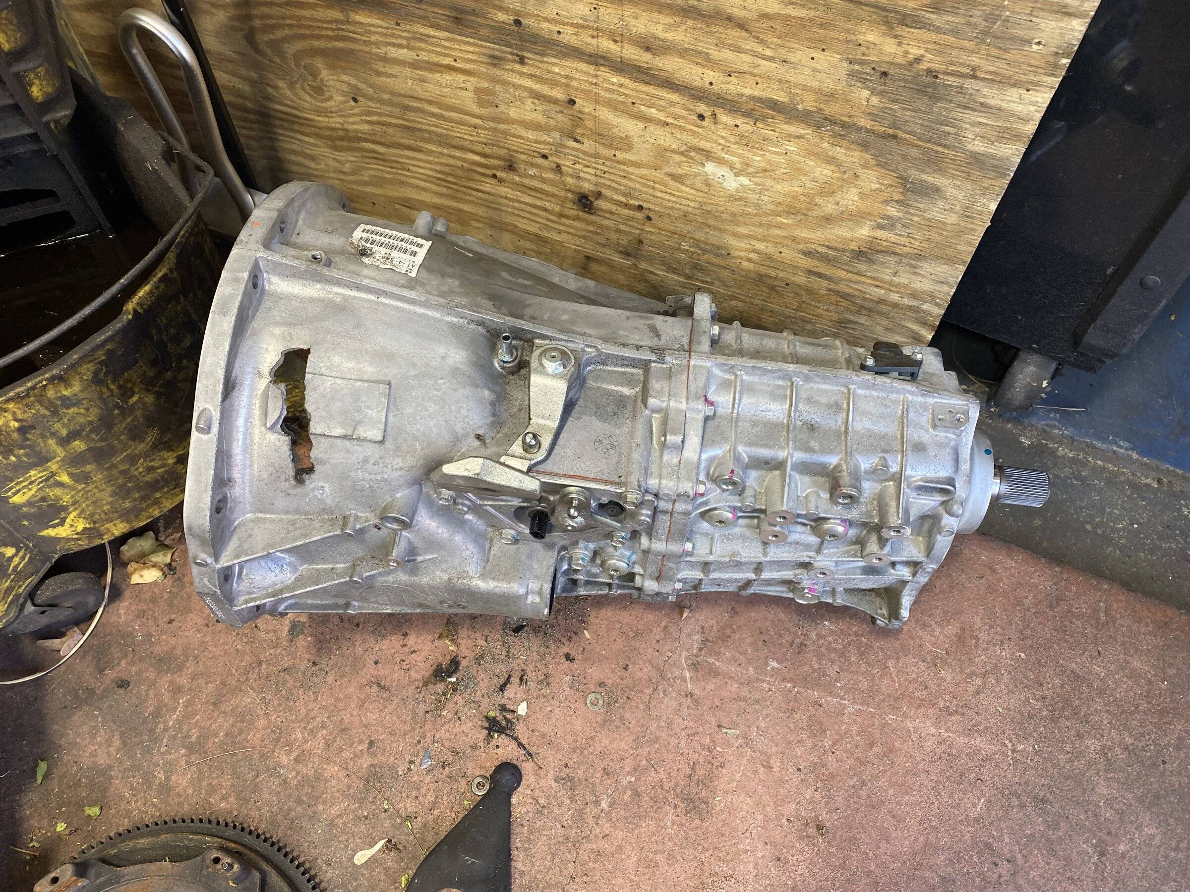

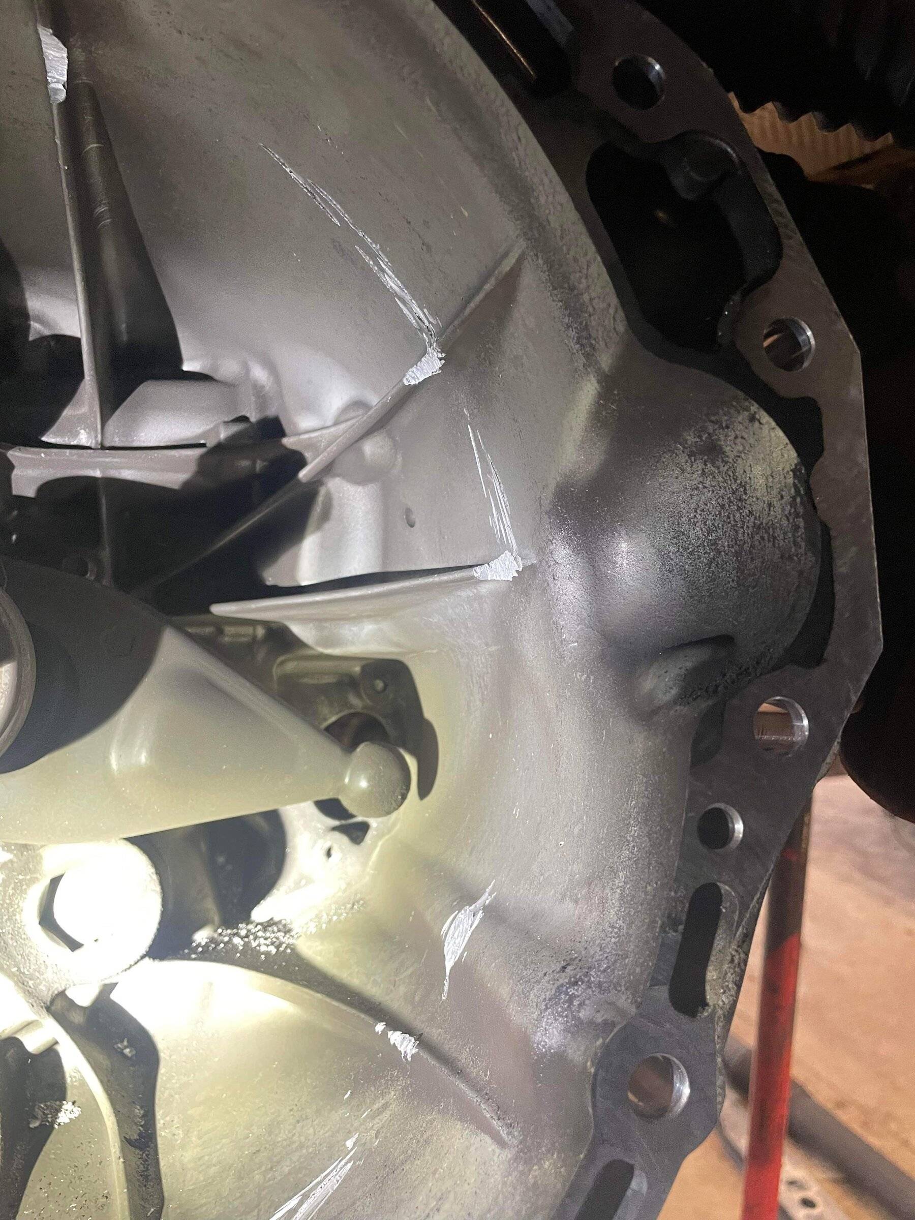

The recall is supposed to prevent overheating the clutch...I don't think it would have prevented your issue.
The recall is about pressure plate fracturing. Looks like that is exactly what happened here.
