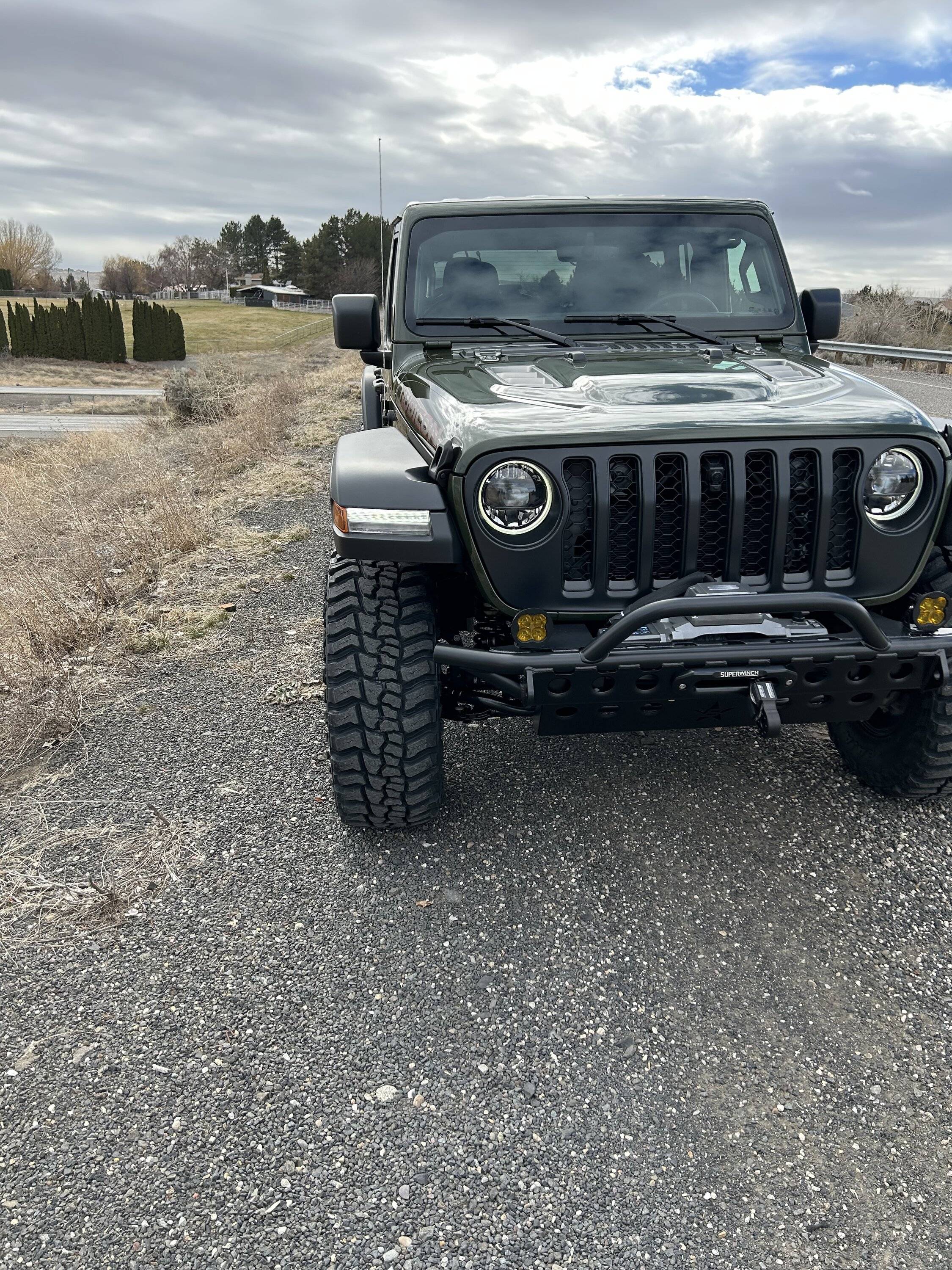

I just spent the first weekend running around on my Clayton 1.5 with Fox 2.0’s and real happy with it. Haven’t had time to get off road yet though.
Rides great on the road and highway, a little stiffer than stock but feels very sure footed.
I felt like mine was a little softer but that may be the difference in shocks. Also feel like it is difficult to tell, i have been driving my 1 ton a bit more with much firmer steering and ride. Moving from vehicle to vehicle and making changes makes some of the minor differences difficult to feel.

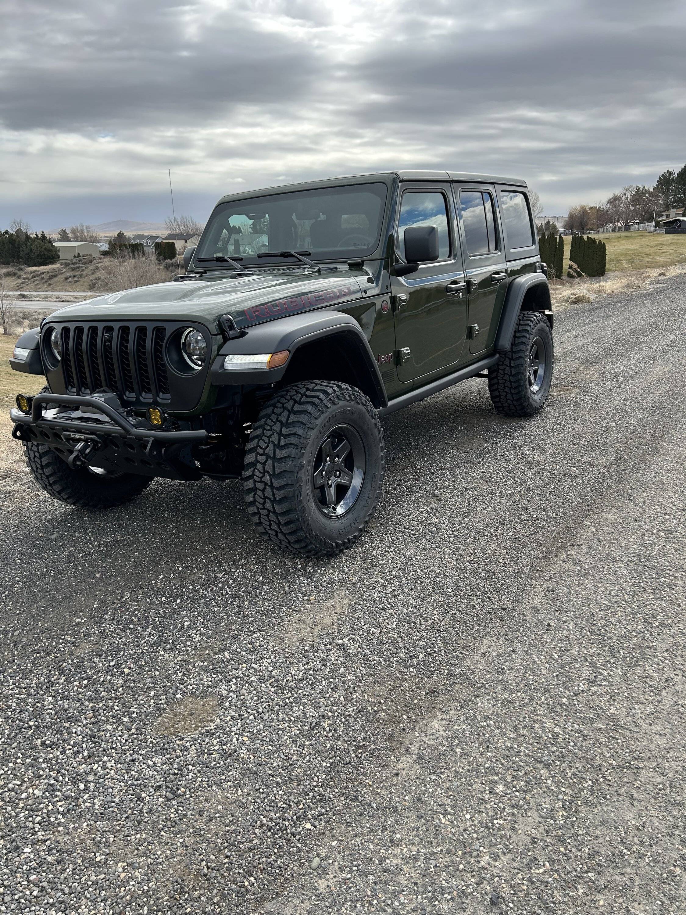

Clayton recommends the Fox 2.0’s for 2 to 3 inches of lift and that’s what I used.
At full droop my springs were firmly in the perches but then I also added 1/2 inch spacers because I thought I might need a little more lift. I believe that without the spacers, the springs will still be retained properly.
Ultimately I got more lift than I thought I would and am now on the fence as to whether I will leave them or take them out.

Thats a pretty good look, might be a bit better without the spacers but not necessary.
Really like the Salta's

Looks great! it will settle a bit more and then if you have steel bumper and winch in the plan, then you are better off keeping the 1/2" pucks.
Part of the reason why you have the feeling that you got more lift is because you also moved to the high clearance rubicon fender (I didnt do that). I have the same lift with fox shocks, I added the 1/2" teraflex spacers on all 4 corners. The front needed it and was evident after bumper+winch - I lost about 1/2" of clearance. I contemplated removing them on the rear, but when im fully loaded for camping, I dont have the reverse rake and it stays level. I loved that, so hence left all the spacers in there. When not loaded the forward rake is a good thing and helps with on-road (as intended from factory).

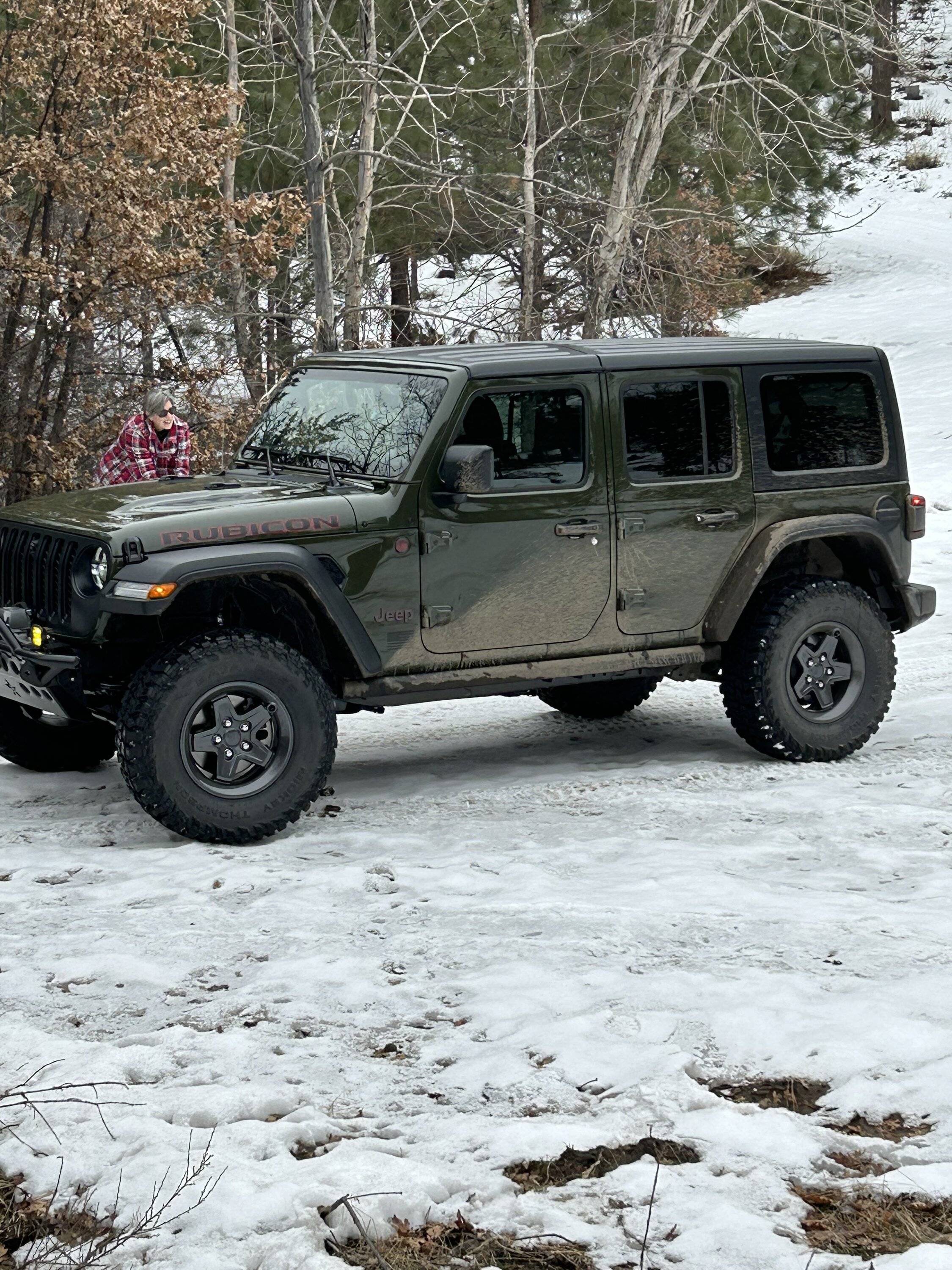

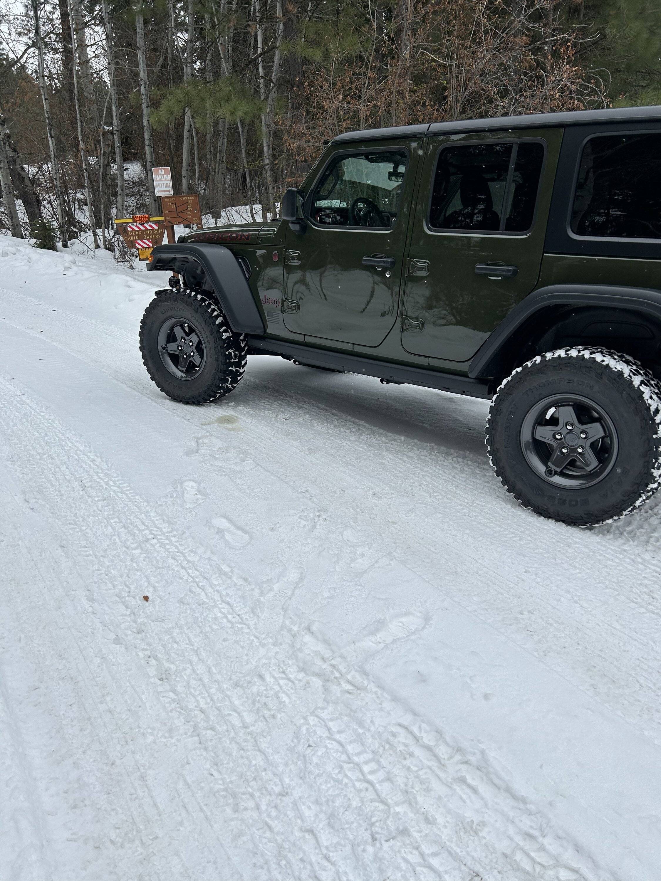

Bit of a follow up, spent some time on the Highway and did a bit of off-road in the snow. Not sure I could be happier at this point. Ride is great, Jeep tracks well and very solid at speed. I do have the new wheels and tire and feel like I have a great balance of tire in the wheel well. At this time I would recommend this set up.
