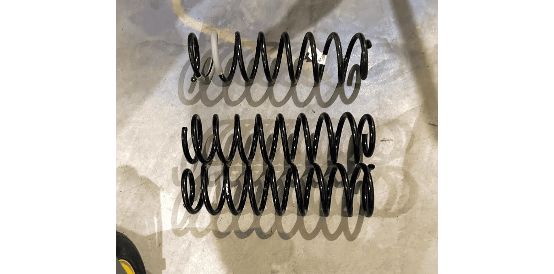

Decided to go with the Clayton 1 1/2" springs for a very modest lift to fit 35" tires and still leave a bit of space. Going to try it with stock shocks but will be adding Metalcloak front and rear adjustable track bars and there bump stops. Also using the longer Mopar front lower control arms. attached is a picture of the Clayton and stock springs, the Clayton are the 2 on the bottom. Was a little surprised that they are the same length, Clayton says you will get the lift from spring rate. Should finish up front today, doing a bit at a time.

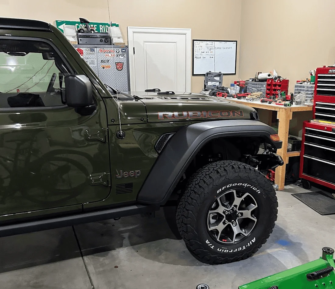

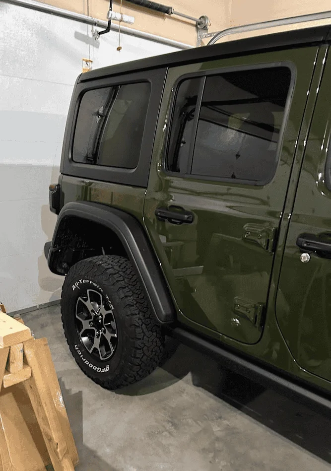

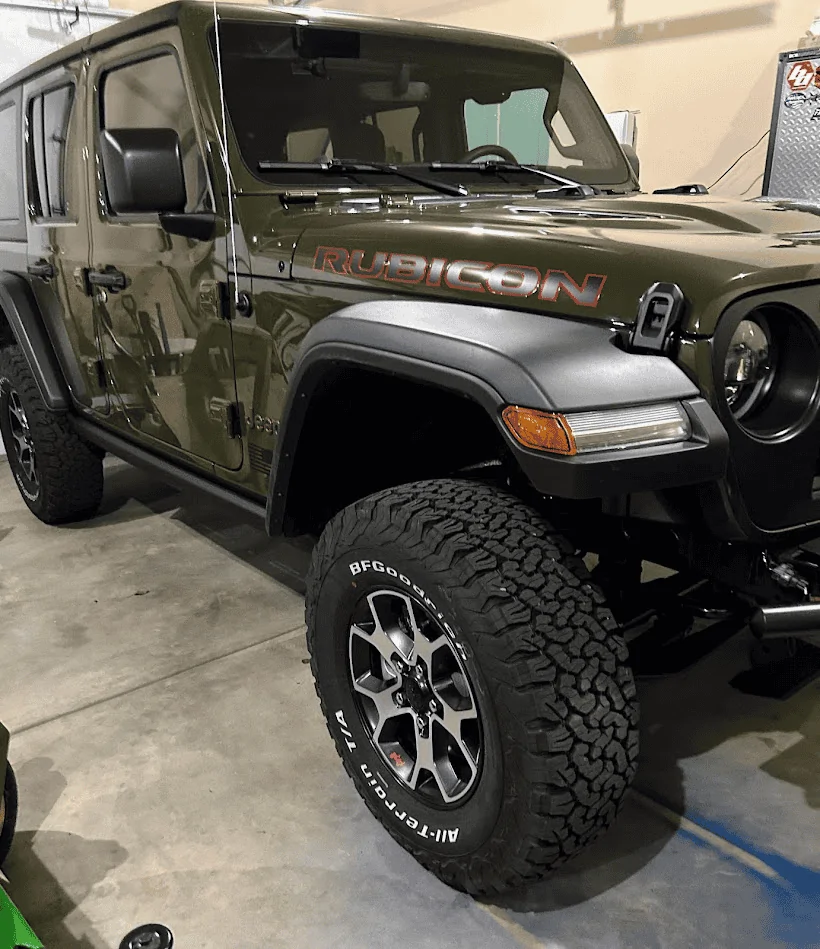

finished the install today. Lift consists of Clayton 1 1/2" springs, stock shocks, Metalcloak front and rear adjustable track bars, and Mopar longer front lower control arms. Pictures are with stock 33" tire, trying to decide which 35s to go with. I did net 1 1/2 inches.

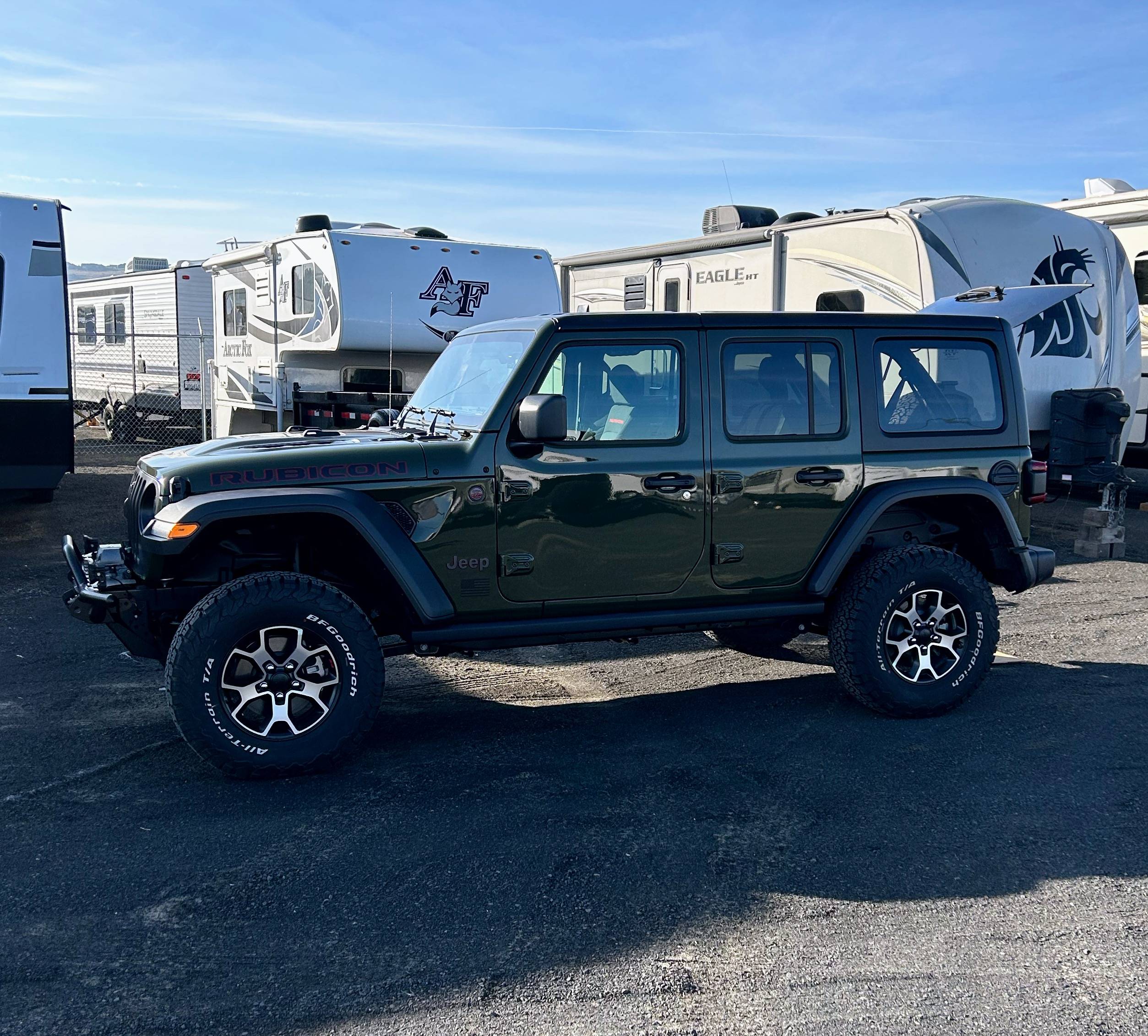

Drove a little more today and am pretty impressed. The ride is outstanding, maybe a little more roll in faster corners but really seems to soak up the bumps. I may try stretching it out a bit to see if shocks will actually work but they seem fine for now. Jeep still fairly centered, didn't need to adjust track bars much and steering wheel is still almost spot on. If you only need a minimal lift I would definitely recommend at this point. I think it looks ok with the 33" tires but the 35" should look perfect.
Clayton 1 1/2 inch springs front and rear
Metalcloak correction pads front
Metalcloak bumpstops, only put in one puck
