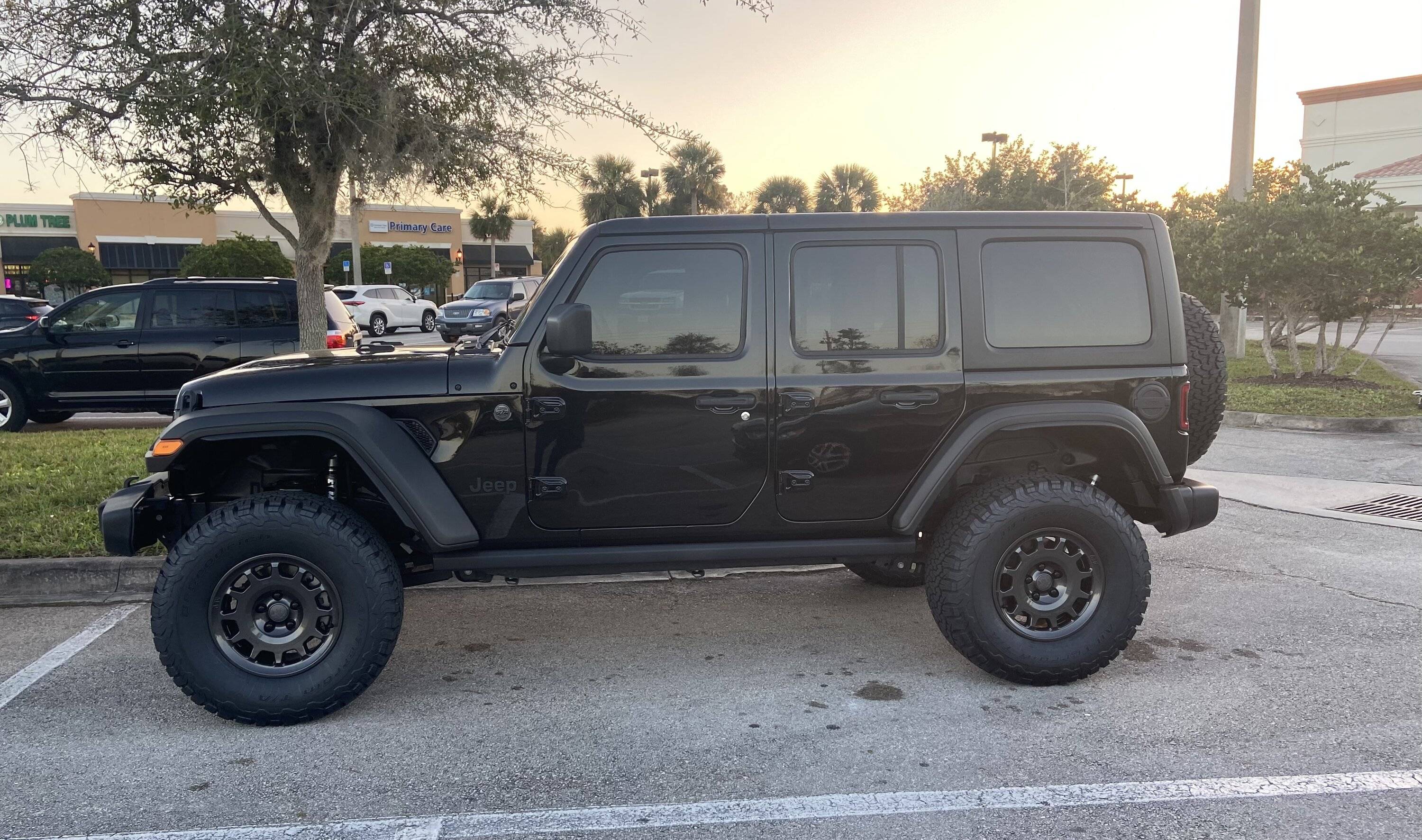

hey man I’m thinking of the ride rite 1.5” kit they sell. I can always upgrade later to overland. Anyways, I’m in a 2021 JLU Willy’s with the Rubi shocks and sport springs. I understand this kit gives non-rubicons more like 2-2.5” of lift? I’m sticking with 33s so don’t want too much lift. Also, what size fox shocks? The kit says 1.5” lift but Insaw you said 2-3” versions?

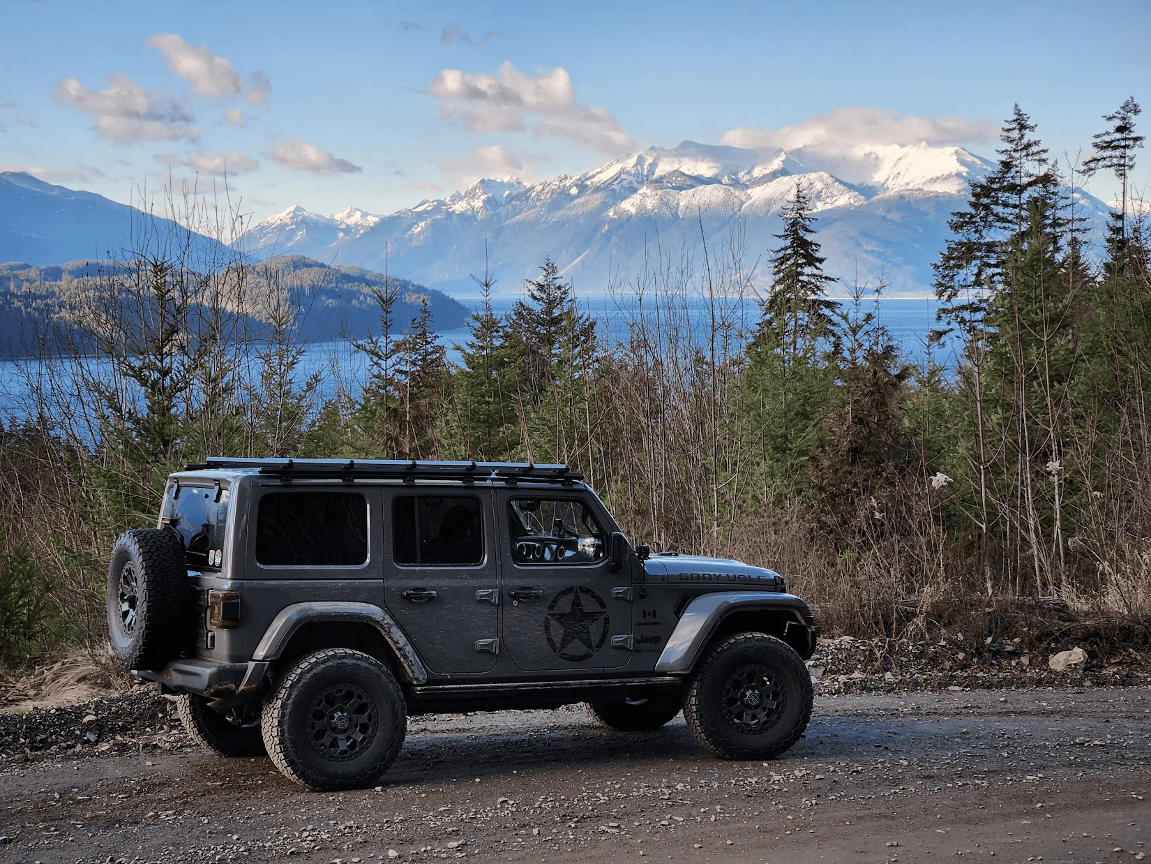

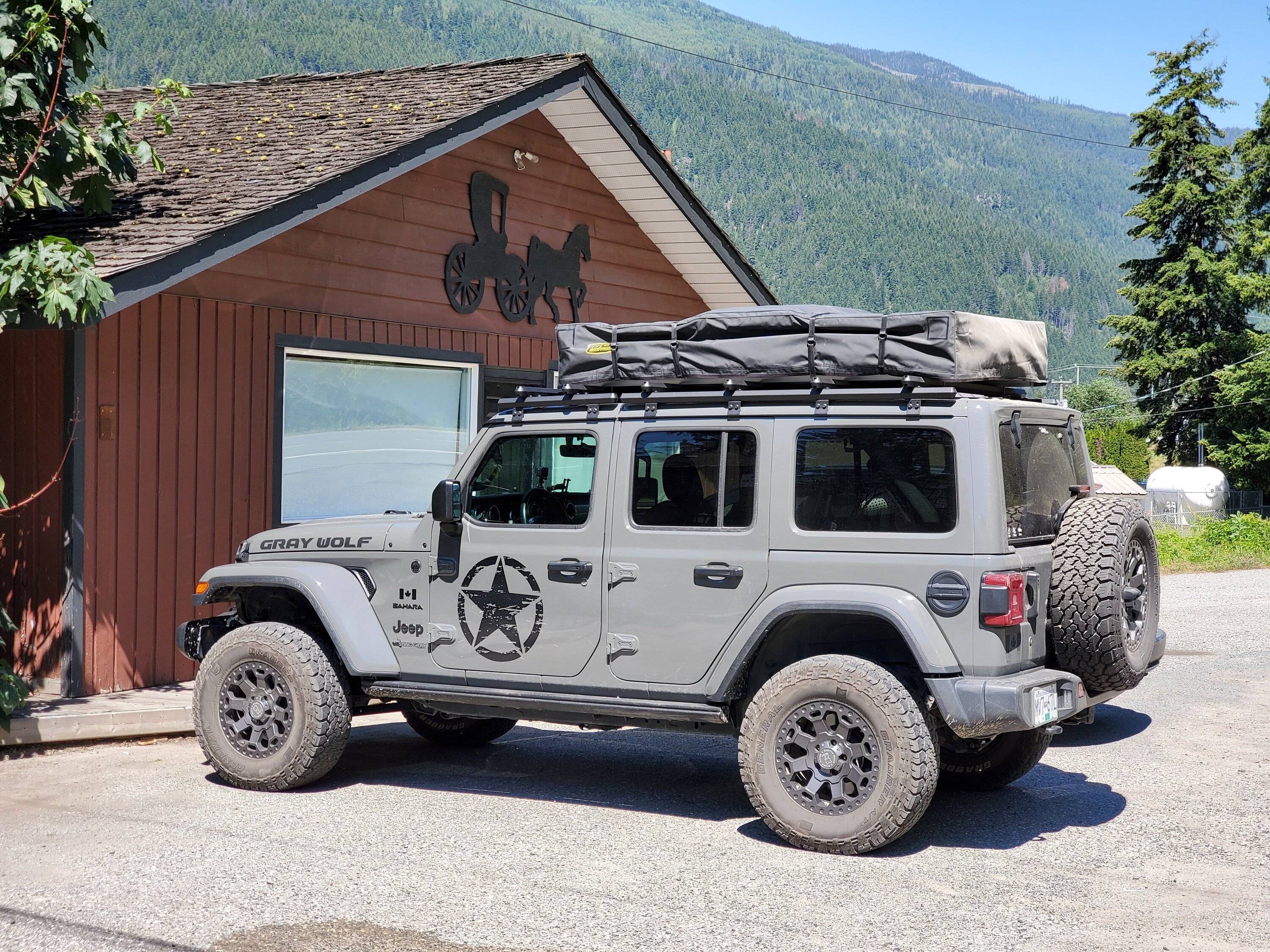

Here's a picture of my previous Jeep on Clayton 1.5 coils, 0.5" spacers on all 4 corners, still on 33s general grabber atx. If you feel that's a bit much on tire to fender gap, then skip the spacer.. If not put on the spacers.

On 35s (KO2 they run a bit small and light)

Thanks for this big reply, very helpful. Your rig looks great with both tire sizes. I have a couple questions for you or anyone that can help, if you don't mind:
1) Do I need anything else other than the ride right kit and new shocks? Bumpstops or anything? I'm just gonna run the 33's for now. I also have the lower mopar LCAs since I was going to go a spacer route but since changed my mind. Would adding those make sense, or should I just return them?
2) Can I use my existing willys moab wheels? Same specs as the rubi wheels. Only running 33s, but I hear that some people need 4.75 BS on some lift kits. Never really understood why...
3) Shocks- I'm already spending $600 for the install from a reputable jeep shop. So with the $1500 kit I'm already at $2100 parts and labor. $2000 WAS my limit lol. Can I run billy 5100s and still enjoy this setup? Or should I really spring for the fox 2.0s?
4) My willys came with the soft top from the factory, which equals softer springs. But I've since added a hard top. This slightly sagged the rear. However, Since I'll have a whole new suspension setup including the springs this should be nullified, correct? Sort of like starting over, so to speak.
Much appreciated!
