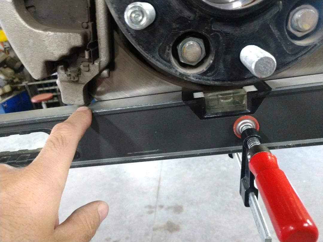

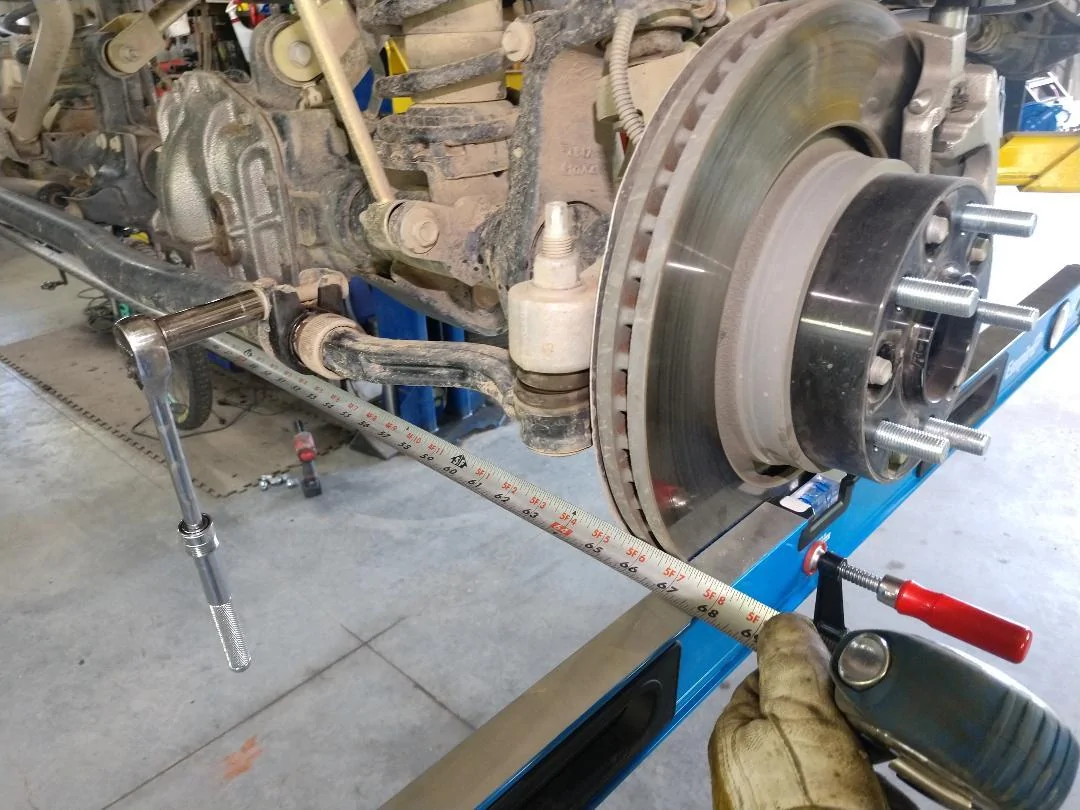

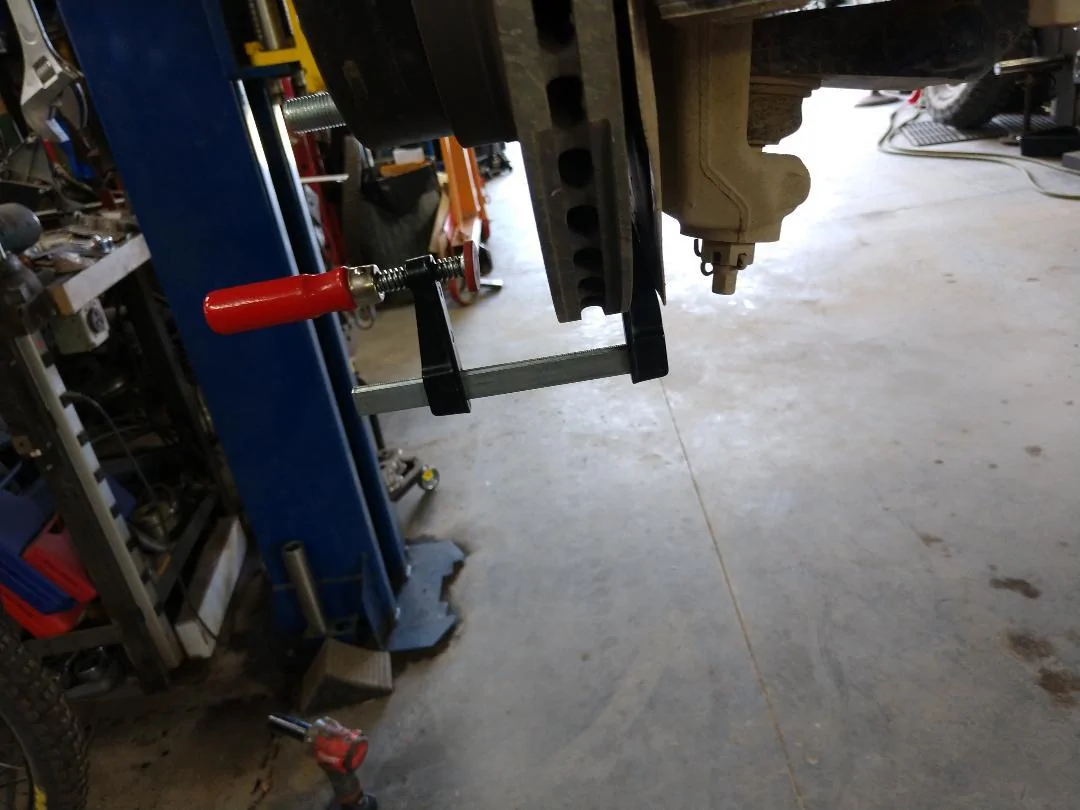

I checked the toe on my JL today. I'm personally not down with trying to measure off the tires, I dunno how you'd ever accurately hold 1/16", but whatever works for you.
First, I've got these cheap little Bessey clamps. I use them to hold fragile materials to angle plates at my mill, but clearly useful for lots of things. I found they wedge in nicely between the rotor stone shields. Normally I hate these shields and yank them, but I might leave these just for this reason. Having the clamps wedged in place just means I don't need three hands when I clamp my levels to my rotor.
Bump the levels up against the caliper mount (indicated by finger) and level the bubbles. Now you've got two straight edges from which to measure at the same height relative to axle CL and running at the same angle.
Then just bump your tape up against front edge of rotor on the front or caliper mount on rear and measure.
NOTE if you don't have wheel spacers like me you'll want to run a few lugnuts back on to keep the rotor up against the wheel bearing. Use washers as spacers if you think your lugs will penetrate the acorn cap of your nuts [insert Beavis laugh]

Damn, I guess the tire shops can get rid of those exlensive machine they use.

If you want your alignment specs to be accurate you should be measuring it in degrees and not inches. Depending on how far you take your measurements from the center of the wheel will change the actual toe measurement. 1/8" on a 32" tire is not the same as 1/8" on 37" tires, and certainly not the same as a measurement taken just outside of the rotor.
This calculator will let you input the distance between your measurement points and then convert your measurements to degrees.
https://robrobinette.com/ConvertToeInchesToDegrees.htm
THE OP's method of clamping to the rotor combined with the above calculator is the most accurate way to measure your toe and communicate your alignment specs to other jeepers.
