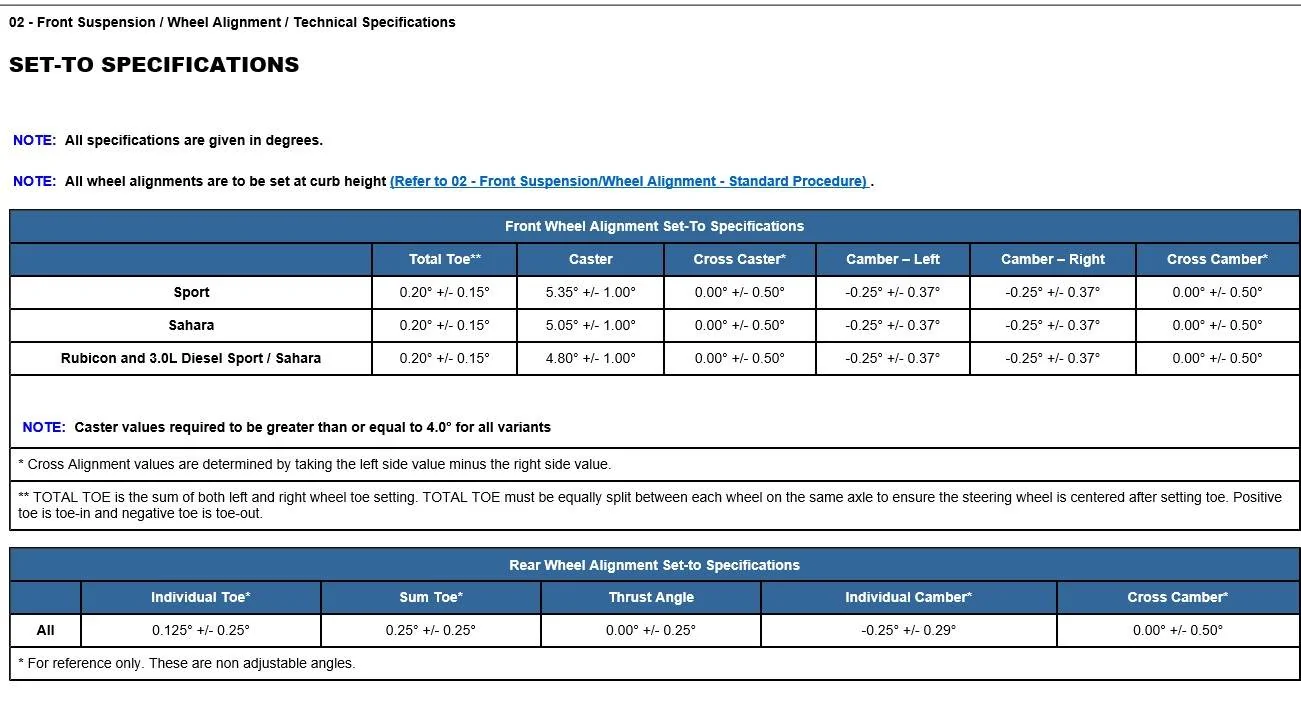

There are no common passenger vehicles that I'm aware of that have toe-out as the OEM recommended alignment. Toe-out will make it wander. Your experience with the alignment you had done tells me that something is loose in your steering system. You cannot accurately set alignment if a steering component is loose/worn. It's likely balljoints, since they are the weak sauce in the JL. But it could be, tierod ends, draglink ends, steering box, or the trackbar (bushings) or some combination of them. I've had a Steersmarts Yeti Pro trackbar in my JLUR for 5 years and it was moving around a bit on the highway and had a little shimmy here and there on some bumps. I changed the old poly bushings for new last week, and all was fixed. The OEM steering, trackbar, and balljoints on the JL are weak. I replaced all of those with high quality aftermarket and upgraded to the iron steering box. It drives like it should, with 37" tires. I can cruise comfortably with one hand at 80 mph.
The Tech Authority Service Manual (OEM) that I have shows the toe alignment spec as 0.20 degrees of toe-in.
