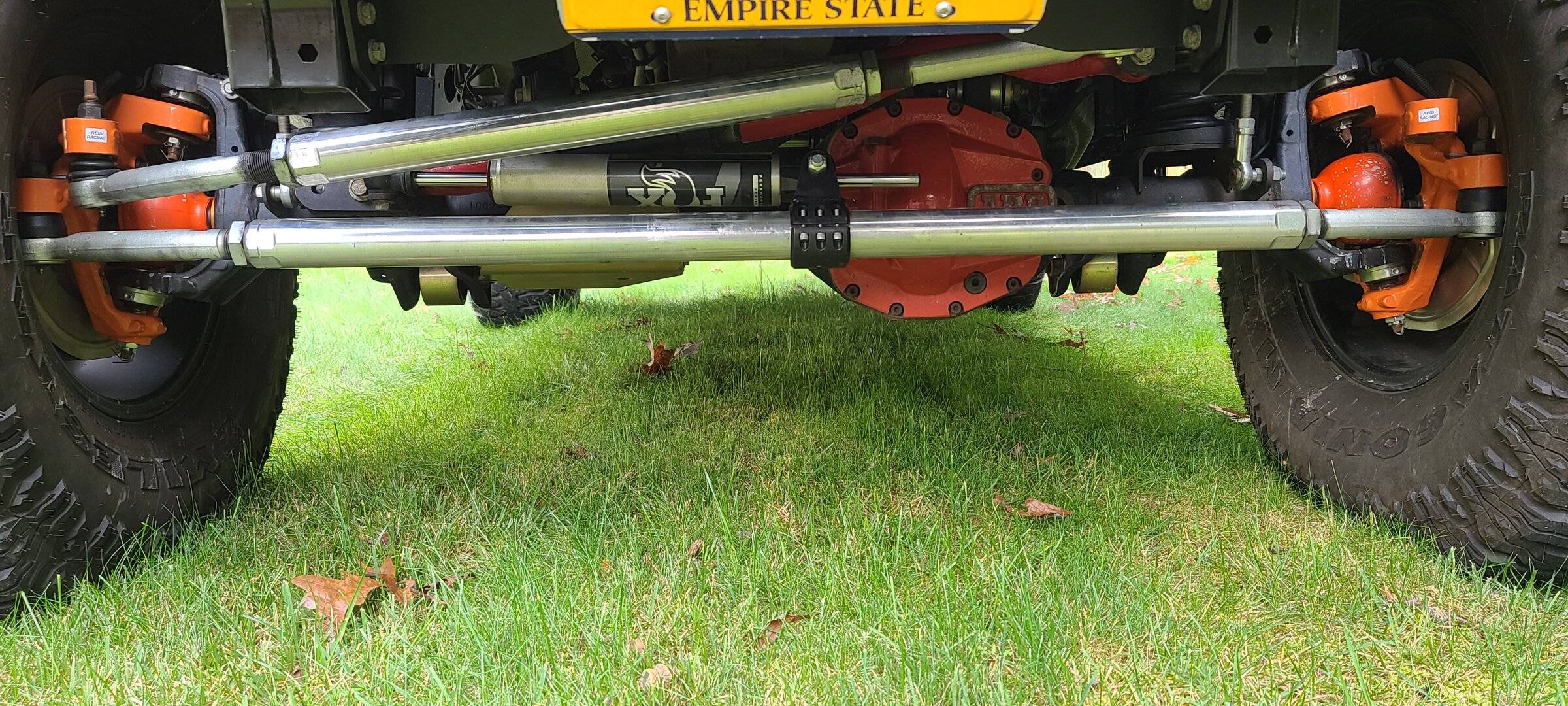

I had a bad steering shimmy a while back with 1/8" toe-in. I took Roky's advice and 1/16" toe-in worked out great for my Jeep. That was both 35's and 38's with the SteerSmarts linkages, and now 40's with the RPM Performance linkages.

So I am getting ready to install Steer Smarts drag link and tie rod assembly on my 2021 Rubicon. Currently running 37’s with the Mopar lift.
My alignment settings are castor at 6.4 degrees and toe set at 1/8” toe in. Jeep drives really well and after 15,000 miles I have excellent tire wear (rotate every 4000 miles).
Steer Smarts recommends 1/8” to 3/16” toe out.
I had seen videos recommending toe in because 37’s being so large and heavy that they would naturally be forced outward while driving. I do my own alignments and when I get the Steer Smart parts I can try it both ways but was looking for others experiences and opinions.
