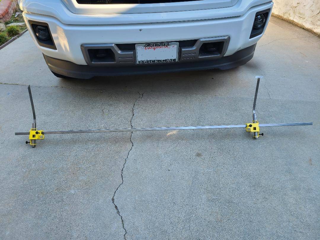

Toe measuring trammel.
Jeep Wrangler JL Toe in oh' Toe out trammel 1
Jeep Wrangler JL Toe in oh' Toe out trammel 2
Jeep Wrangler JL Toe in oh' Toe out trammel 3
roaniecowpony
Dec 4, 2018
200
13,364
21,540
Retired Engineer
How are you measuring the toe?
The only methods I (sort of) know are used on my old Willys and involves chalk lines on tires and measuring devices.
We're lucky with the JL. You can clamp a 2-3 ft long piece of angle aluminum extrusion (make sure it's straight) on the bottom portion of the brake rotor on each side and measure behind and in front of the rotor with a tape measure. With a straight axle, suspension droop doesn't matter.

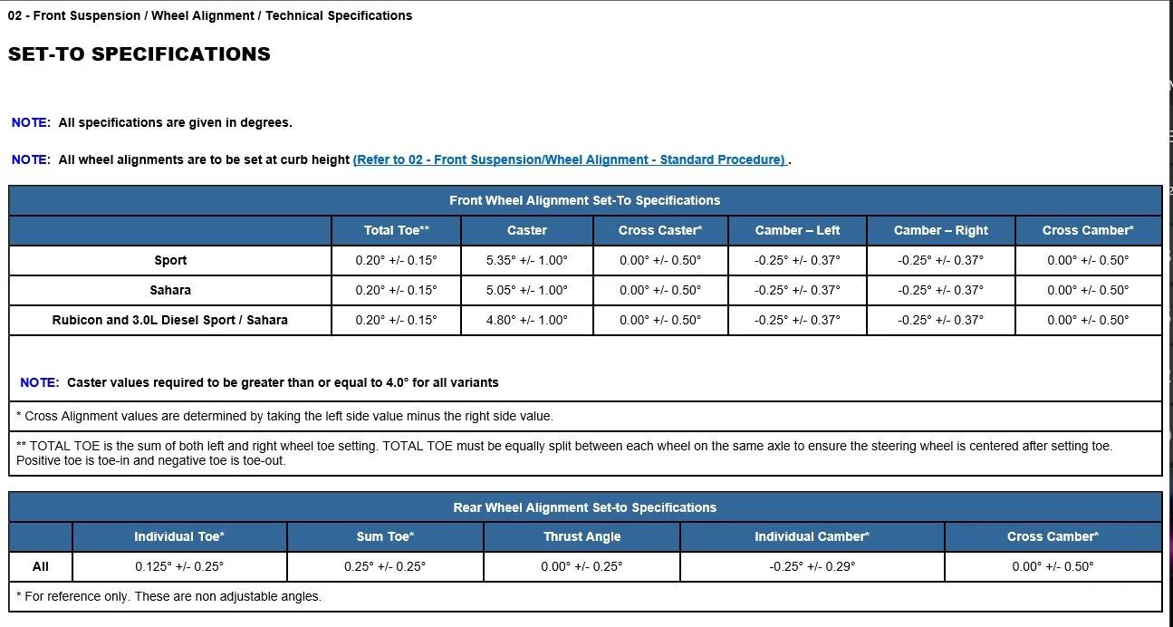

A man that knows his trig.
Here you go. Right from my FCA Tech Authority service manual.
Jeep Wrangler JL Toe in oh' Toe out Toe spec
For a 36" clamped on arm/beam/scribed tire diameter 0.20 degrees is 0.122" or about one RCH unit less than 1/8". The tolerance of +/- 0.15 degrees = +/- 0.092" or +/- 3/32".
So, with a 36" tire diameter, scribed all the way around or a 36" straight edge clamped on the hub/rotor, measuring front and rear, OEM specs translate to a range from 1/32" to 7/32" toe-in.

?. My 15yo Daughter literally did the math while I was doing the work exactly as described and we were .122. Trig is a wonderful thing!
