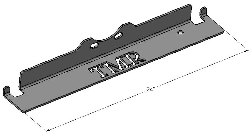

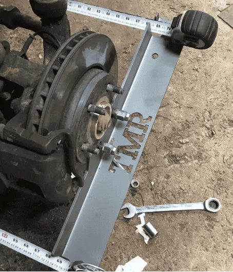

I also have the TMR Aligment tool... but I am curious now about the measurement of the toe... this tool is 24 inches in length
Jeep Wrangler JL Toe In or Toe Out 1657227941488
Jeep Wrangler JL Toe In or Toe Out 1657228394333
Toe is measured at the edges.. but... isn't the length of the tool an arbitrary length?.. I am asking because the tool length affects the Toe reading... imagine you use this tool that is 24'' in length and you read 1/8 Toe In... now.. install a new tool that is, let's say double the length at 48'' .. The new Toe In reading is certainly not going to be 1/8 but more than that... so... my point is that for a company to recommend a toe value for their products, are they basing the recommended value on a industry standard, or is it just... well... an arbitrary value based on their own methodology...

The way this tool is used.. the Toe measurement is the difference between the reading in the front and rear of the grooves on the tool .. here is a video

I believe the idea of using that alignment tool is flawed by design... I can come up with a similar tool that is 36 inches long, and while from the mathematical /scientific point of view is going to be more accurate, it will certainly produce results that differ from a 24 inch tool... unless 24 inch is an industry-standard (which I certainly doubt because alignment machines used by tire shops I am sure do not use those parameters) ... then I do not see a way for a tool bought online to match the results of a tire shop using modern machines) ... so... I think these tools made by BleepinJeep and TMR do work... but we will have to join forces and share results... I run 40 inch tires and I am going to use my tool in the coming days... I will share results... !!
That tool is far more accurate than guestimating on the tire. It's a linear function so it's easy to convert. I'm no fan of banned pony tail or Dynatrac marketing but you can see how they do it here.
So use the 24" tool and if you want to want 1/16" on a 37" tire
1/16*37/24 = ~ .096
At that point I'd use mm.
But I question 1/16" is perfect for 33" tires and 43s.
Edit:
Exactly, you want degrees, which is invariant to bar length, and the tool has the degrees to inches conversion so you don't have to do trig.
1/16*37/24 = ~ .096
Yeah.. I saw that video in the past... although it seems like a legitimate way to do it since you are comparing exactly the rear and the front of the tire.. for sure precise measurements like 1/16 of an inch using chalk and guesstimating the center of the tire certainly does not have enough precision... however!!! this whole mental exercise got me thinking.. if the TMR tool can be extended to be "exactly" the diameter of the tire then I think we would get a more realistic toe value as it would be like measuring on the tire but with a more precise tool and methodology ...
