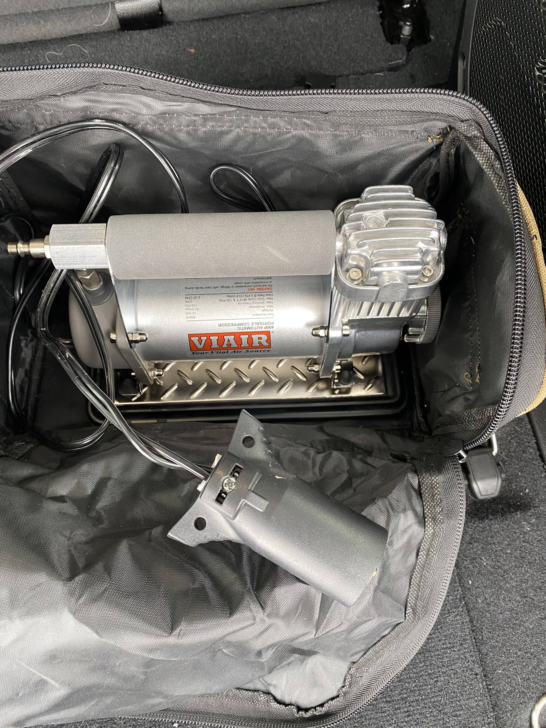

I used the Viair 400p automatic for a while. If you pick a 30A compressor you can do this instead of hooking up to the battery (so no hood popping).
Edit: assuming you have a 7-pin hookup.

Yes, I like the idea of modifying the electrical connector for use with the trailer connection but I like the idea of a dual compressor for 100 bucks more.
I want to run a 4 tire inflation hose system.
My rough plan is to use this method of installing a pressure switch and standard connector.
And to achieve the desired “no hood popping” feature I’ll try doing something like this
