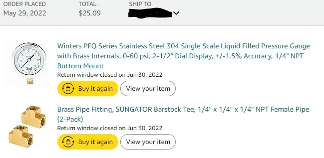

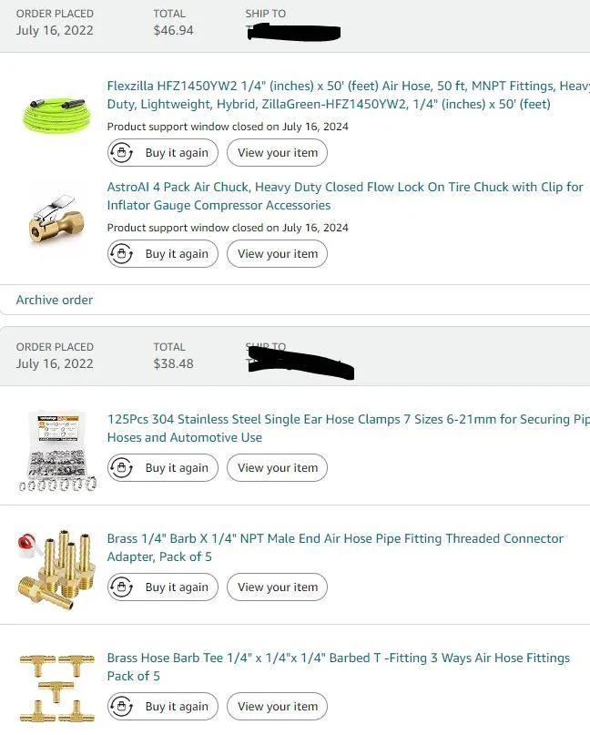

Sounds pretty good. So, I'm assuming you bought several hoses and "T" connections and assembled it with a gauge in the middle.
One hose and chopped it up. A good thing about DIY is you can custom fit it. I set mine up with the compressor by the battery. I did a guage with quick disconnects cause it's more bulky than the rest of the system.
This should be everything but the basic air QDs I had laying around:
Jeep Wrangler JL Air up/down all 4 compressor system. 1725895251235-zm
Jeep Wrangler JL Air up/down all 4 compressor system. 1725895284715-h7
I'm thinking the $100 didn't include the compressor.
Correct
