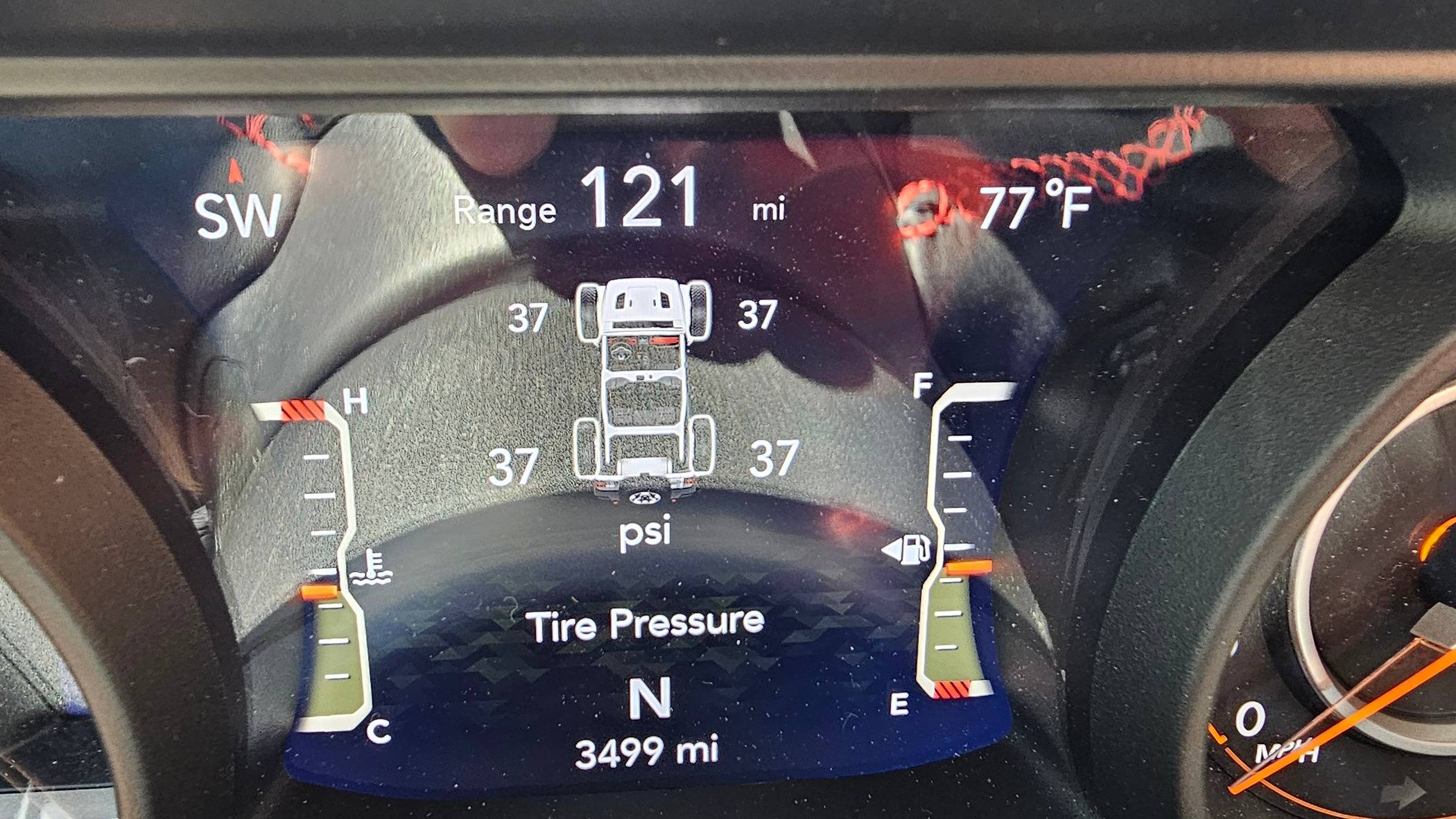

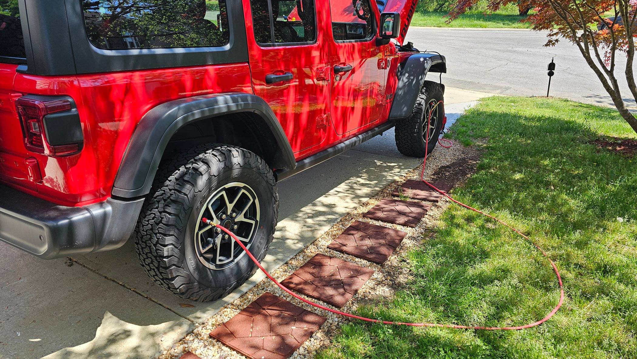

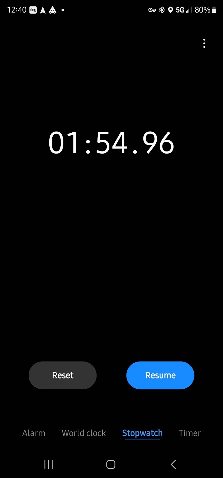

This thing is wicked fast. Hooked it up, aired down in the driveway to test it out. Got to 20 psi in a couple of minutes (didn't time it) and then aired up to factory 37 psi in just under 2 minutes. This will make quick work of prepping for the trails.

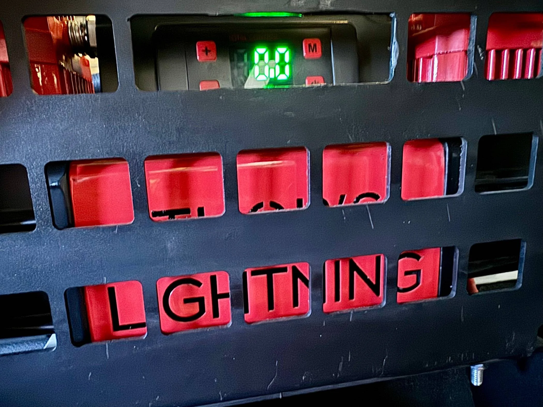

I have this system permanently mounted using the Thor mount to the rollbar on the JLU
Jeep Wrangler JL Thor's Lightning 4-tire air system 1713213618421-5o
Works really well and keeps it out of the way, but in this mount it's hard to get to the buttons. Also, this thing is power hungry so if you're going to an external battery keep in mind it draws ~90 amps. I had to put 2 x 50amph LiFePO4 batteries to keep up. Also, the hose coming out of the compressor gets really hot so if you do use the mount above, be careful that the hose doesn't rest against your soft top side window.
Overall very happy with it though - very quick fill-ups and so far no issues with speed or breakdowns.
I had the same issue with accessing the buttons and I solved it by using a cutoff wheel to remove two of the vertical bars - not need for strength. I also ordered their 12 volt quick disconnect kit to bring power from the engine bay to the compressor. Very well thought out and only $25. My last recommended upgrade are the Thor's Lightning Short Stem/APEX RPV Compatible Lock-On Air Chuck (Closed). I struggled the included Dynamo lock on chucks - and I hate struggling. I found the Dynamo chucks were a two handed operation which made attachment doable but I like the one handed aspect of the recommended chucks.
