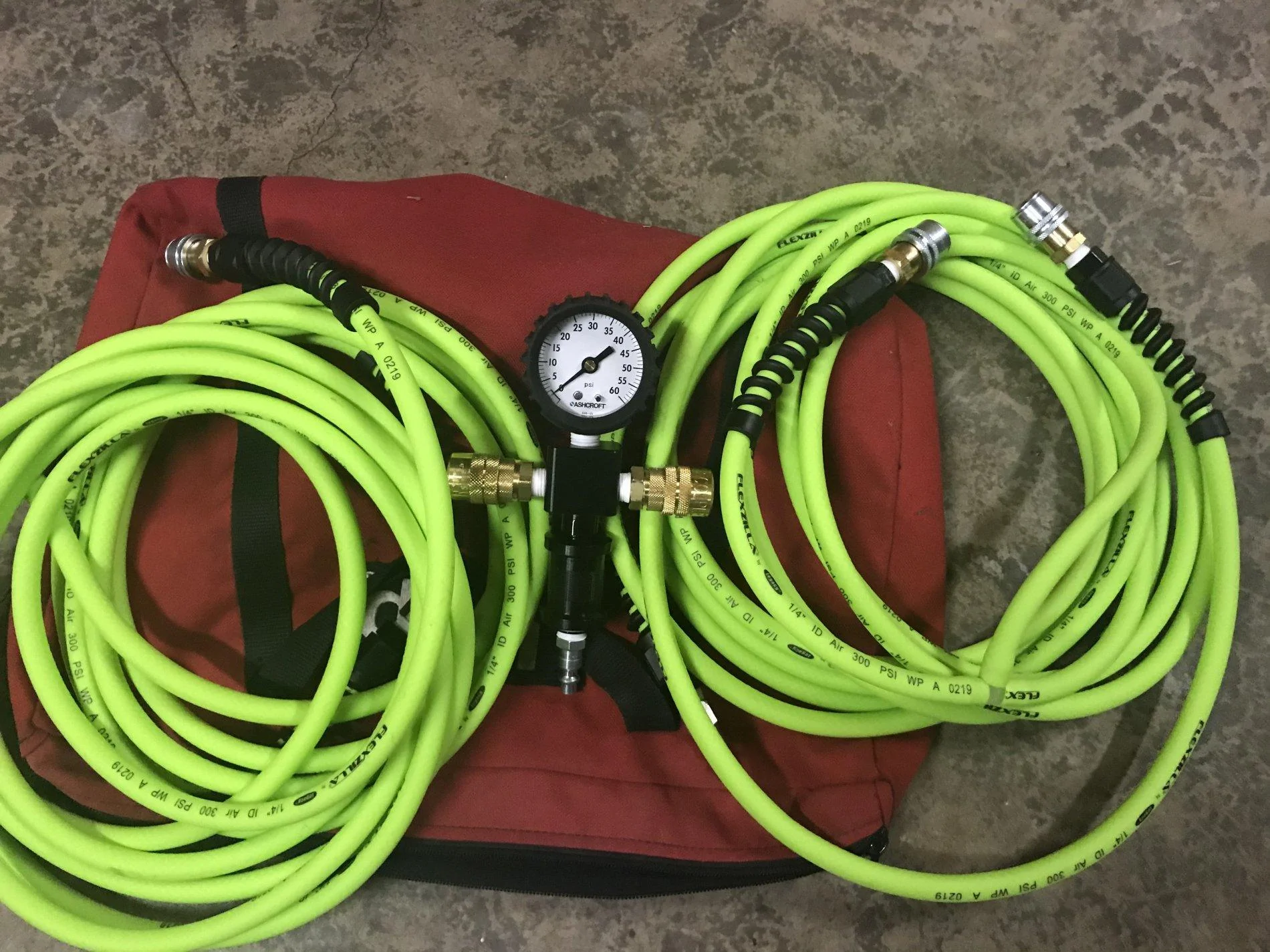

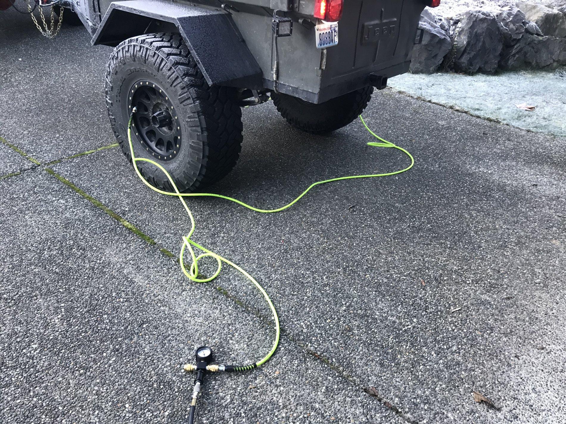

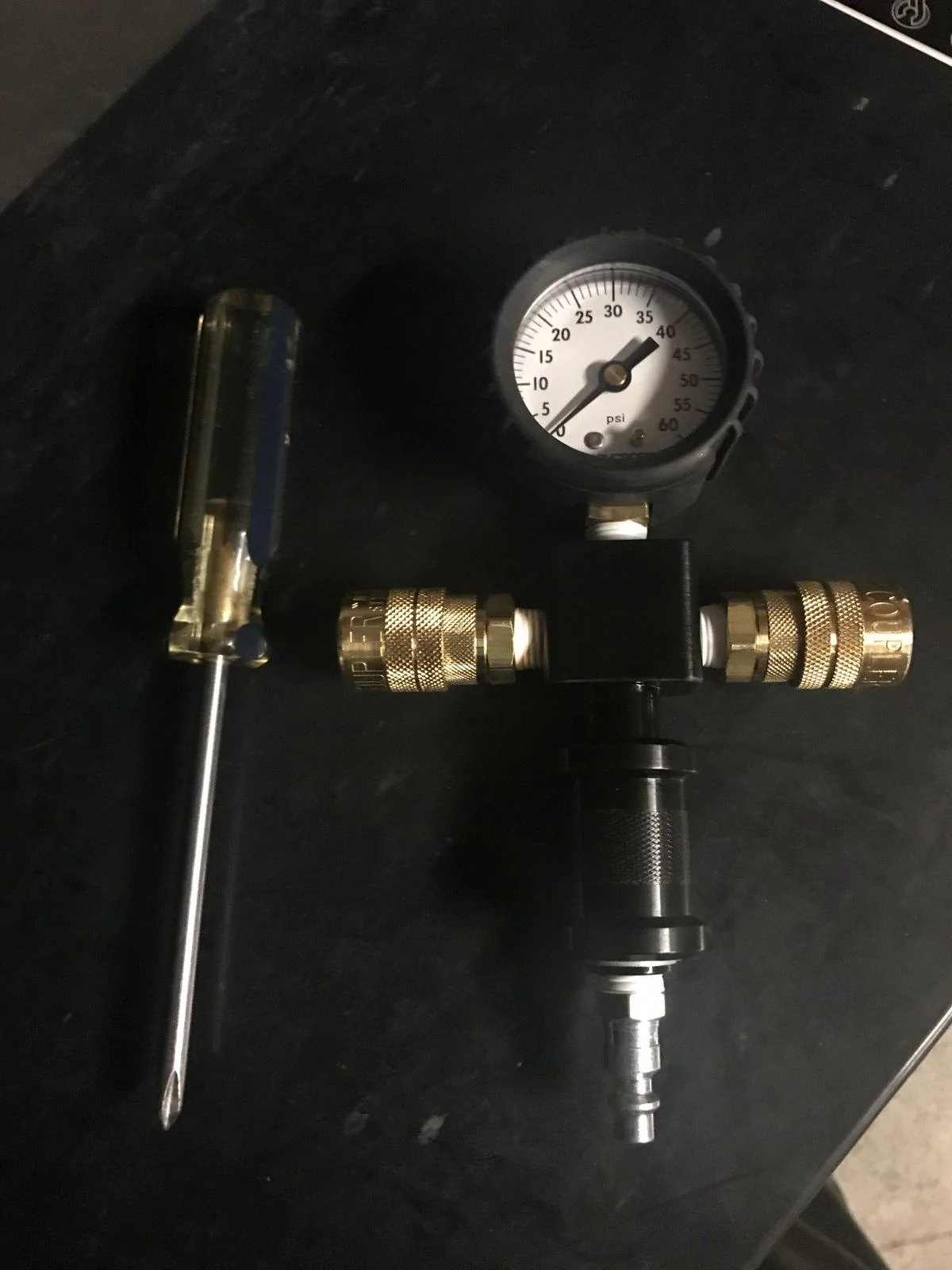

I designed something like that a couple years ago and never did anything with it. Wish I had. Mine is nicer (IMO) because I machined a slider value and all. Theirs is basically what I made to prove the concept would work. Down was OFF and up towards the gauge was ON. Timed myself and deflation and inflation was faster than ARB value core remover or doing individual tires by a couple minutes; which is a lot for something that only takes 8-10min to do.
