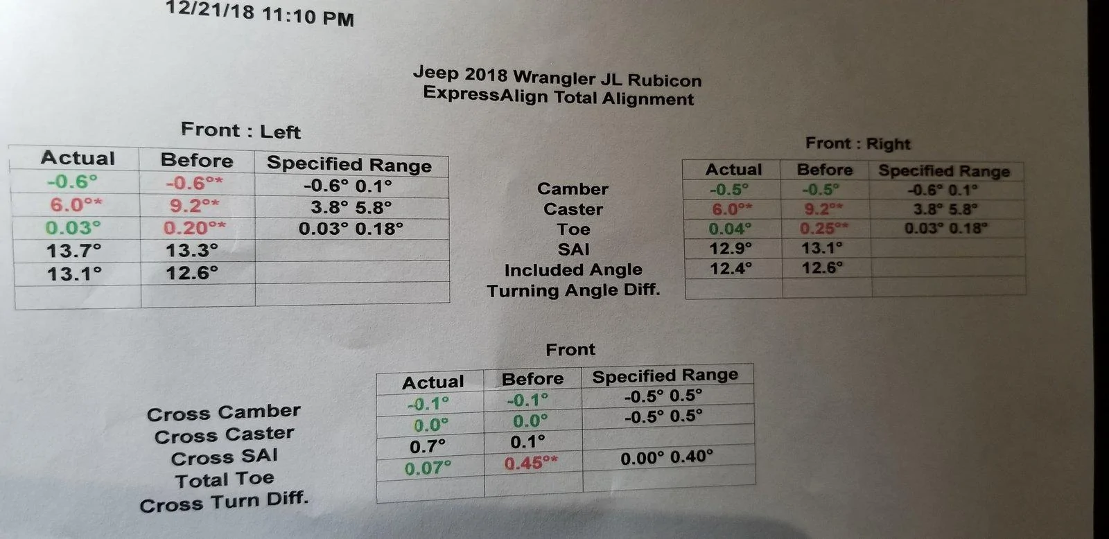

Sorry, didn't get the message in time to measure the angle of the axle for you before I left the shop. I have attached my measurements and changing my caster from a 9 to a 6 made a huge difference for me. Driving over the same potholes that i usually do and the steering wheel wobble is gone.

did you follow their control arm numbers or did you crank it some more afterwards?
I had a shop do my install so I couldn't tell you what specs they followed. But I was having steering wheel wobble and floaty steering shortly afterwards. I was told it was aligned when I picked it up, and for the most part, it handled just fine. But my symptoms got worse so I brought it to another shop to get the alignment checked. Those were the numbers you saw on my previous attachment. I also added a Falcon 2.2 steering stabilizer and tossed the Mopar one.....Wobble gone and steering feels tighter now.
