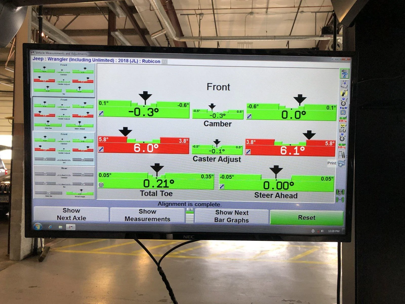

I ended up looking at [Banned Site] (I know, I know) and he recommended an angle of 92 or 88 depending on how your gauge is on that hole that I previously took a photo of. That changed my LCA length to just under 24 1/2" (Mopar springs) and I'll certainly be taking it to an alignment rack in a few days.No worries, the JL is still new so i think we are all learning the ins and outs of it. And in terms of the front driveshaft and pinion angle, it wont be too much of an issue in terms of vibration due to the FAD disengaging the front driveshaft. If you are using 4 hi a lot it might cause some vibrations.
Also remember that when you lift it you are changing caster and pinion angle. When you are adding back caster you are returning pinion angle back to stock or close to stock specifications, although the drive-line angle is changing.
