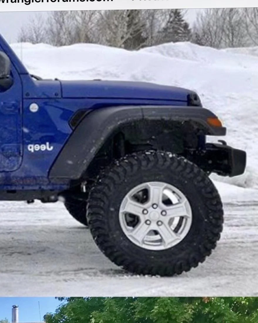

Since you asked for an opinion...... imho, technically it’s supposed to be the way to do it, but I don’t like the way the wheel looks in the wheel well if you just pull top arms in. When I install a lift I use both upper and lowers to set caster and keep the wheel centered as much as possible. Here’s an example. This is MC lift with adjustable upper and fixed lowers, caster set at 6 +/-. Now some will say that looks fine , I don’t care, but I don’t have that luxury with my ocd......:(..................:)

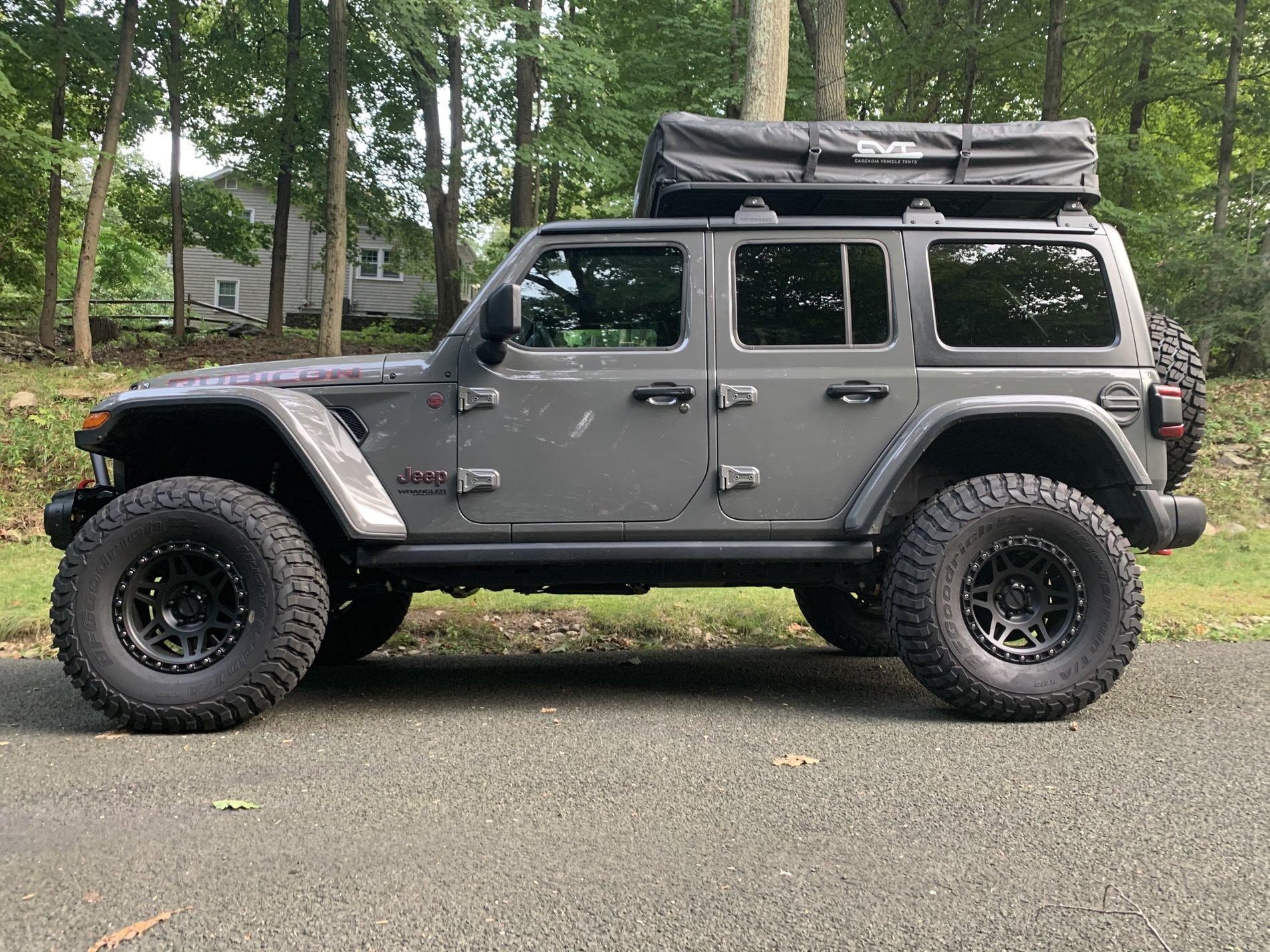

I definitely have the OCD. Haha. But that doesn't look bad. Here is what mine looks like currently at 4.5 caster.
Yep that’s where I like to see the wheel at 6 plus caster. I’d say try it. and if you don’t like it you can always fix it.....nice rig!

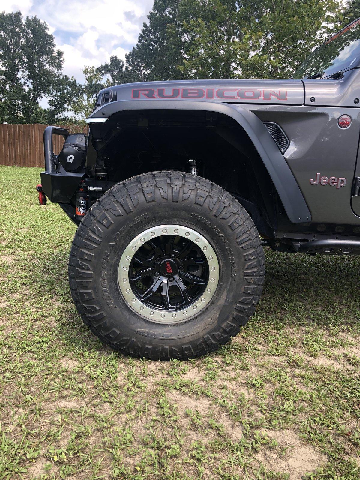

here’s 6.4 caster on mine.....
