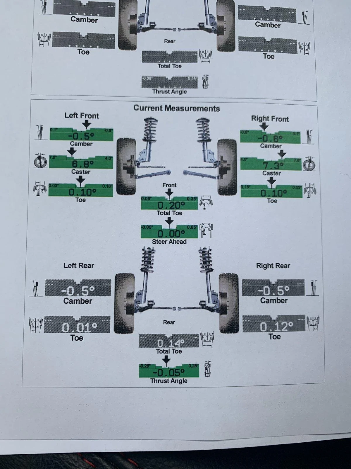

Got my caster adjusted today. Man does it drive so much better! These are my new specs. I asked them to get it at 6, but I said a little higher was ok. Is this too much caster now?

Mine's at 6 no problem. Lots of people reporting 7 or 7.5 is even better.
I wouldn’t go any higher but that should be fine as long as you keep your FAD operational. Switching to a one piece axle shaft could make it a problem. (Maybe)
Thanks! Any issue with it being a .5 difference from one side to the other?

As long as it drives straight I wouldn't worry too much. Setting them different can help offset the effects of road crown. Also manufacturing variances can cause discrepancies in the mounts, in the adjustment in the arms, etc. Its usually a little closer than .5 but again, if it drives nice it may not be worth the effort
