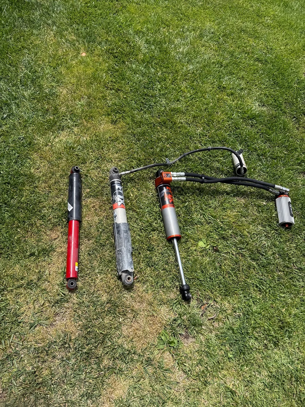

Jeep Wrangler JL BUILD PLAN, MAX UPTRAVEL HELP IMG_4468
With proper planning you can get a lot more bang for your buck than some weak shocks that are gonna make your passengers car sick

I saw your write up on the bumps, I was the one that derped on the bump stop lengths. What shocks are you running?
Edit: Found your shocks.
How much more could you have gone up if the shocks didn't stop you?
With one tire stuffed and hitting the fenderwell and the other tire fully dropped down... 4 inches with 35" tires. Shock doesn't make a difference for me in this situation.
Now if both tires were going up evenly it would be just over 7 inches.
But my shocks limit me to 4" up. 2" free, and then 2" with the hydraulic bumpstop.
So if your shocks were an inch shorter you'd still have fender clearance with the springs and bumps out and the other side fully drooped? Your shocks should be 16.8" compressed and my goal is to run shocks that are 15.87" compressed.
The front of my Jeep uses the factory XR springs and a half-inch TF spacer. With the axle crossed (one tire stuffed, one dangling) when the up axle went up 4" the tire was rubbing the inside fenderwell. Shocks or bumpstops here made no difference. And my bumpstop fully compresses at 4", so I can go up 4".
When I put the half-inch spacer up front, the factory red XR shocks were pretty much fully extended. So I had minimal axle droop. I did some research, and figured the Fox 2.0 IFP shocks for a 2 to 3 inch lift would have enough compression, and give me more droop so if off-road, my tires should be contacting the ground at all times. And I wasn't breaking the bank buying the shocks. And I wasn't dropping the axle too much (I think the consensus is shocks should have no more than 29" extension or it can negatively damage the front driveshaft).
Like you, my Jeep (23 Willys XR 2.0T) is my daily driver with occasional off road (overlanding) and snow. I put half-inch spacers all around partly for looks, but also to put some more space in the front bumpstop. Less than $100 for all four spacers.
