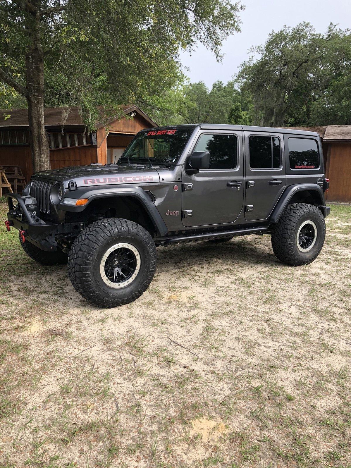

You should look at the rock Krawler kits really nice. I just did a xfactor no limits 2.5” w 37” tires. Marcus at River City Offroad was massively helpful.

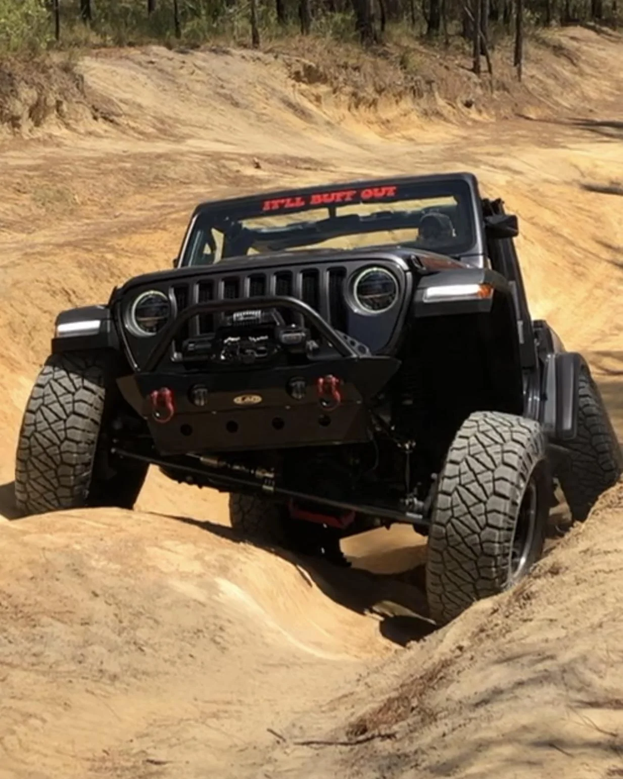

Here's my Clayton 2.5 kit on 38s putting in some work. I agree with @Sheepjeep this kit is built right.

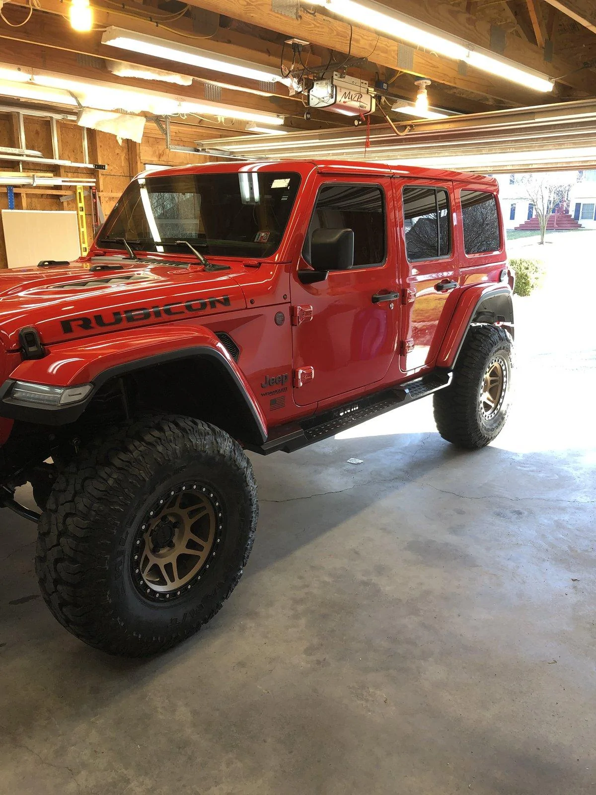

Most lifts will give you more than advertised if you are completely stock because they account for adding heavy skid plates, steel bumpers, a winch, etc. I have the 2.5” lift on my rubicon and I know I got more than 3” of lift from it, but I don’t have a bunch of heavy add ones. I am also running 37’s
Here is my jeep with the metalcloak 2.5” springs.
Jeep Wrangler JL HELP!! NEW GUY :) JL BUILD 7F9EAAEF-0746-41D7-B084-DDB0D67D68CB
