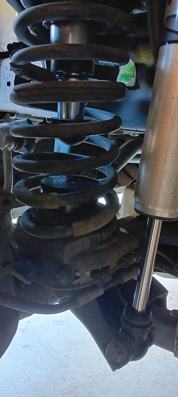

When I put the IRO hydraulic bumpstops in my Jeep, I got 5" of uptravel (3" before making contact, and then two more inches with the bumpstop compression). That was too much. So I added a 1.25" spacer to bring it down to 4". At 4" my shocks are fully compressed.
Jeep Wrangler JL BUILD PLAN, MAX UPTRAVEL HELP 20260426_144335

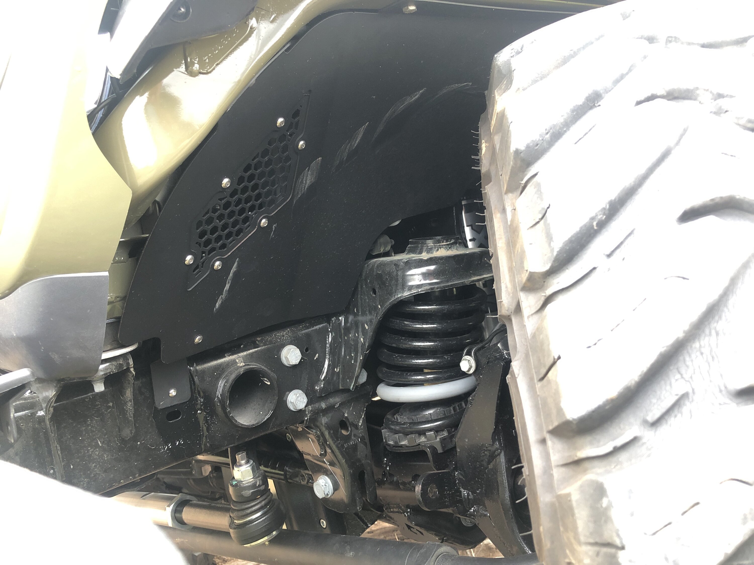

I'll help you out. My Jeep is a Sport with Rubicon axles for what it is worth with the factory non-extended bumpstops.
I am running stock Rubicon springs with the 0-1.5" Fox 2.0 IFP shocks (16.25 compressed/25.85 extended Front, 16.75 compressed/26.85 extended Rear), and the Mopar extended (1/4") front lowers on 35/12.50R17 Toyo M/Ts mounted on stock Sport wheels (17x7.5", +45mm offset).
Additionally, I am running the Motobilt high clearance inner fenders (MB1243 & MB1254) with KBD flares.
I get rubbing on the inner fenders fully flexed out, but it is 100% a wheel offset issue. There isn't much clearance at full bump for more bump travel even if the tire rubbing isn't an issue, so I would not shorten your bumpstops beyond the standard JL length, and I wouldn't go shorter than 16.25" in the front and 16.75" in the rear for compressed lengths on your shocks since that won't be useable travel. My Jeep rides pretty well, but I wouldn't mind some more articulation. I was looking at the short body 12" Bilstein 7100s for the front since they have increased travel with about the same compressed length. I will need more modifications to accommodate additional down travel though both front and rear.
What it looks like stuffing 35" tires:
Jeep Wrangler JL BUILD PLAN, MAX UPTRAVEL HELP position=inline%3B%20filename%3D%22IMG_9606%5B1%5D
Jeep Wrangler JL BUILD PLAN, MAX UPTRAVEL HELP position=inline%3B%20filename%3D%22IMG_9607%5B1%5D
A picture of the rubbing:
Jeep Wrangler JL BUILD PLAN, MAX UPTRAVEL HELP position=inline%3B%20filename%3D%22IMG_9612%5B1%5D
I get rubbing on the inner fenders fully flexed out, but it is 100% a wheel offset issue. There isn't much clearance at full bump for more bump travel even if the tire rubbing isn't an issue, so I would not shorten your bumpstops beyond the standard JL length, and I wouldn't go shorter than 16.25" in the front and 16.75" in the rear for compressed lengths on you shocks since that won't be useable travel. My Jeep rides pretty well, but I wouldn't mind some more articulation. I was looking at the short body 12" Bilstein 7100s for the front since they have increased travel with about the same compressed length. I will need more modifications to accommodate additional down travel though both front and rear.
Thank you sir!!! Great info.
