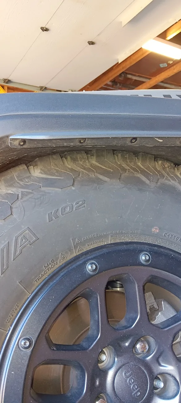

On my 23 XR (with Factory BFG 35" tires) my uptravel is limited by my shocks (Fox 2.0 IFP for a 2 to 3" lift and the front IRO hydraulic bumpstops). It is 4 - 4.5" before the the shocks fully compressed. Remove the shocks and it's like 7" straight up before contact.
With one tire stuffed and the other fully dropped (pic below) it was 4" before contacting the inner fenderwell and fully compressing the shock.
Before you go spending a ton of money on your Jeep, I know you said you didn't want to add a lift, but add a set of Terraflex 0.5" spring spacers front and rear. Its easy to do. It won't affect your alignment, your Jeep will look just a bit better, and it'll give you another half-inch of bumpstop clearance up front. That's what I did way before adding the hydraulic bumpstops.

Cut up the body? What is improper about the XR "lift"?
Your original stated goal was good road driving, no lift, increased uptravel, max 35" tires, and snow and mild off-roading capability.
The XR package comes factory with a 1.5" lift. Add a half-inch spacer and you're at 2 inches lift. Plenty of room for your 35" tires. Add the simple to install IRO hydraulic 2" bumpstops and you'll not only increase uptravel, you'll probably bottom out your shocks before you max out your bumpstop.
