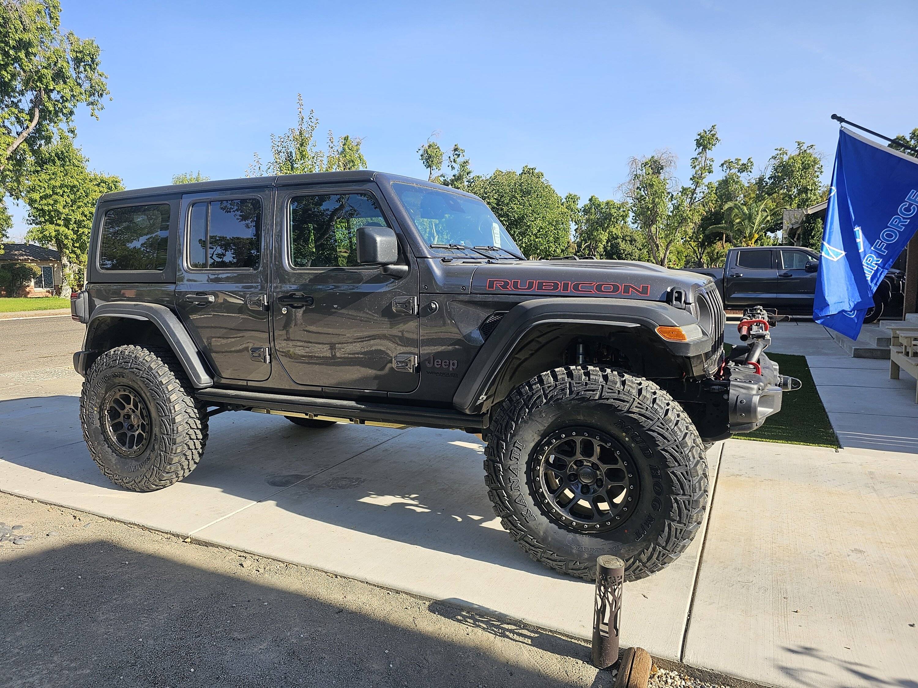

Ran 38s on our 2019 for years and 26 BOH trails. Currently running 39s on our 2022 with stock shafts. Ran John Bull, Holcomb creek, and gold mountain without issues. Ball joints needed upgraded by 28k miles but it's been great so far. I'll upgrade axle shafts if/ when I break one but I like to push the limits personally. I'm not bouncing it or trying to jump it, it's a $65k rig that still looks new from the sliders up and I want to keep it that way. 40s is pushing the limit, but so long as you wheel smart is say go for it.
