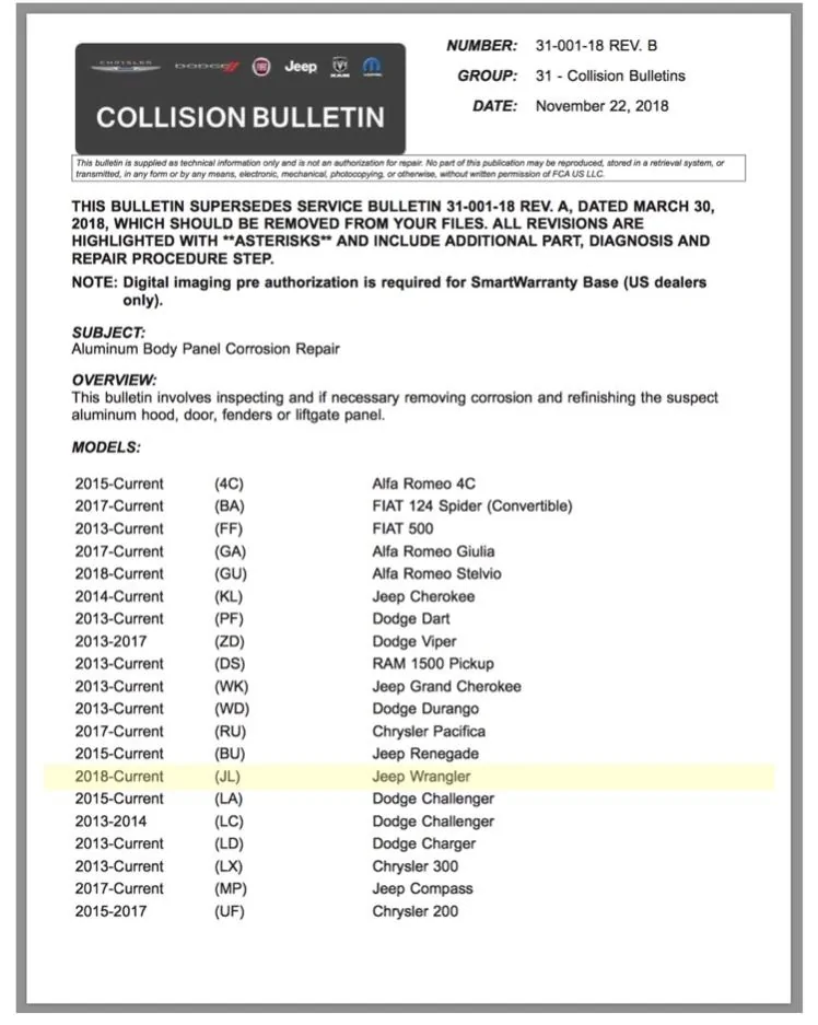

Show them the TSB and Tell them it doesn’t matter if you’ve seen it or not FCA is aware of it (not that they change there production to rectify a known issue) SMH
nonetheless there is a TSB out for it.

Do you have a link for the TSB?
