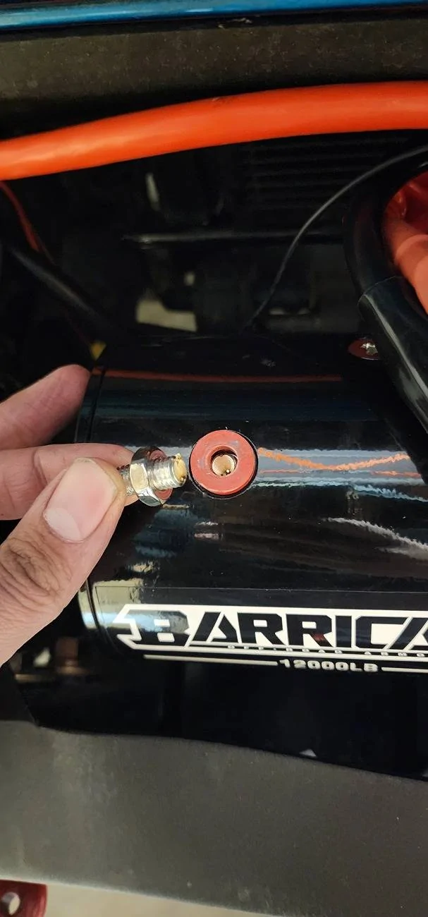

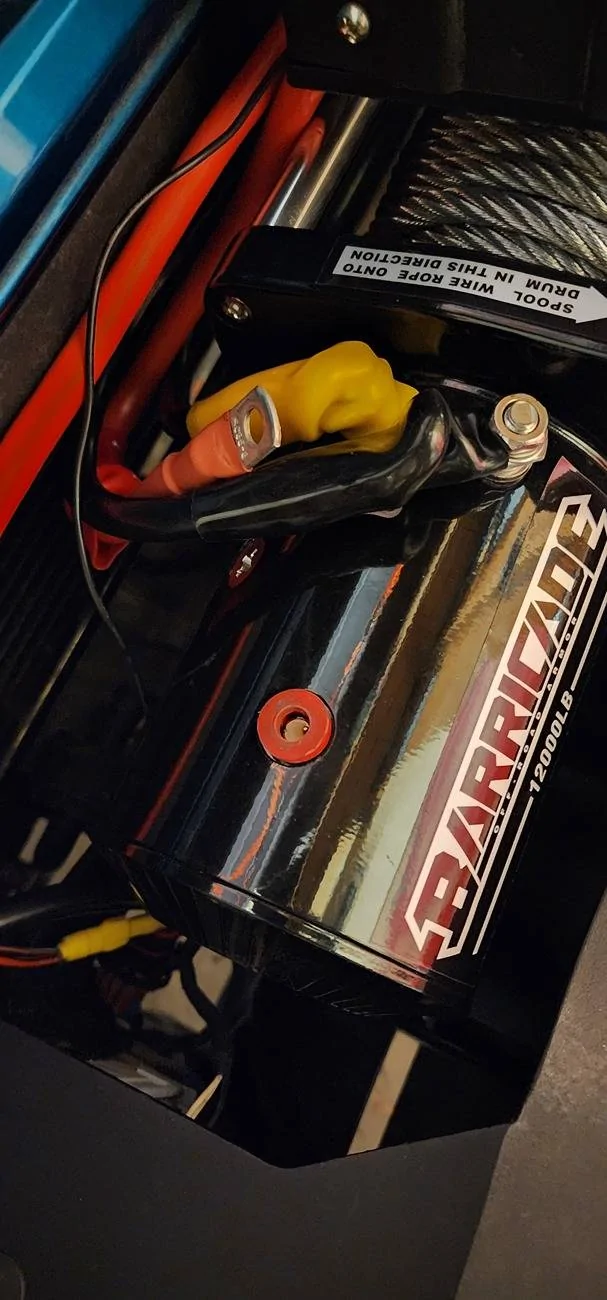

So I picked up a Barricade 12,000lb winch and i was super stoked to have it all installed and ready to hit the trails. The installation was a breeze, basically no hiccups until the very last bolt... I gave the power terminal a little too much elbow grease and i snapped the terminal in half... any recommendations for a quick fix?

There’s no quick fix outside of removing the winch, opening the motor assembly, extracting the broken bolt and replacing the terminal.

take it back, use a torque wrench.

probably not a removable stud, probably a lug mounted to frame.

Maybe have a reputable local shop that rebuilds and repairs starter motors and alternators take a look at it.
