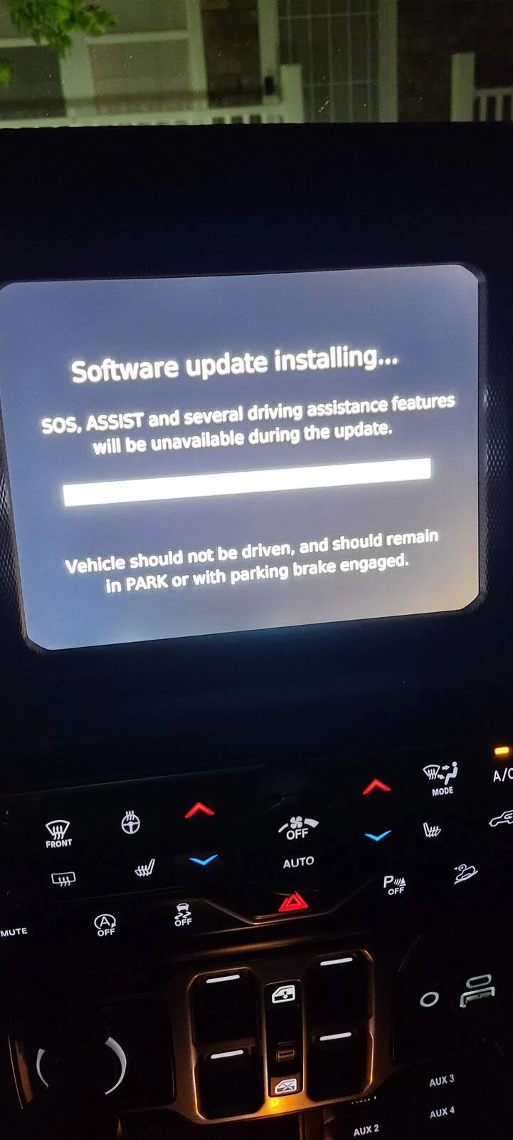

I never got an error or installation progress bar at all. Just frozen on the same screen after initial acceptance to install. Pulled the fuse to the radio to save the battery. If the fuse is placed back, it powers on to the same damn static screen.

Mine is bricked at this screen. Goes to the dealer Wednesday.
This is odd. Typically if the update fails, it'll tell you it failed and give you an error code. This is just straight up frozen.

Yep. Sat over night and never changes.
Short of letting it completely drain the battery, how long have you let it sit for to see if anything happens? And alternatively, have you tried completely killing power across the entire Jeep? Not just yanking the fuse, but disconnecting both batteries for a good 30 minutes and letting both the UConnect and CANBUS reset?

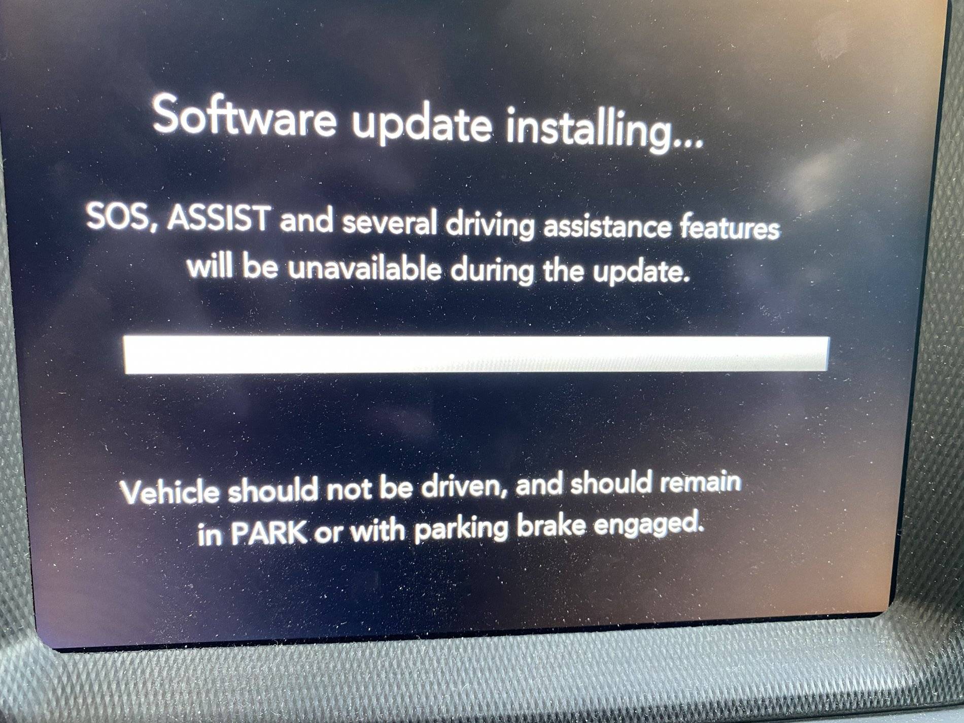

This just happened to me too, it went to update on March 22 after I drove it for the first time in a while, error code 20 stuck on the screen (after being on the white screen for a long time). The screen won't turn off, my battery died, and now that I just replaced both batteries it's stuck like everyone else's. Seems like a screwed up Uconnect update went out and Jeep's fault! I did cancel my SiriusXM Guardian in the middle of this after the error started. Will go try the fuse trick. If Jeep doesn't fix it, then maybe it's time to go aftermarket - but don't want to, I paid for a dang 8.4 screen.

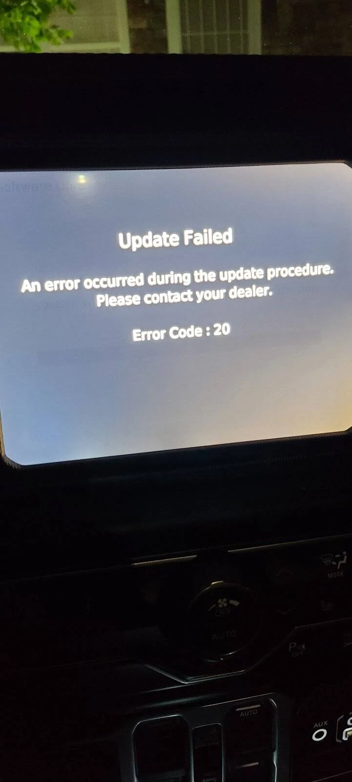

Bought a 2018 JLU Sahara with the 8.4 UConnect
Got home and was promoted to update so I hit yes. Now I'm getting this same error. Tried pulling the F97 fuse but just go back to these 3 screens.
Did you guys get a fix?
The fix for me was a new 8.4 radio. I believe error 20 means the cellular card is out (mentioned somewhere on the board.). Mine lost GPS about an hour before the update so it seemed to be the case for me. Jeep replaced it (4 week wait for a new one here). See if @JeepCares can expedite it.
